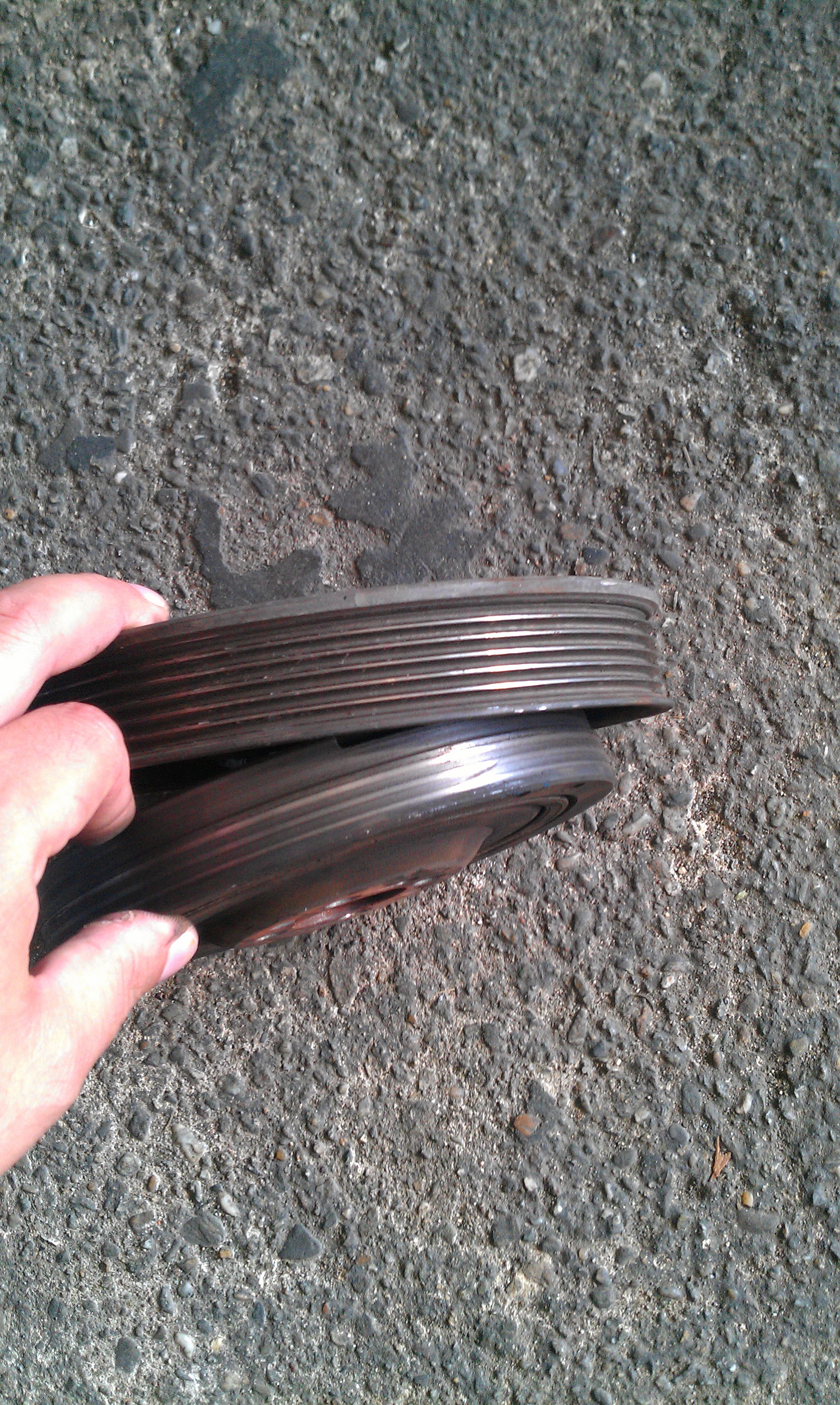

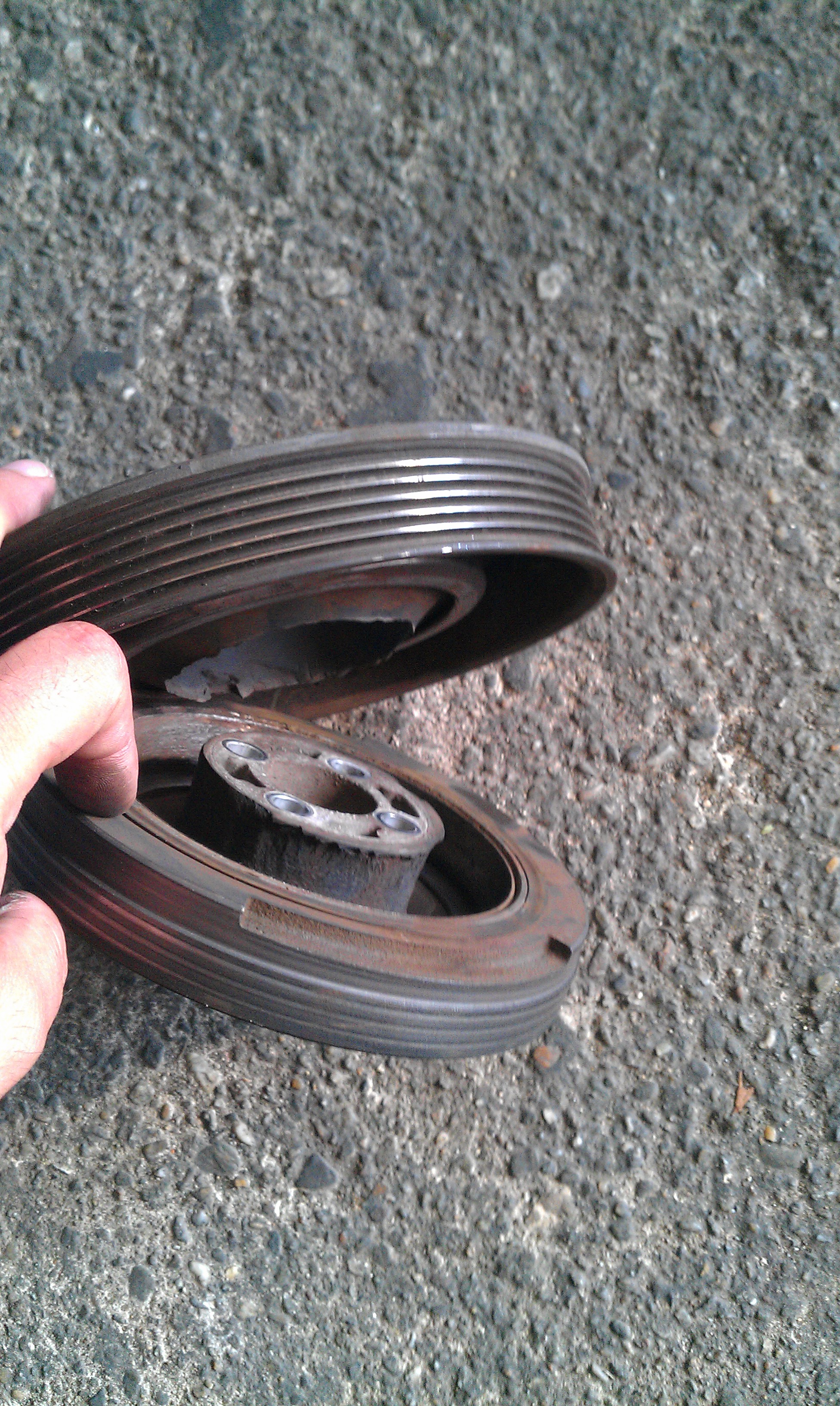

Whilst your doing the cambelt, check for any play on the bottom aux drive belt pulley. They're prone to failure, and seeing as it will have to come off anyway for the cambelt it's worth checking.

Yeah 8v and 16v have almost identical setup. The rubber damper in the pulley gives up and the two can separate. Like you say, only a few mm away from the cambelt!

Indeed. Mine broke while driving, but nothing happened. I've only heard a metal noise and kept going. Lucky for me the outer part of the pulley fell off in the plastic shield and the belt kept running on the inner part of the pulley, as you can see the marks in the photos.
