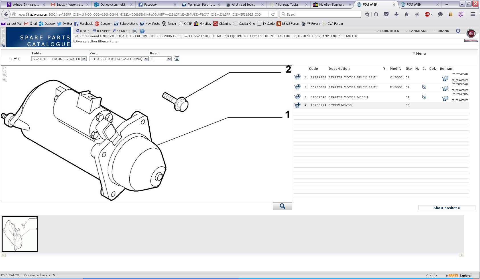

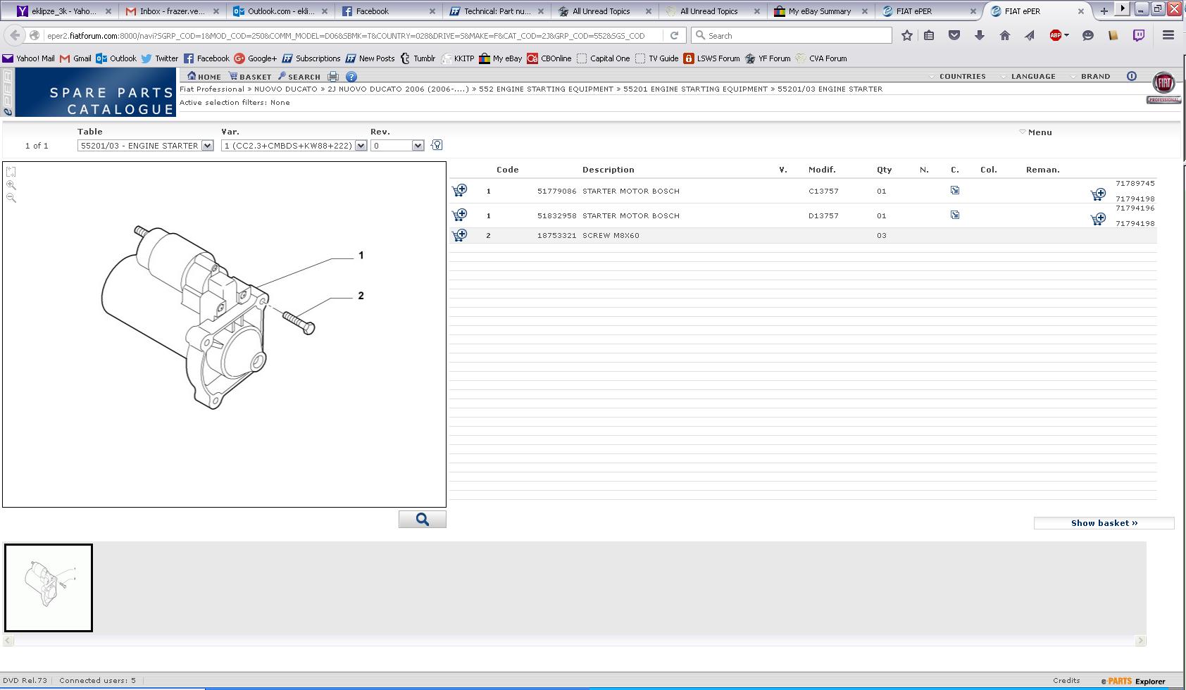

For your year and engine even ePER seems to come up with a few different options
Really not clear on which one's the correct one though, sorry.
thanks for that info, yeah not sure what to go for, just dont wanna waste money buying the wrong part then have to send it back and all that, will need to delve further, cant have the van off the road too long, I am having to keep tapping the solenoid to start it lol
Altho a part I have just looked at did have the delco remy one first picture 2nd down the list
it was using Fiatdalys website but thats where when searching it got confusing and said that that part number and part was not compatible, it was the right vehicle details but that part number is for the JTD
55195967 brings up cheaper versions and most sites including ebay say this is compatible and the ePER2 pictures brought this code up for my van
51832949 which the old ePER brought up, all the sites I have looked at including ebay say its not compatible for my van
so Im guessing best to go with 55195967 as it seems to point to that one and since the one on the van is of no help which has neither of these codes
