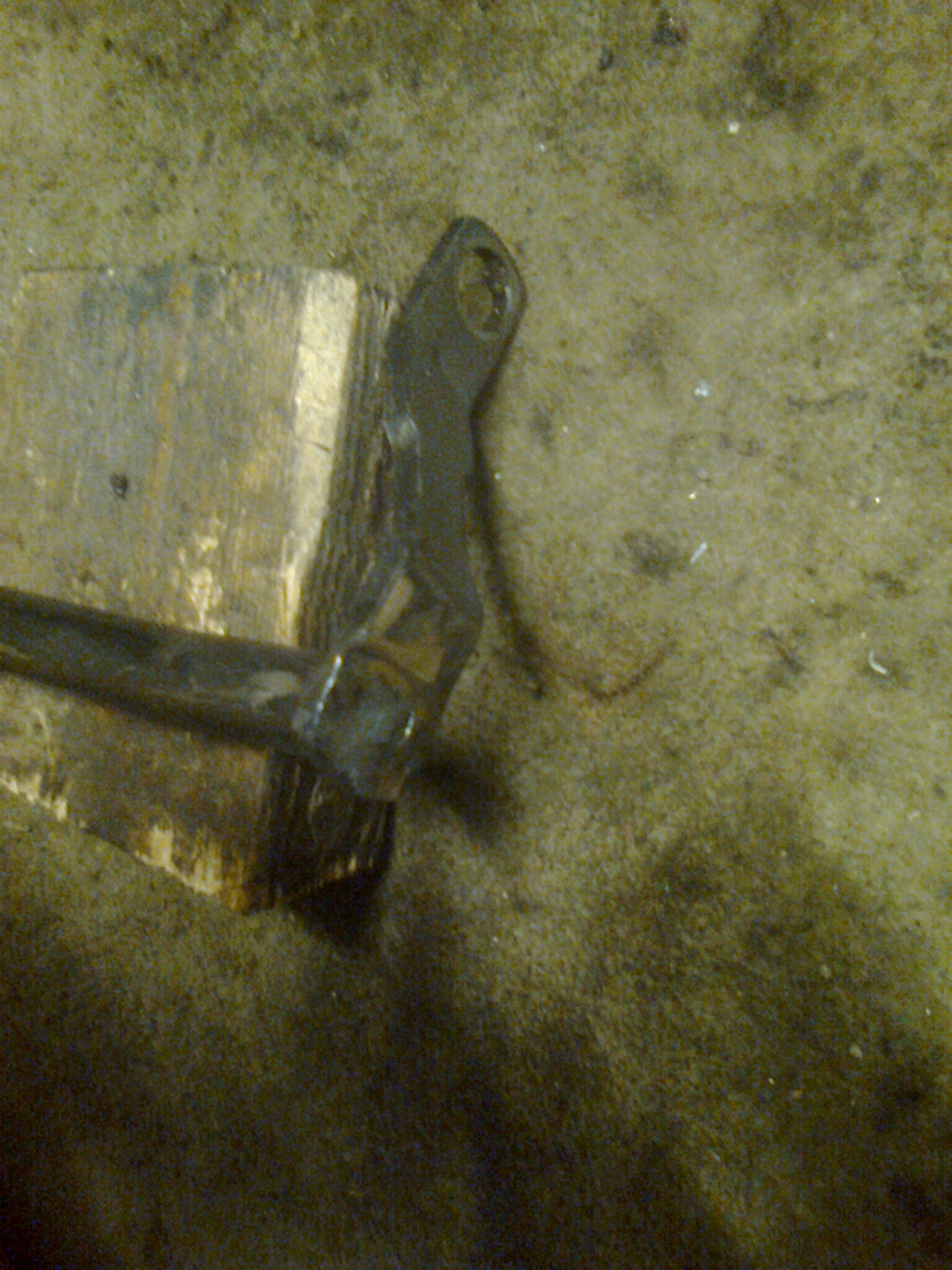

Hacked off the original end taking note of the centre point of the ball joint (for positioning the replacement and welded on the new end:

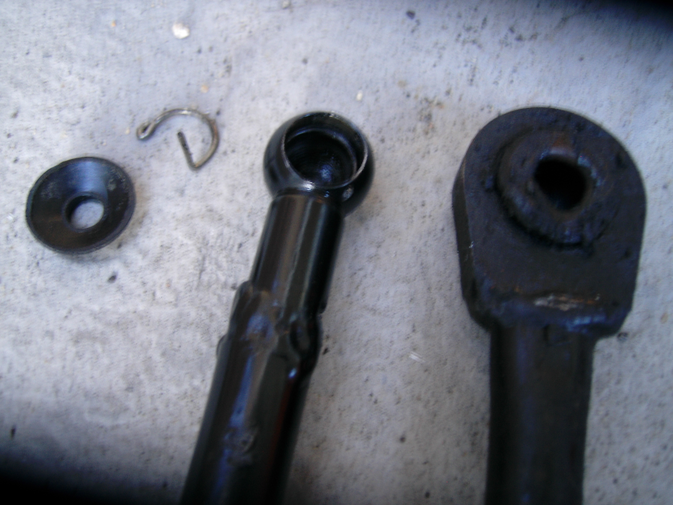

All painted up it looks almost like it was meant to be...best part is the ball joint was pretty much the right size (with a little slop) but this is ok as there is a spring inside which ensures it is held in and a further clip (see left in the picture below) and a rubber protective boot to stop crud getting into the joint as well:
And fitted with lots of grease:
Job done. That's not going to wear out anytime soon I don't think :devil: The grease is held in nicely with the rubber protector boot that comes with the little ball joint.

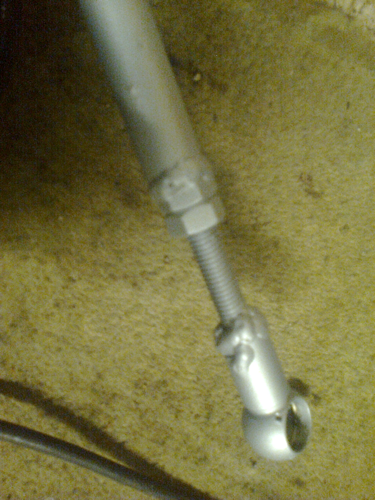

OK, with the engine swapped and a "working" panda I decided to finish off this job and replace all gear linkages / ball joints with metal ball joints for I hope hassle free gear changing for another 28 years :slayer:
Here are the ball joints I used:
http://www.ebay.co.uk/itm/10-PACK-M8x1-25-RH-LINKAGE-BALL-JOINT-ZINC-PLATED-WITH-CLIP-NUT-/140743039544?pt=UK_CarsParts_Vehicles_CarParts_SM&hash=item20c4f05a38
so once again I cut off the bit that holds the plastic rubber ball joint and welded on the metal ones. I even added a tie rod to allow for gear lever position adjustment...
Oddly though I seem to be having trouble uploading photos on FF:confused: I'll wait a bit and try again....stay tuned! haha
Yay we have pictures again! :slayer:
So where was I :D

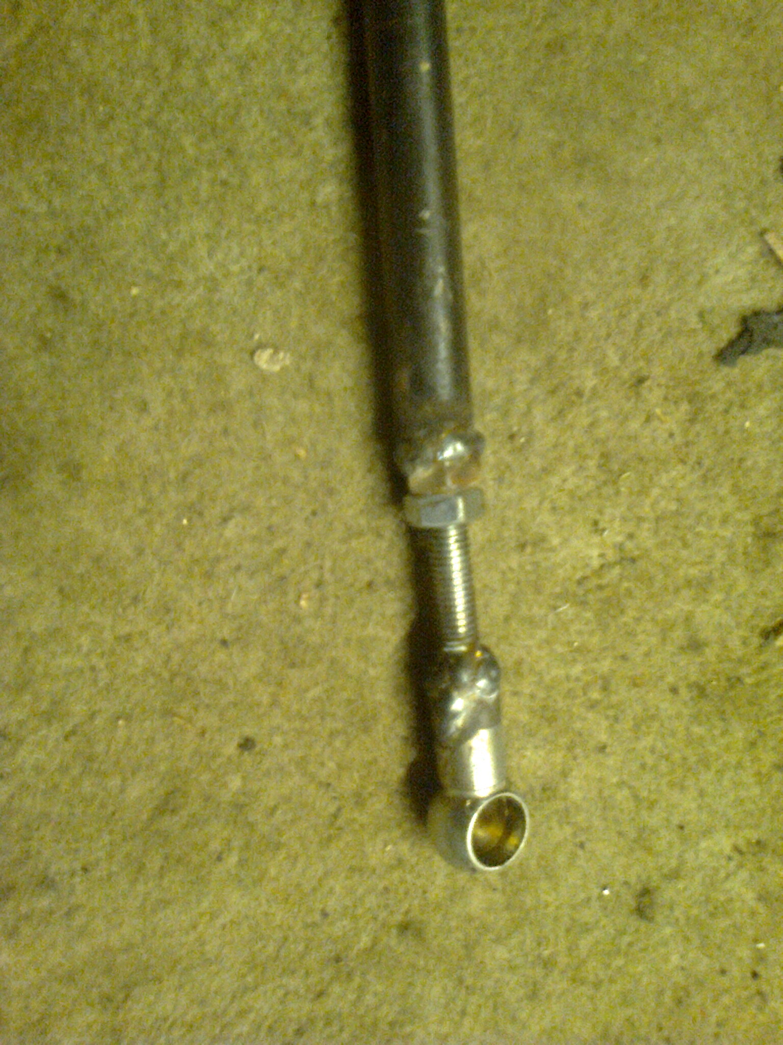

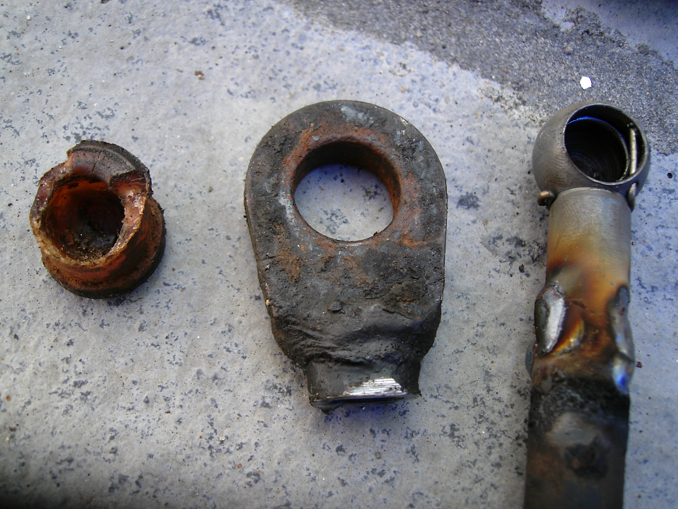

I cut off the old rubber ball joint and end piece and welded a nut onto the linkage. I could then fit the replacement ball joint as a tie rod set-up which will allow me to fully adjust the position of the gear lever:
Bit of zinc primer...

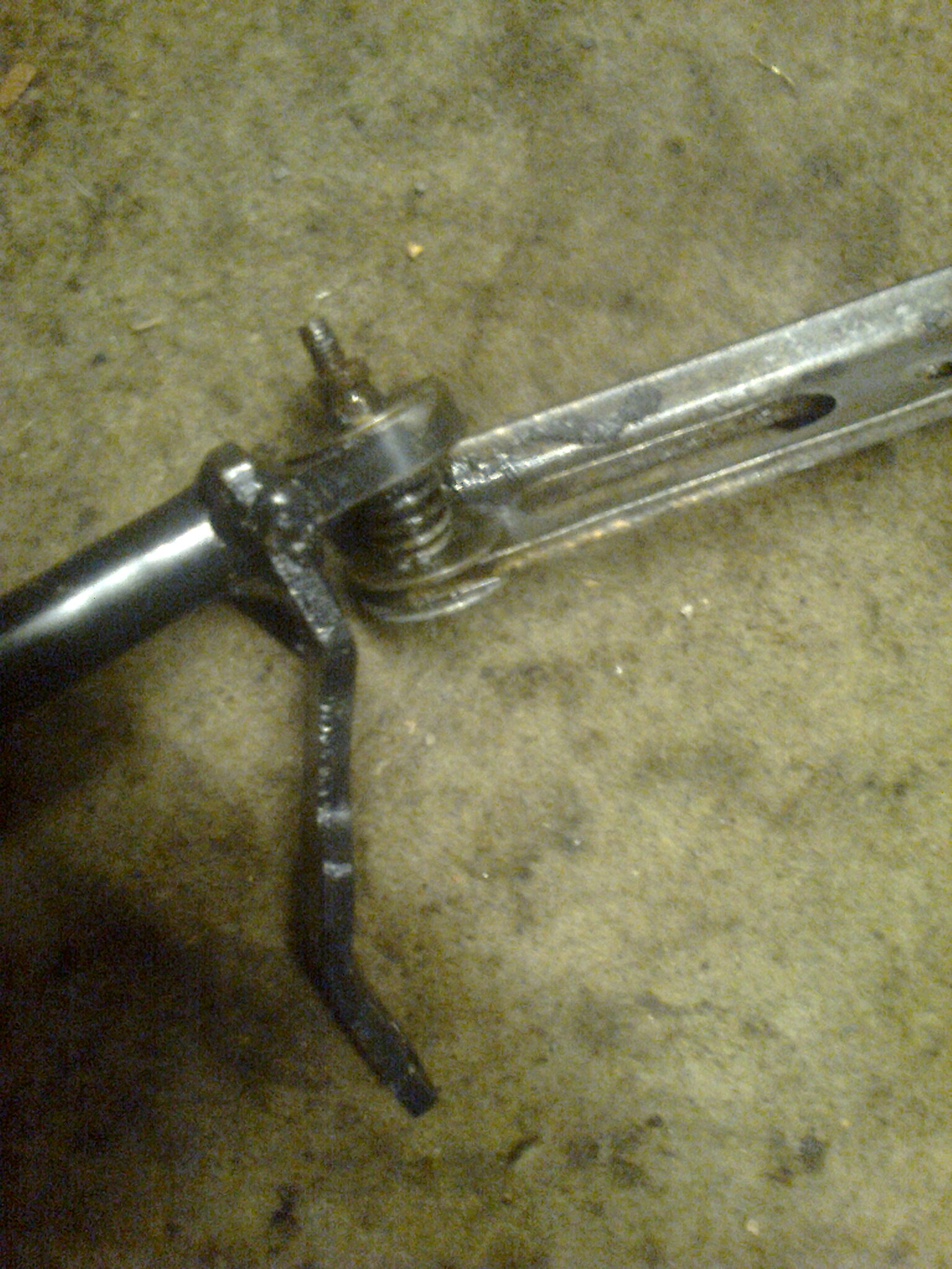

Next up the main gear linkage rod which controls left to right movement of the gear stick. I had a temporary fix which replaced the ball joint with a spring and bolt set-up. This worked to a fashion but not as smooth as a ball joint of course!...
So before...

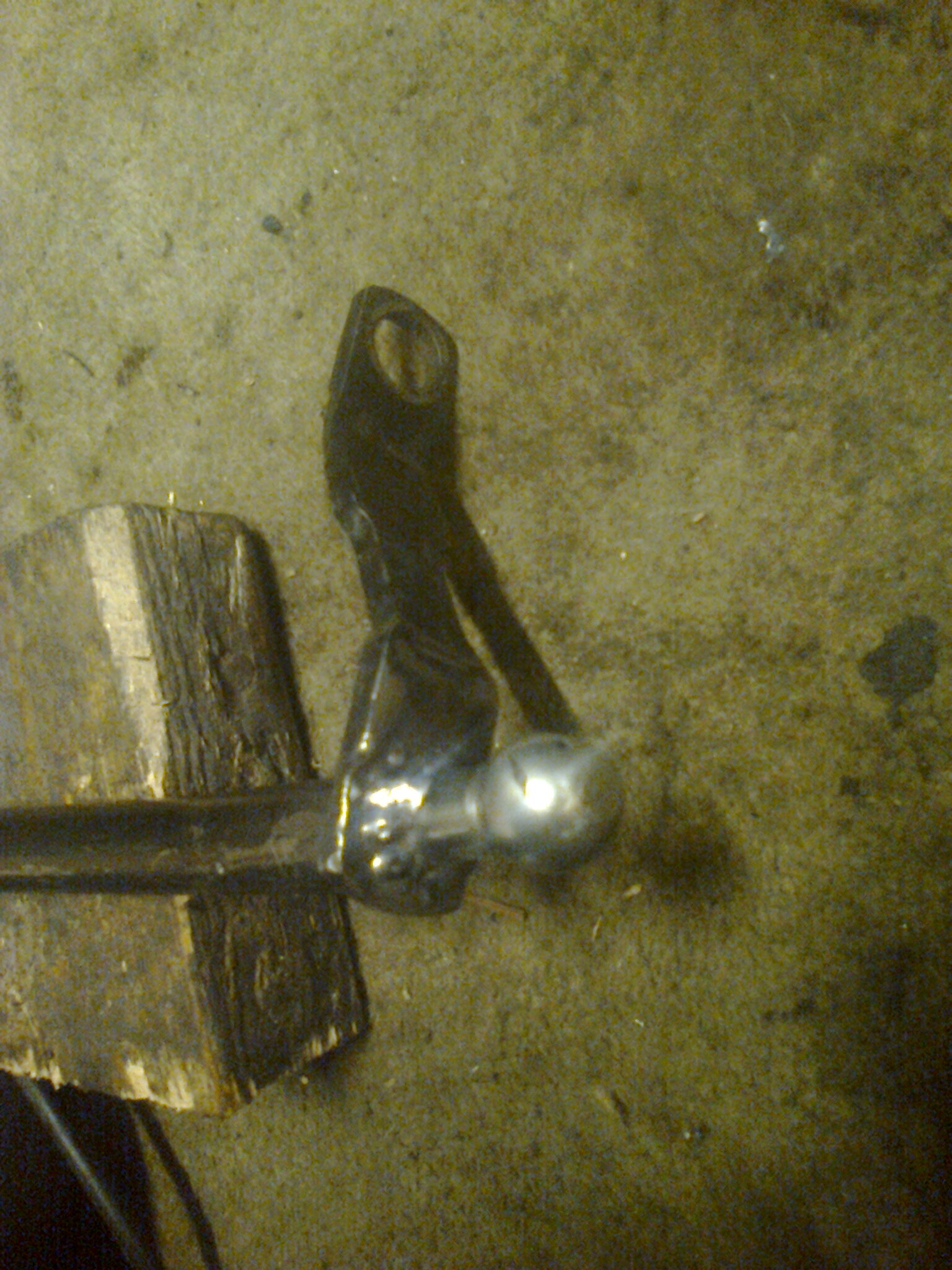

Cutting off the old ball joint fitment was a little depressing / scary...
But welded on the new one and felt a lot better about it :eek: This is the socket bit not the ball of the joint. Just a bad angle on the photo...
Better image showing the socket and all painted up zinc and black...
Then fitted and all working nicely:
No more sloppy gear changes and finding gears is no longer a quest :D
