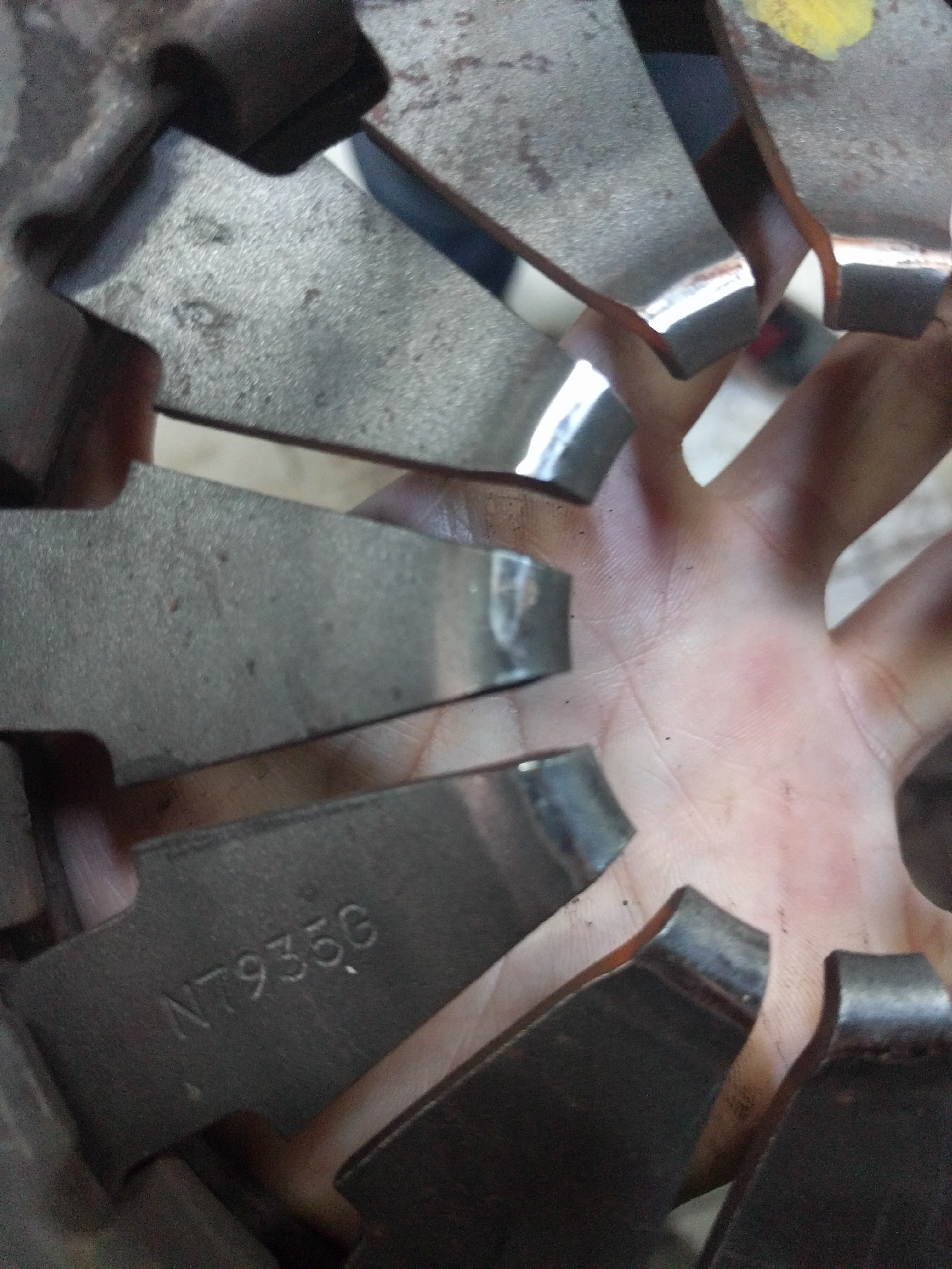

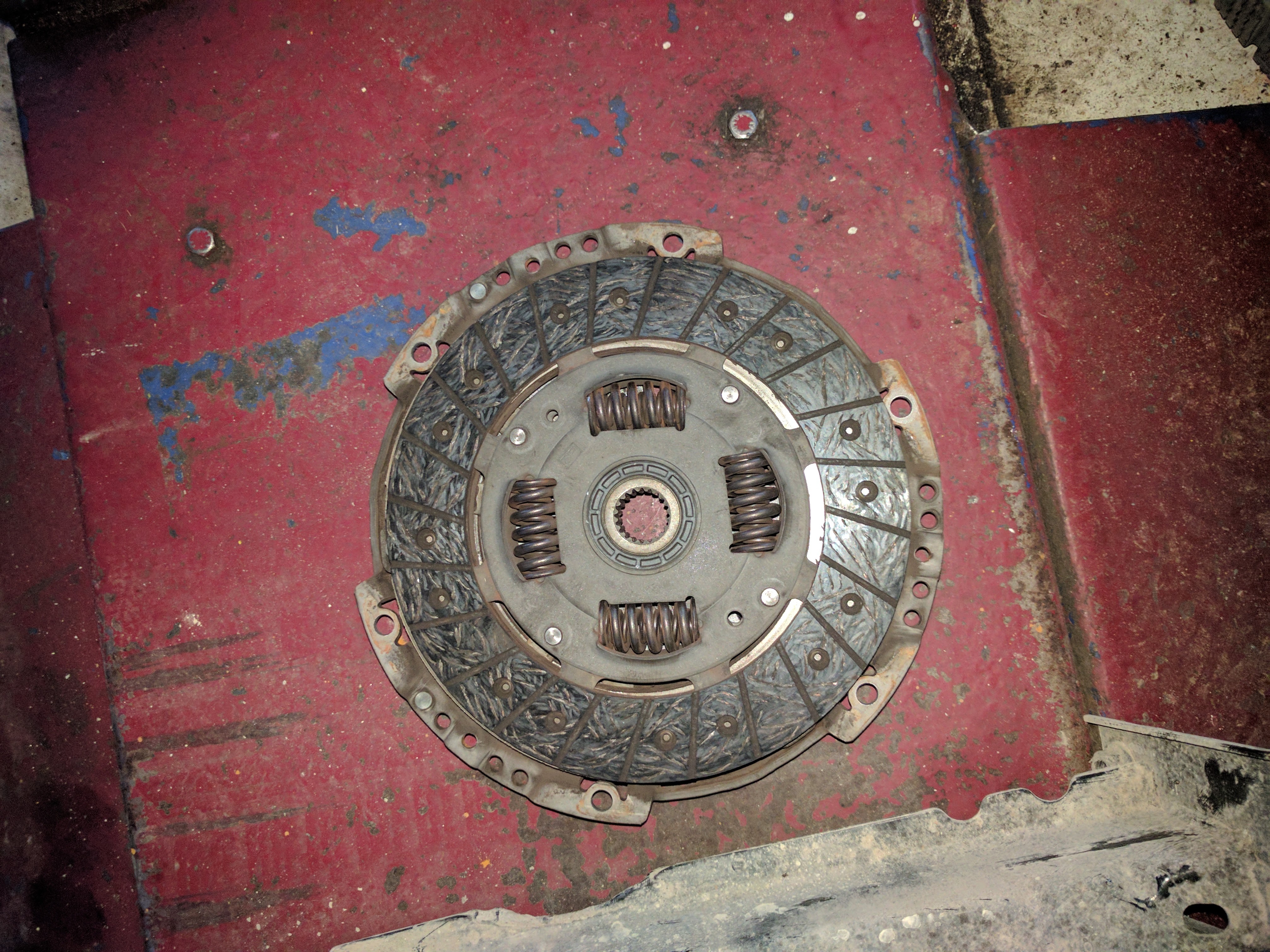

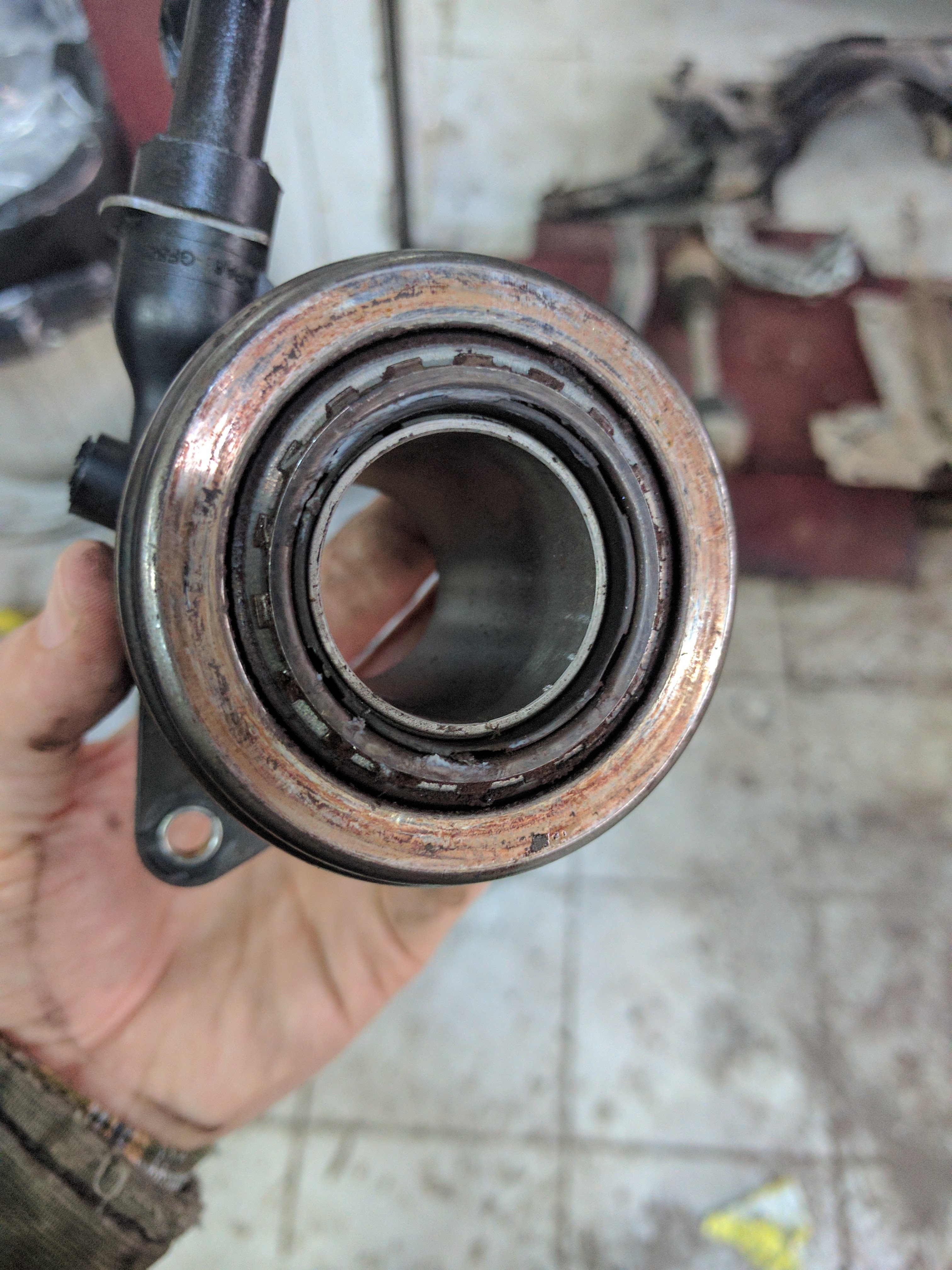

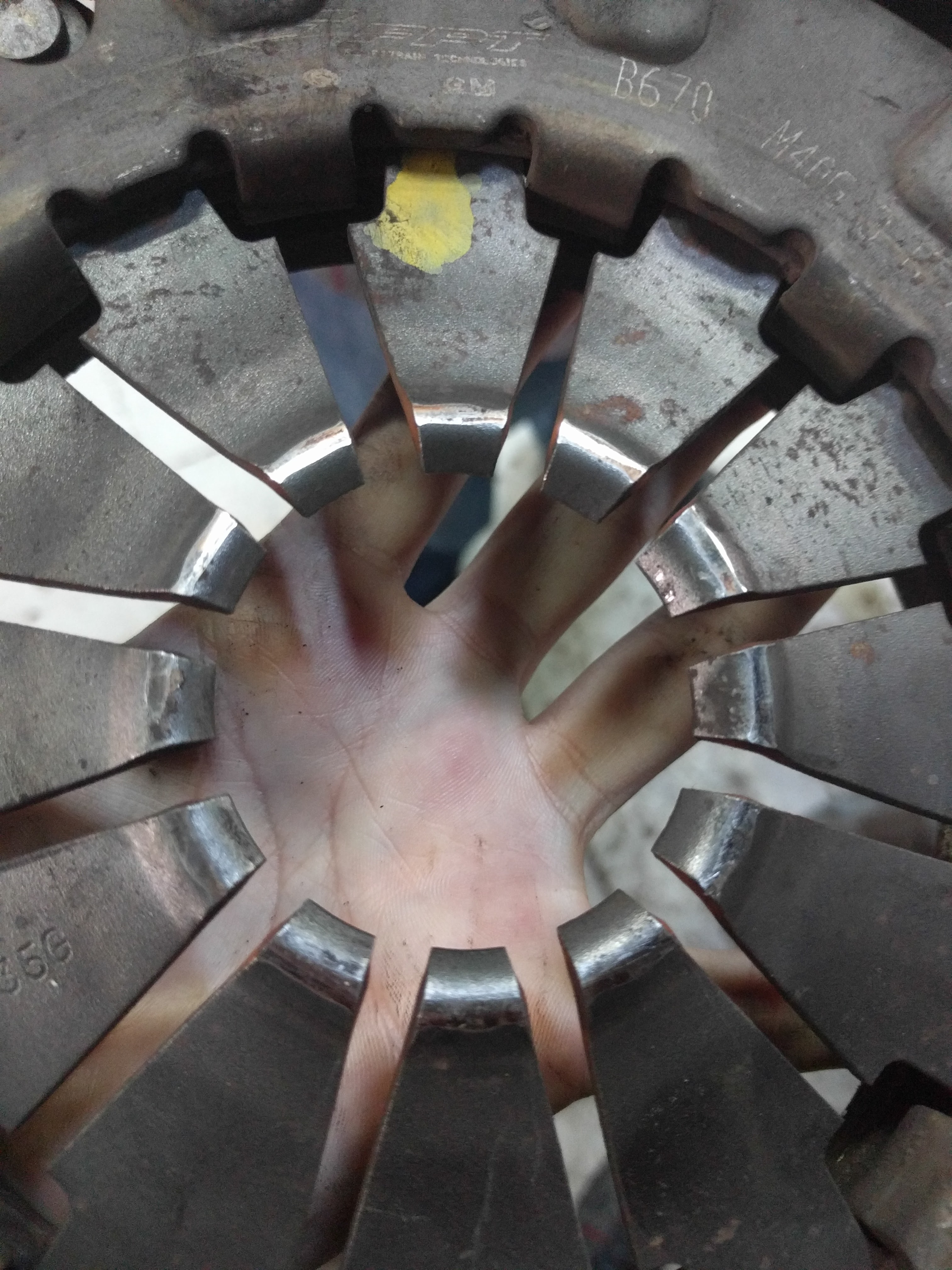

Had a similar issue with my 4x4 (1.3mjt). Due to the way the part is designed, the throwout bearing, clutch actuator lever and slave cylinder are all a single part. Basically, if the bearing fails it ruins everything else, and might damage the pressure plate, clutch, and flywheel in the process. If the slave cylinder fails (as mine did), it wreaks the exact same havoc in a different order. If the pressure plate fails, it kills the bearing and then the rest with it. My car was still under warranty when it happened, but the whole clutch assembly is considered a wear item under the warranty terms, so even if the aforementioned clutch actuator assembly (slave cylinder, bearing etc) is the one that failed, nothing gets replaced under warranty. I got a small (very small, think a few packs of cigarettes small) discount as a gesture of good will, and have decided that if it happens again I'm spending the money on a sintered bronze clutch, slave cylinder-fork-bearing-plate assembly from a Qubo Trekking, which are identical but 2/3 the price.
Here are pictures of the incident. The lines going into the bearing are the slave cylinder hydraulic lines. The markings on the pressure plate are where the plate and bearing mashed together. The clutch is, well, the clutch which has a surprising amount of friction material left but may need to be milled as it became unevenly worn when the failure occurred. Lastly, the black goop sitting at the bottom of the housing in front of the flywheel is charred up contact surface and bearing grease left gunked up in between the clutch and flywheel.
