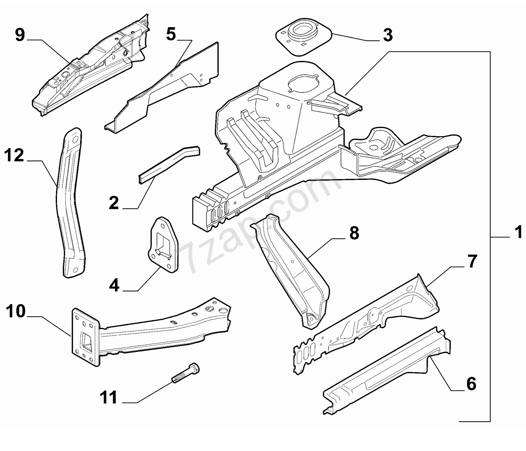

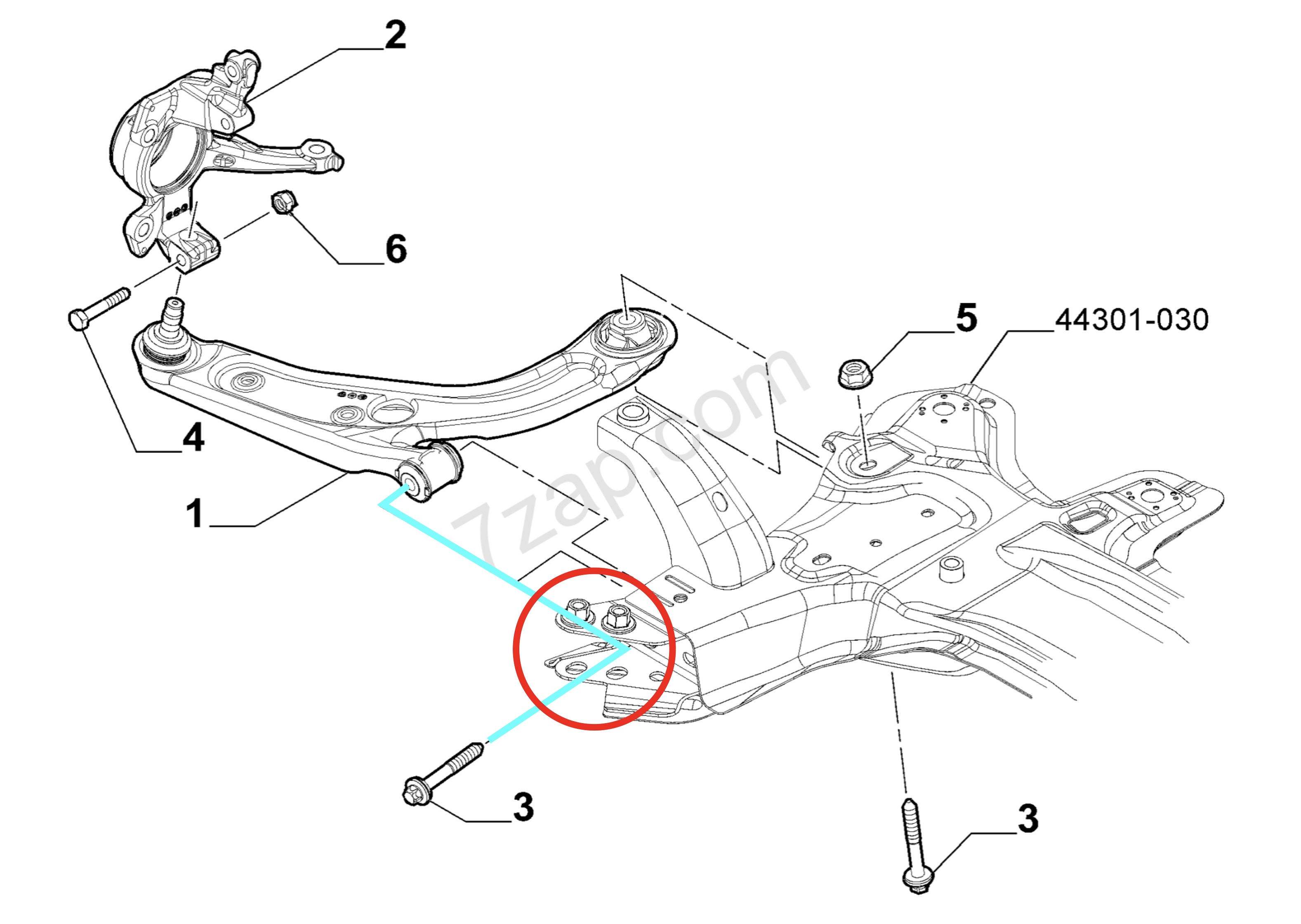

I’ll try and put a parts picture later [edit - see second reply below] , but in text only for now: to reach the front bolt, you need to remove the front, forward-facing ‘leg’ of the subframe. This is secured to the rest of the frame by two bolts underneath. The front end of that ‘leg’ connects to the cross beam behind the front bumper. Having removed this leg, the bolt securing the wishbone front pivot is accessed from the now open end of the subframe. So, yes, the under tray has to come off, and a fair bit more besides. Somewhere there is I think a previous post about this, with photos. The ‘search this forum’ search might find it. (Identical part and process on standard Panda, 4x4 and Cross model, by the way)
mikerf See if this helps (see the previous reply too which explains this). The red circle is around the location of the two bolts (removed in the diagram) that secure the front 'leg' of the subframe. One the 'leg' is removed, the bolt numbered '3' (towards the lower left of the diagram) is the one you need to remove -- the blue line shows that this passes through the front pivot of the wishbone, but is shown here as an exploded view. (In the second diagram below, the part numbered 10 is the front subframe leg – there is one on each side of the car but only one is shown here. The square plate on the front of this part is bolted to the cross beam behind the bumper, and the securing bolts mentioned above pass through the two round holes at the lower/right end of this part)

Hillhopper. Thank you so much for all that info. The pics clearly show the process. I had a good look underneath yesterday and can clearly see the parts you mention. The forward crossmember on the Cross also has the red tow hooks bolted to the front just for added inconvenience. It's pretty obvious the front bumper also has to come off first. Why do manufacturers make easy jobs so difficult? I though changing the rear disks on the Cross was a stupidly difficult job but all this work just to change a wishbone is just mental.
