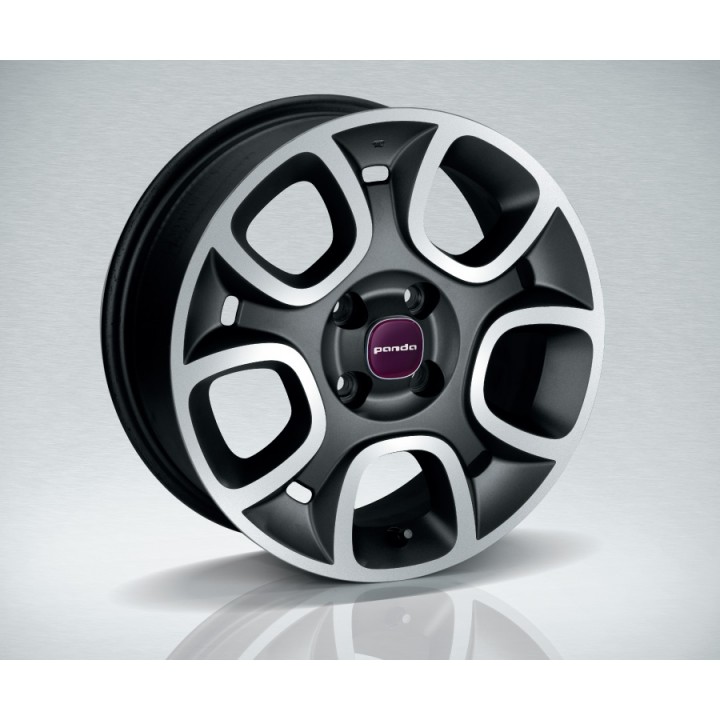

Anyone got a pic of these factory option alloys on a silver 1.2 or TA Panda?
Thinking of buying a set but like to see what they look like on a car like mine first. I have googled but there don't seem to be any silver cars out there with these on.

They're quite similar to the factory bicolour alloys I have on my 500, the car is metallic grey and they look really well so I'd imagine they'd suit the panda too
These diamond cut wheels were standard on the special edition, "Antarctica" that celebrated 30 years of Panda 4x4's.
The Antarctica's only came in white with a black roof, tinted rear windows, orange mirror caps and wheel centres and penguins!
http://www.fiat.co.uk/fiat-panda-4x4-antarctica
They look good and I think due to the dark paint will look fine on a silver car.
One problem is they aren't easy to refurbish when the time comes (and it will come, they are fairly soft alloy and the rim chips easily)
It's not a quick strip, fill and repaint!
And, if you live in a climate where they salt the roads in winter, they'll corrode, however meticulously you try to maintain them.
I'd never leave any kind of diamond cut wheel on a car in daily use in the UK between October and March.
But that's a good excuse to go buy some winter wheels & tyres.
I like it - looks very coordinated, like someone actually thought about the design of the whole. The curves in the wheels complement the shape of the Panda perfectly.
I much prefer this to black wheels (which to me look like a hire car on steelies when someone's removed the trims), but taste is a personal thing.

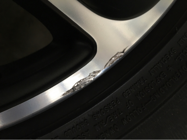

So I did this to one of my bicolour alloys recently, brought it to a wheel refurb place and they said they'd have to diamond cut the whole face to sort it and it would be as new when done, cost 125Euro! Does that sound like a correct solution, ie, it can't be filled etc?
It all depends on how deep the damage is, if it's deep it'll need filling with alloy (welded).
It's stripped, repaired (if needed) and painted.
The paint is usually electrostatically applied (powder coat) as it's fair hardier than wet painting and it's baked (probably several coats/bakes are needed).
Now the paint is cut back to alloy with a diamond coated cutting tool.

Thanks, so what they're recommending sounds correct then?

If that's all the damage there is, all the existing paint is sound, and it doesn't need filling with weld material, then I don't see why they'd need to repaint the wheel - they could just diamond cut the face back to sound metal & relacquer.
OTOH, if they do need to weld any metal in, then the heat of the welding will likely damage the paint & they'll need to powder coat & bake the whole wheel before cutting back. Getting the paint to perfectly match the remaining wheels is part of the skill, and is one the differences between an OK job and a top quality one. Much easier of course if you're refurbishing all 4.
Either way, they might need to put the wheel in an oven at the end to cure the lacquer.
Getting lacquer to adhere properly to bare alloy is challenging; any defect in the coating and the winter salt will soon get underneath the clearcoat & ruin the finish. However carefully it's done, they're unlikely to stay pristine for the life of the car in the UK climate.

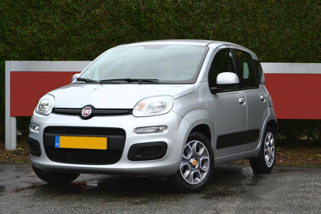

Made a quick photoshop. ;)
Thanks TP! They look good, but I am not completely swayed by them. I think the Mopar option wheels are a darker grey than that and polished highlights are brighter?
