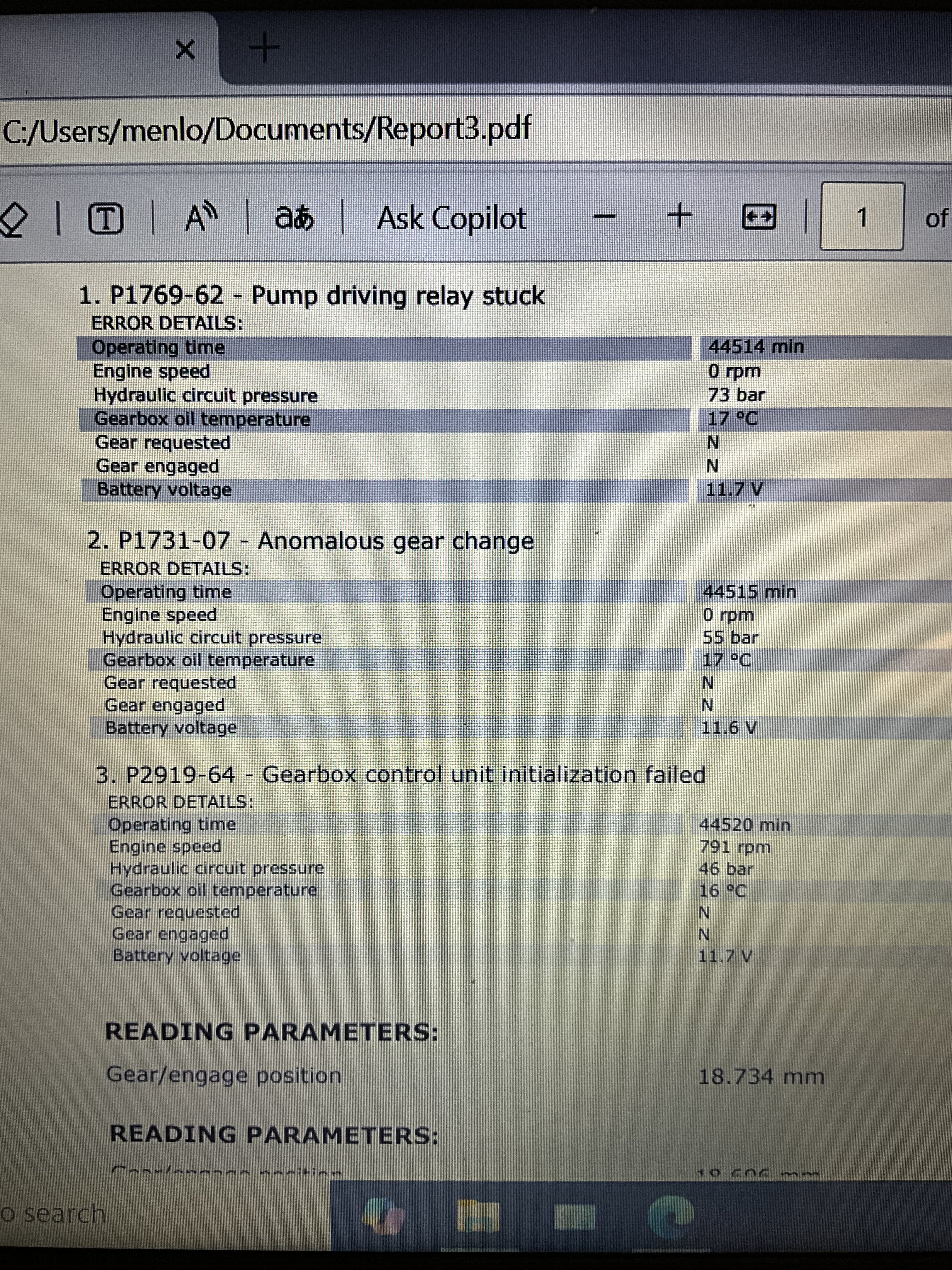

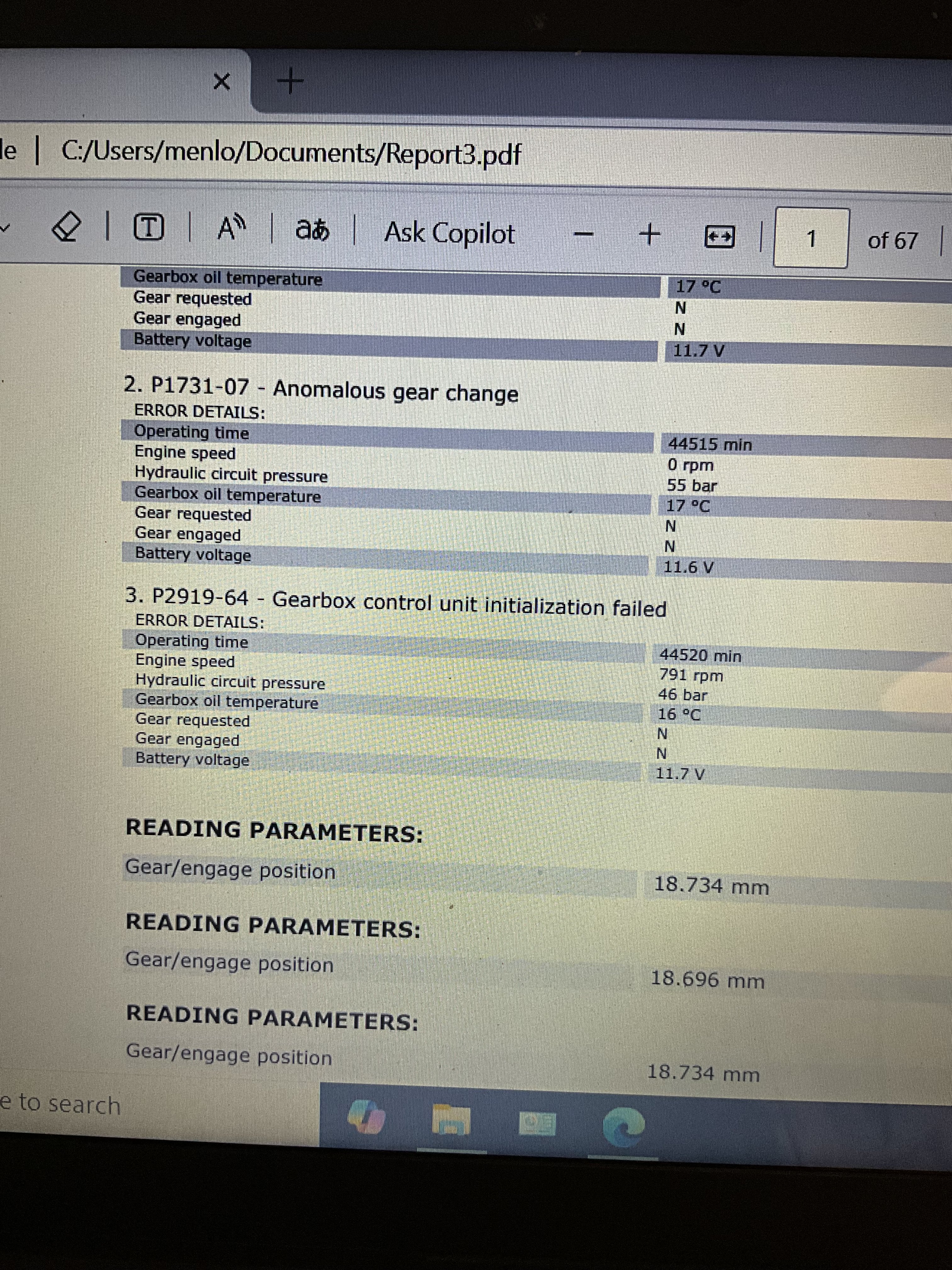

Well after driving my 2019 Fiat Ducato 2.3 Automatica fine for 4 weeks except Glow plug error
suddenly dreaded red code and no gears available.
Managed to drive 3 miles home after my gearbox made an awful crunching noise then couldn’t start again so my friend gently pushed the backend in so it wasn’t sticking out as I totally lost gears.
Finally got my own MES and got 3 new errors - baffled as no warning or crunching beforehand .
Vehicle will not go into gears except 1st as it pops to Auto N when engine starts
Anyone recommend a good garage for repair north London- I noticed someone went to planet gears in Peterborough.
I had a full Fiat service including auto transmission fluids a year ago
Thanks

I would check and change the relay for the pump.

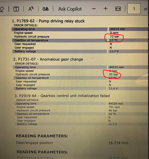

So would I as a first step. The report shows extreme pressure values, as if the pump hadn't stopped when it should (and if so, a very unhealthy situation for the pump motor and the pressure accumulator)

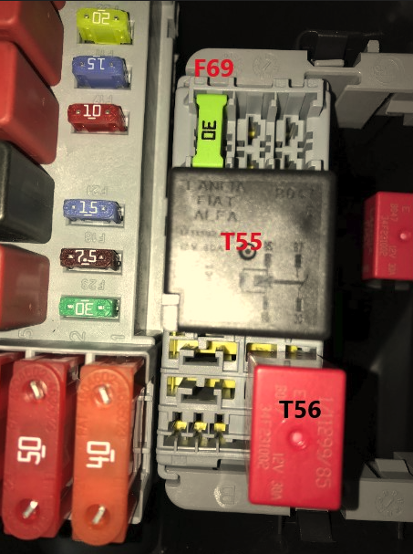

The picture below shows the relay location (T55) behind left headlight in my 2018 (left hand drive)

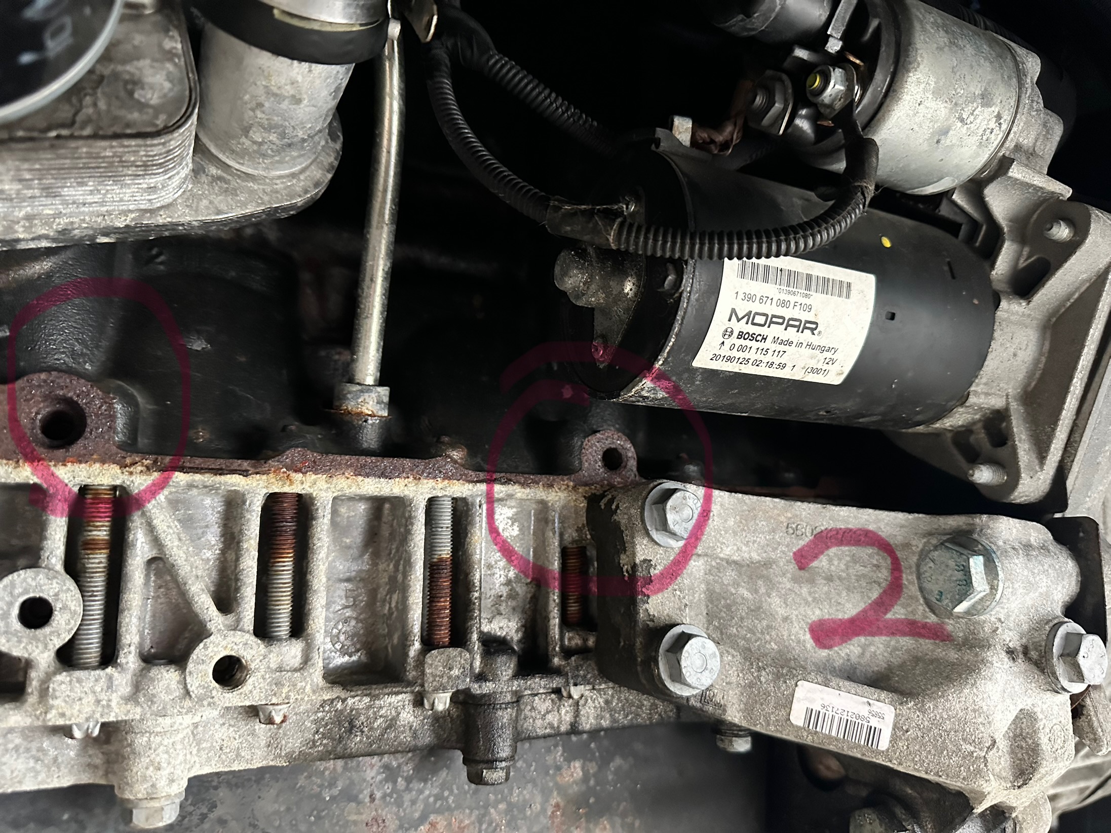

Thanks for the advice. I called AA and they found some oil by the gearbox when checking the earth cable underneath - looks quite rusty too.
It’s on a low loader for Fiat to look at😭😭
