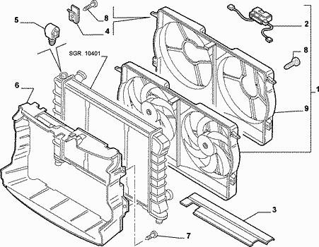

I think this is the radiator cooling fans relays. On my 2.4 its behind the top of the front radiator, mine filled up with water, internal corrosion, took 3 weeks to get from Italy, £150, a Valeo part but not listed. Only 35 2.4 cromas sold in UK.
It turned on the radiator fan when parked and flattened the battery.
Could have been caused by pressure washing through the radiator.
Keith

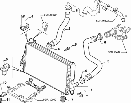

Thanks for this info, but i don't understand where to find this relay ?
is it on the part 1 ?
or on the radiator : ?
( the schema is almost the for 1.9 150 and 2.4 200 )
