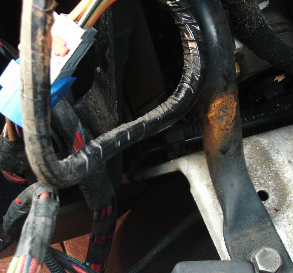

Does 3. include connecion between ECU and relay T07? There is a possibility for wiring damage below LH headlamp. See photo which was originally posted by @Reg 65 .

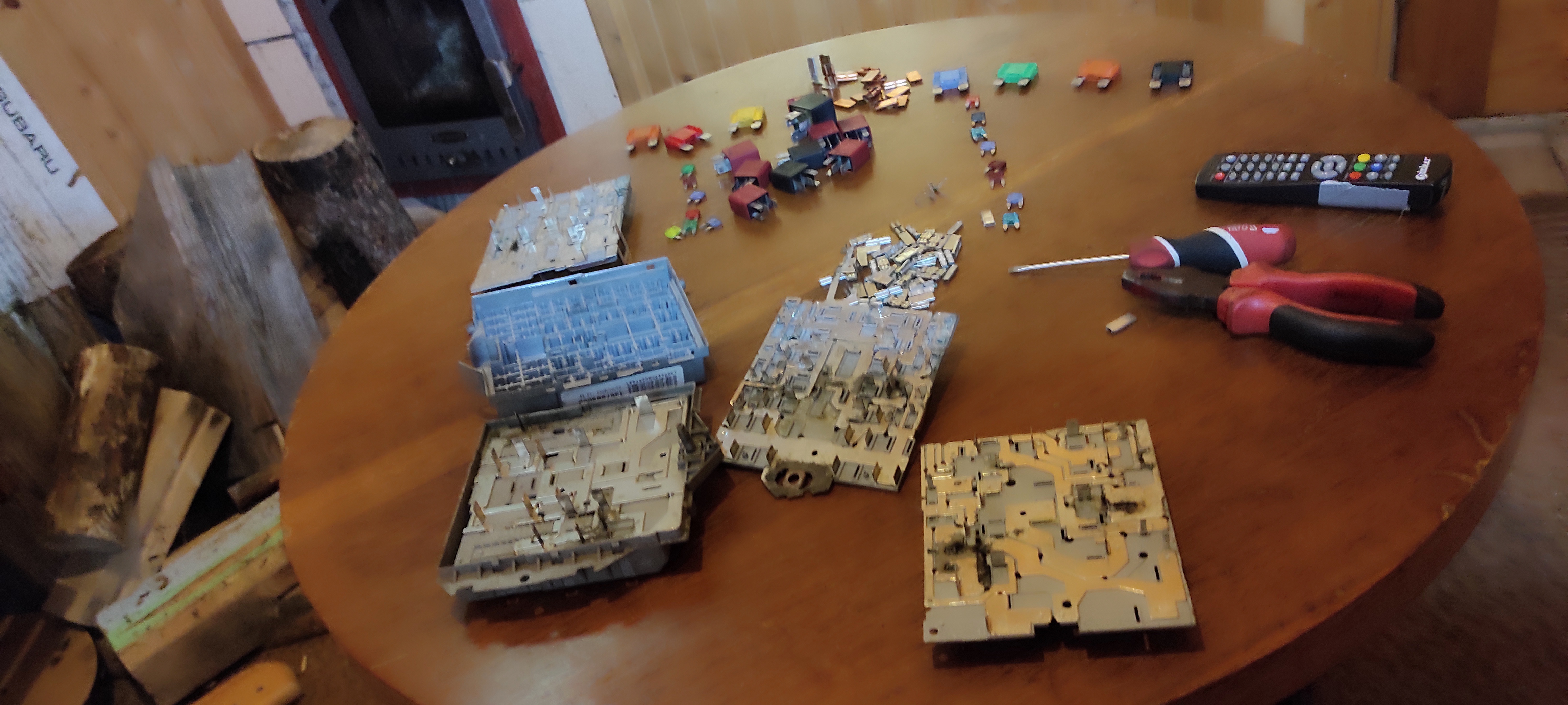

Done!!!!! To relay T07 there was comming only 10v instead of 12v. There wasnt enought to make relay work!!! Reasembel fuse box, cleaned contacts with sandpaper and here it is. Its working. No threads with this solution
To be real, to rrelay leg 30 there was comming 12v, but to leg 86 only 10v. Bouth legs are on the same mettal plate. So first two times when i dissasembeled fuse box, there was no feeling that it can be like that. So here you are!!!! 7 days of searching and working!!!!
