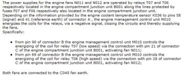

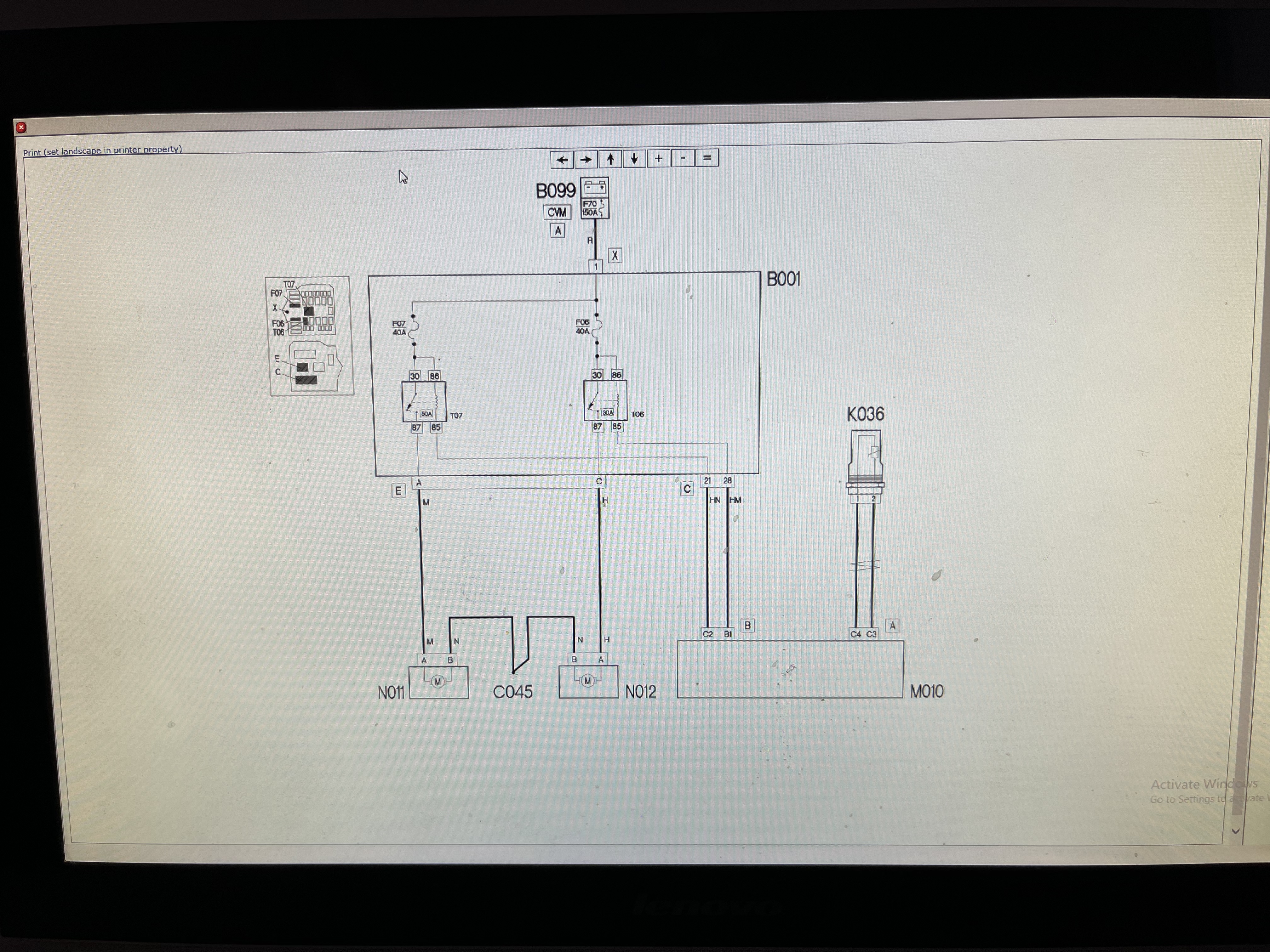

If you have no air conditioning, Fan 1 is controlled by Relay T07 and Fan 2 by Relay T06. The relay coils are grounded by the Engine Control Unit (ECU) to turn each fan on, depending on the temperature sensor output. The Relays and Fuses are in the Engine compartment.

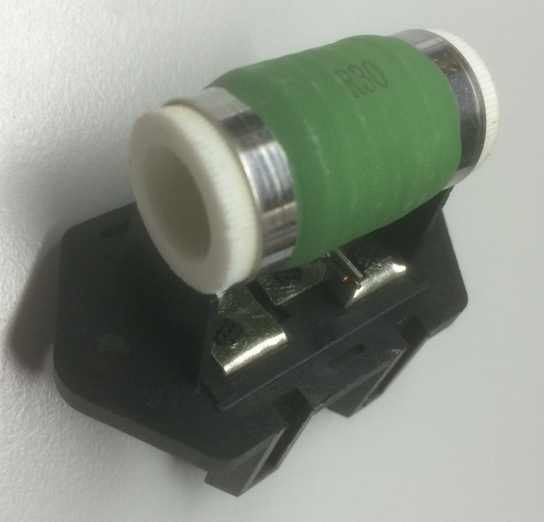

If you have air conditioning, there is also a low-speed setting for Fan 1. The low speed occurs when a high-power ballast resistor is in circuit. Relay J028 shorts out this resistor when high-speed is needed. The coil of J028 is also driven by the ECU. I believe this resistor and relay are mounted near the radiator. If the resistor goes open-circuit you will lose the low-speed mode of Fan1

If you have no action at all from Fan1, check out Relay T07. You could try swapping over Relay T07 and Relay T06, to see if the problem moves to Fan 2.

Are you should i have that resistor coil? i will take a look :)

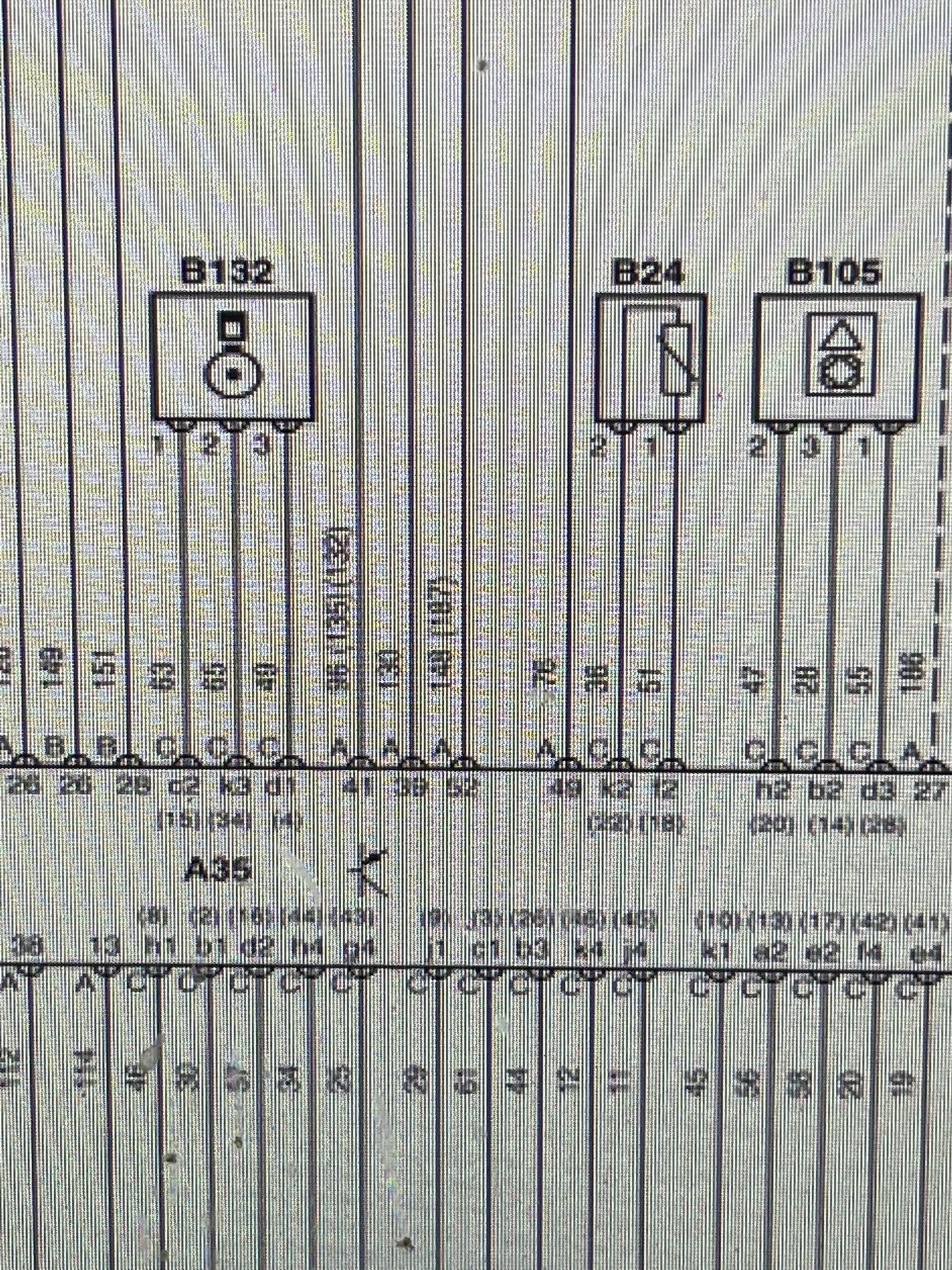

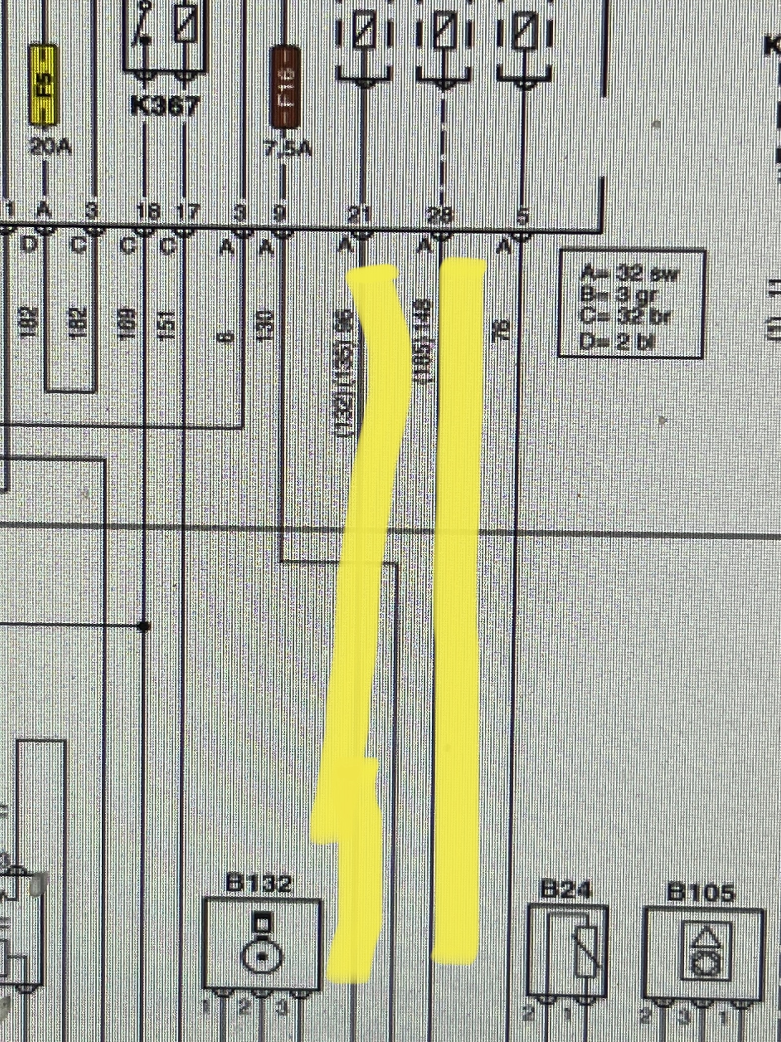

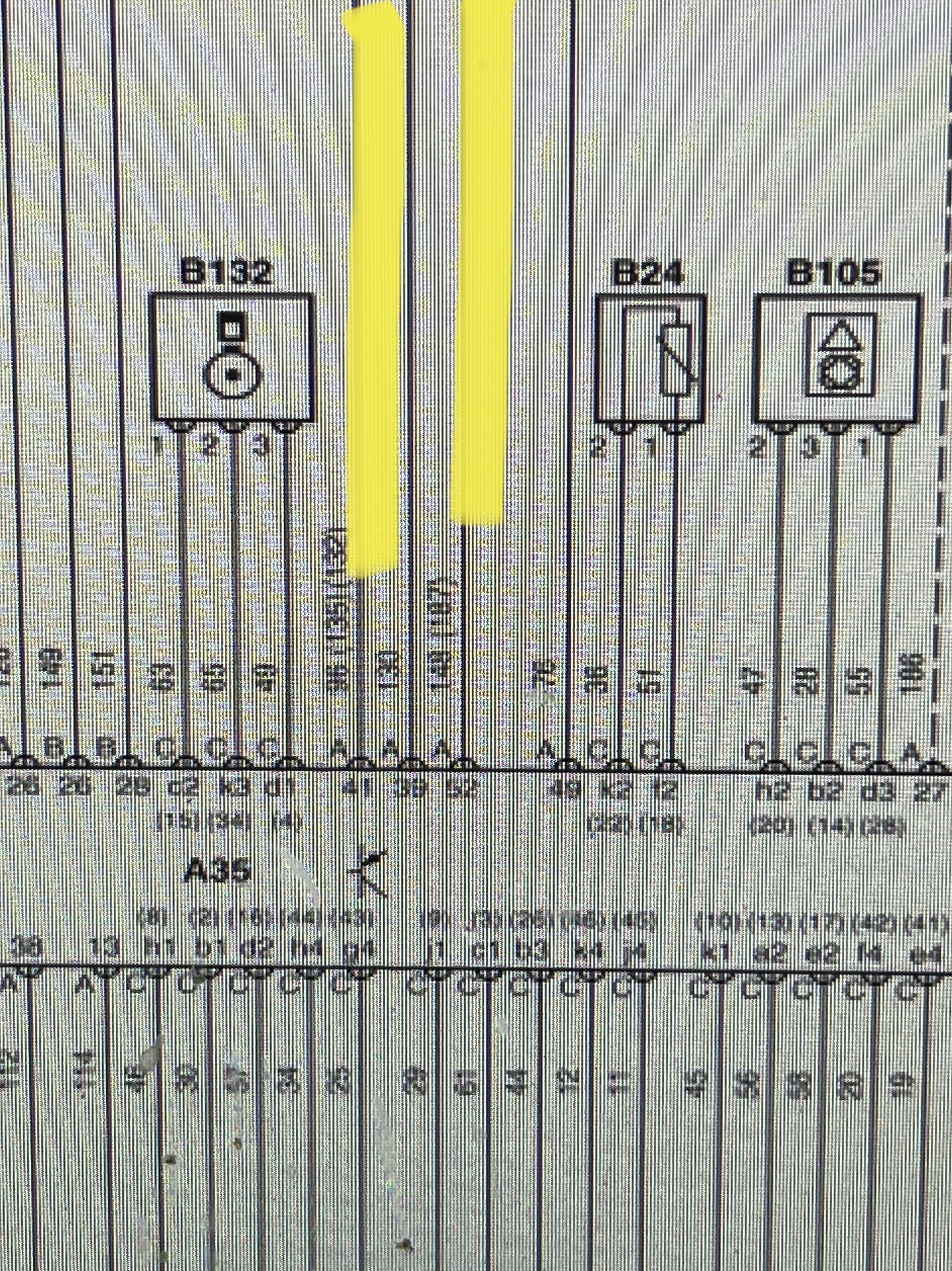

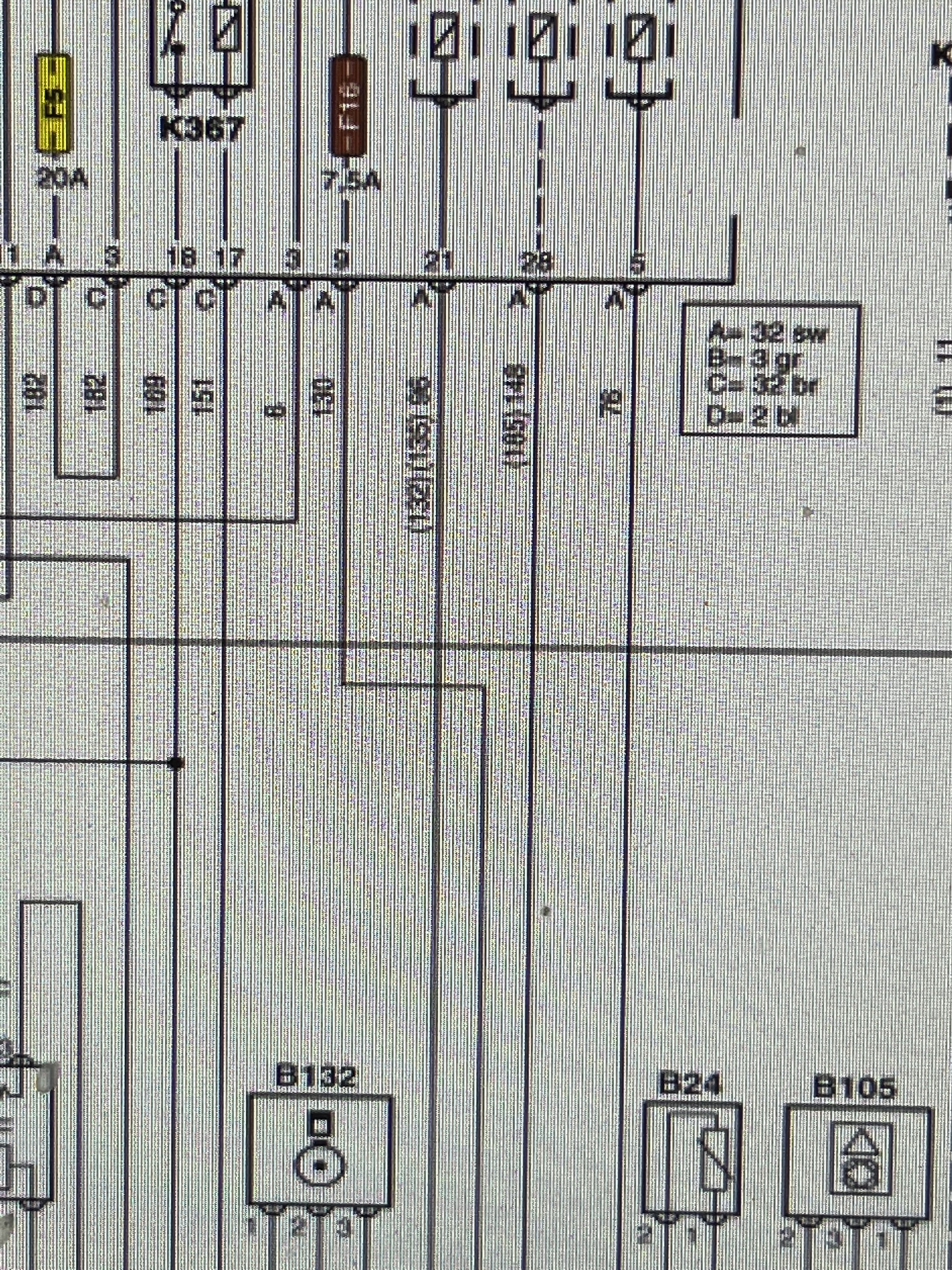

My boxer has the same issue. New fan pack, if I probe pin 87 on the relays t6 and t7 fans run, if I probe the switch side of the relay with a negative fans run. Pins 21 and 28 of the black fuse box plug run to the ecu. Probe those with a negative fans run. The diagram shows pins 90 and 69 which is not the same as I have. It’s with Peugeot atm but they cannot find the fault
Any clue on where to go now would be greatly appreciated
