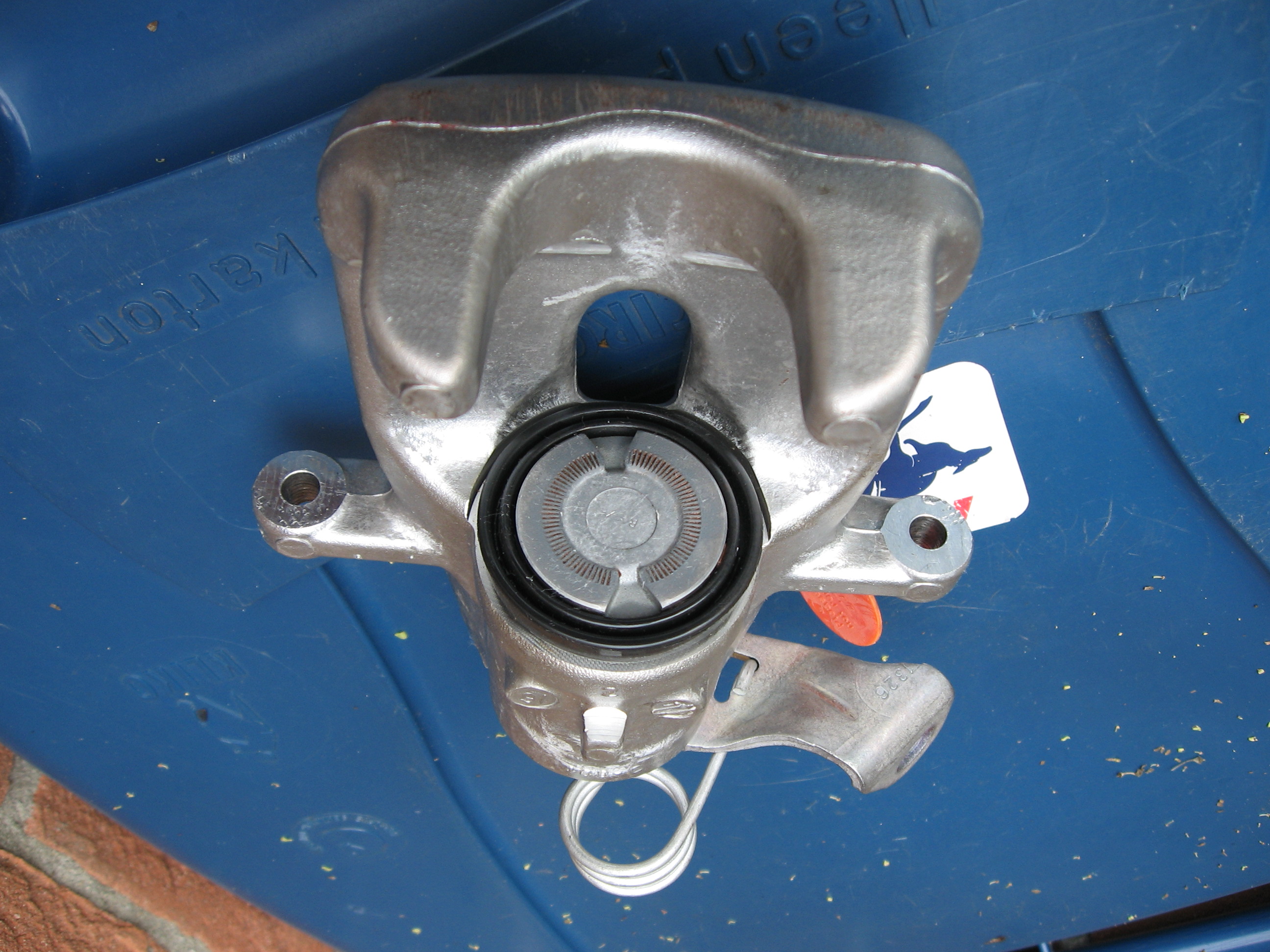

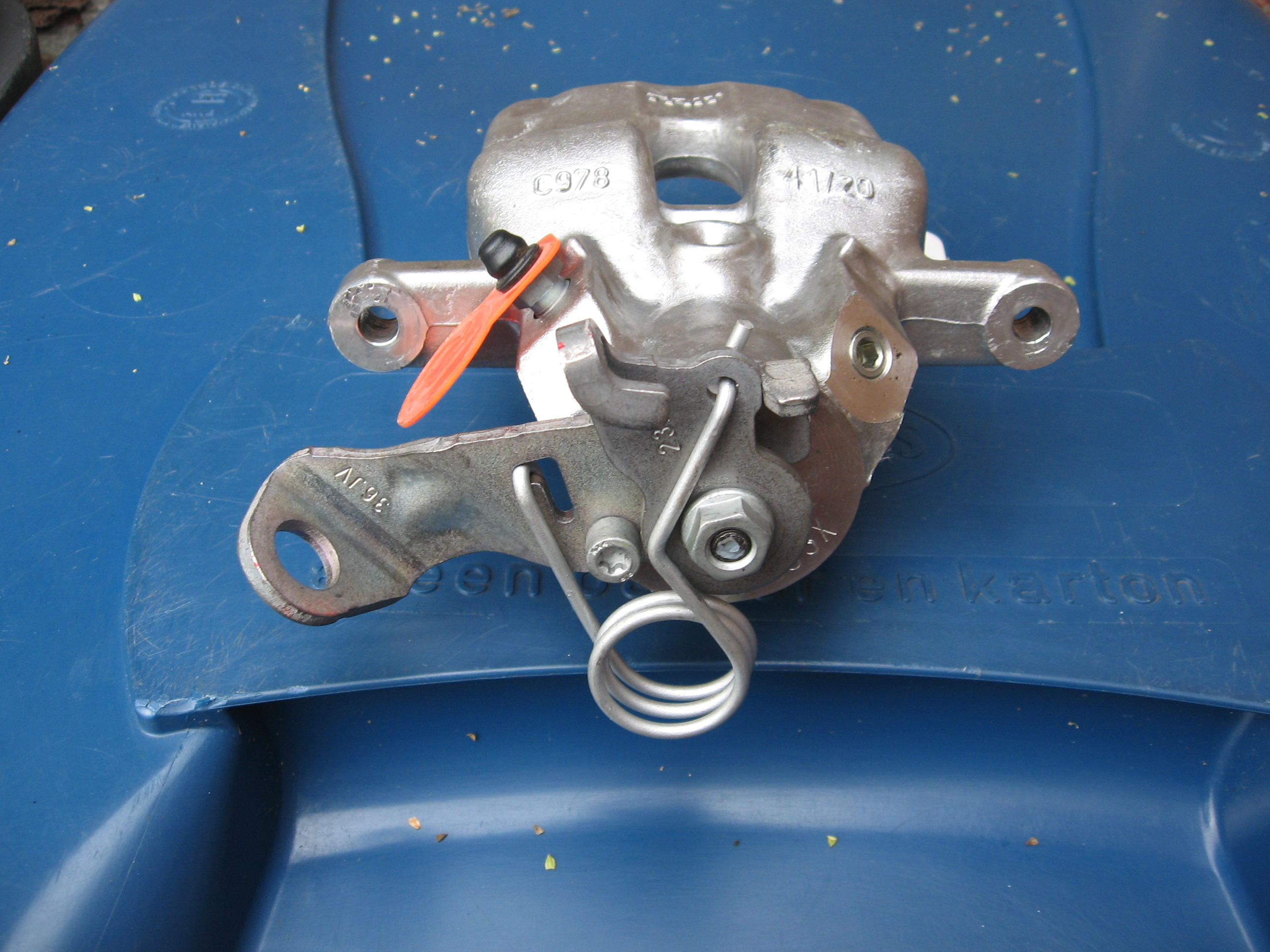

Ordered a reconditioned righthand rear brake calliper for a Croma 16V, 150BHP, built 2008, motorcode 939A2000 under part number P/n 77363637 or BHS933.
Got a righthand rear brake calliper intended for a car with 20mm thick disks, but need a calliper for 12mm massive disks, just like the one in the pictures.
The distance between the cylinder and the facing pad support has to be 57 mm, on the ordered one it was 65mm.
The calliper in Eper looks totally different from the one I need.
My sincere thanks to him or her who could supply the right part number.
Kind regards
Vento
Got the proper number for a righthand rear brake calliper: 77363646 or BHS935E (E is exchange or reconditioned)
