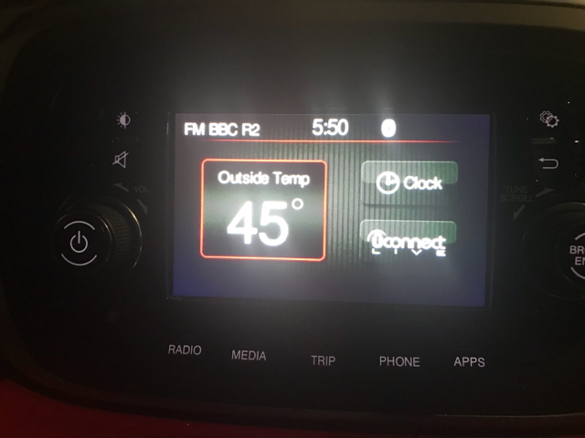

Hi last couple of days it’s been quite cold around 5 to 8 deg in the morning but my display shows 22 to 23degrees! Ice alert normally comes on at 5 deg but not now. Anyone know where the outside sensor is located?
After 4 years and 51k miles I have just fallen foul of the same problem. Bit of a nuisance when the outdide temperature is 2 deg but the ACC wants to cool me down because it thinks it's 23 deg. An expensive fix out of warranty I'm guessing.

A few years late to the party here, but my 2015 model has the same issue, it was 52 degrees yesterday apparently!
It’s booked in for a new mirror on Wednesday, but mine caused the car to be juddering when sitting still. The mechanic told me this was due to the temp tricking the car into thinking that it needed to over work the engine. Anyone else have this issue too?
