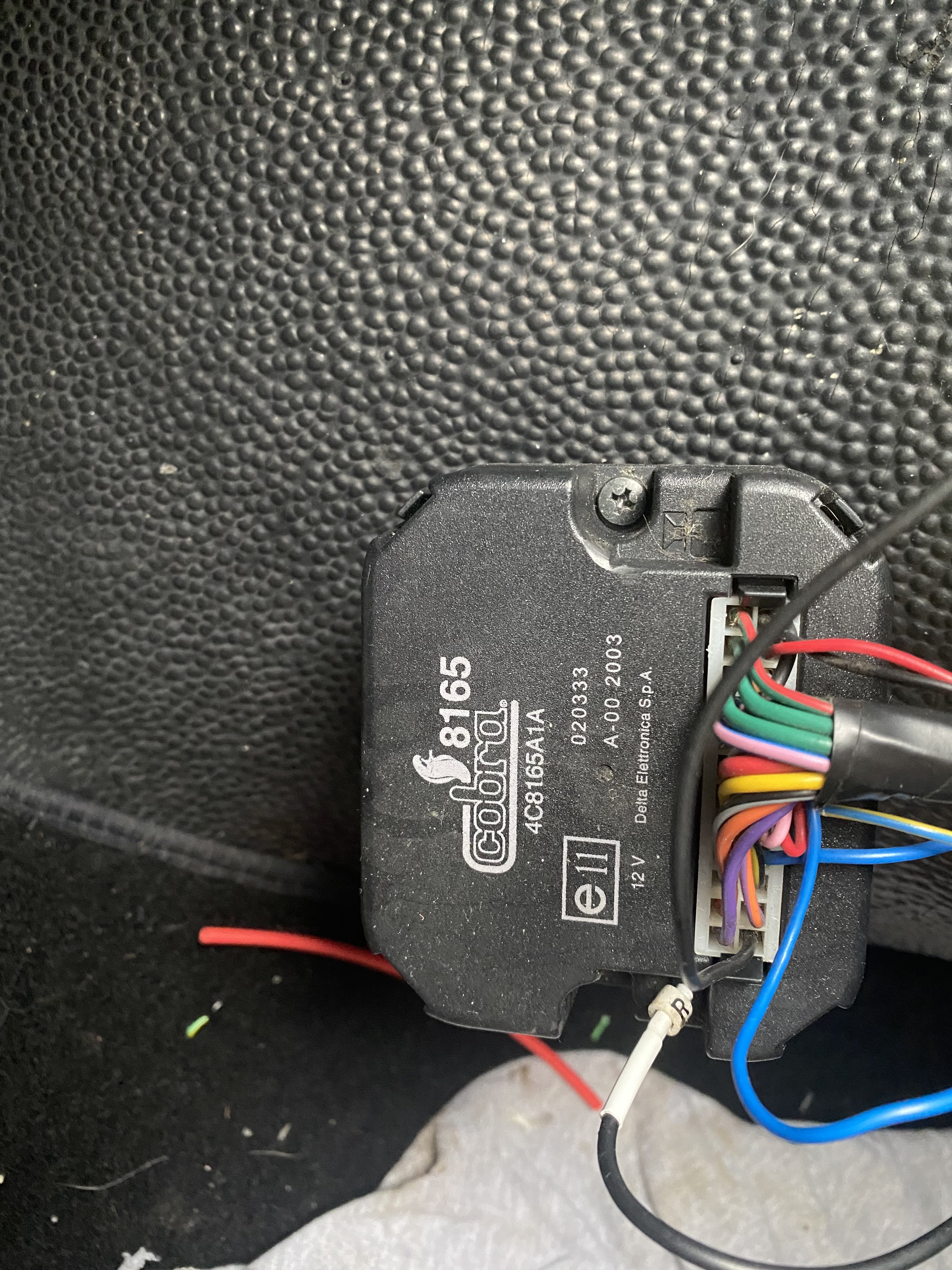

Fitted to our 2002 x230 is a cobra alarm, we never got any fobs with it or the security card, however there is a pen like touch fob thing on the keys that has cobra on it. I'm thinking on removing this completley but worried it might tap into the common rail somehow?

I am not specifically sure of what you mean by the "common rail" as on a diesel engine the common rail is the high pressure fuel rail supplying the injectors. did you mean this or did you mean the Canbus system which is like a computer network all around the van?
If installed correctly, then it is likely that the alarm is taped into several things all around the van, door locks, indicators, fuel pump, ignition etc, and the wiring for these alarms is all black so there is no colour codes to be able to chase back what they are connected to there are no pin outs from the alarm ECU to be able to reference.
I would leave it for someone either experienced with vehicle electronics or call in a professional.

Thanks I mean the fuel pump on a common rail engine. I guess I could try and find a plug and play replacement? The hab door has a sensor and the cab ultrasonics
Seems the loom has coloured wires?

That age of Duc is not a canbus system, AFAIK.

Hi Peter,
Given that your engine is a Sofim 8140.47R, with mechanically controlled fuel injection, that seems improbable. Presumably you were only removing previously cut loose ends of wires. However if you were rash enough to cut out a complete wire, then who knows?
