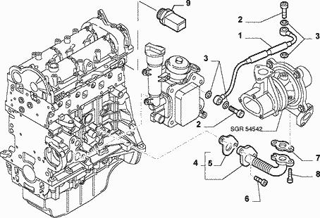

Hi all ,hope you are all doing better than me...
please can somebody tell me or show me with a photo or diagram ,the location of the oil pressure switch on a 2007 fiat doblo 1.3 diesel multijet engine. I have just had a new turbo whilst on holiday :mad: and was told that I need to have the oil pressure switch done aswell. The garage wanted to do it as another job when they had my car in pieces anyway! then 2 local garages said they could not find it or would not tell me where it was and wanted to make it an all day job !! I am hoping it is only an hour or two job that I can do it myself when I can find it?
any help would be greatly appreciated, Many thanks geoff

From the link above, you need section 10301/20, p5/6. Item No.9
Looks like it fits in the top of the cylinder head. As long as you can get at it, a five minute job.

hi many thanks to portland bill and pedro for the help :):) it was greatly appreciated. so much for the garages who couldnt find it!!
Using the 2 replys above i found it easily you dont need to strip anything, from the near side wing lean over and put your hand under the tube going into the air filter between radiator and unplug 2 mins , thanks guys
