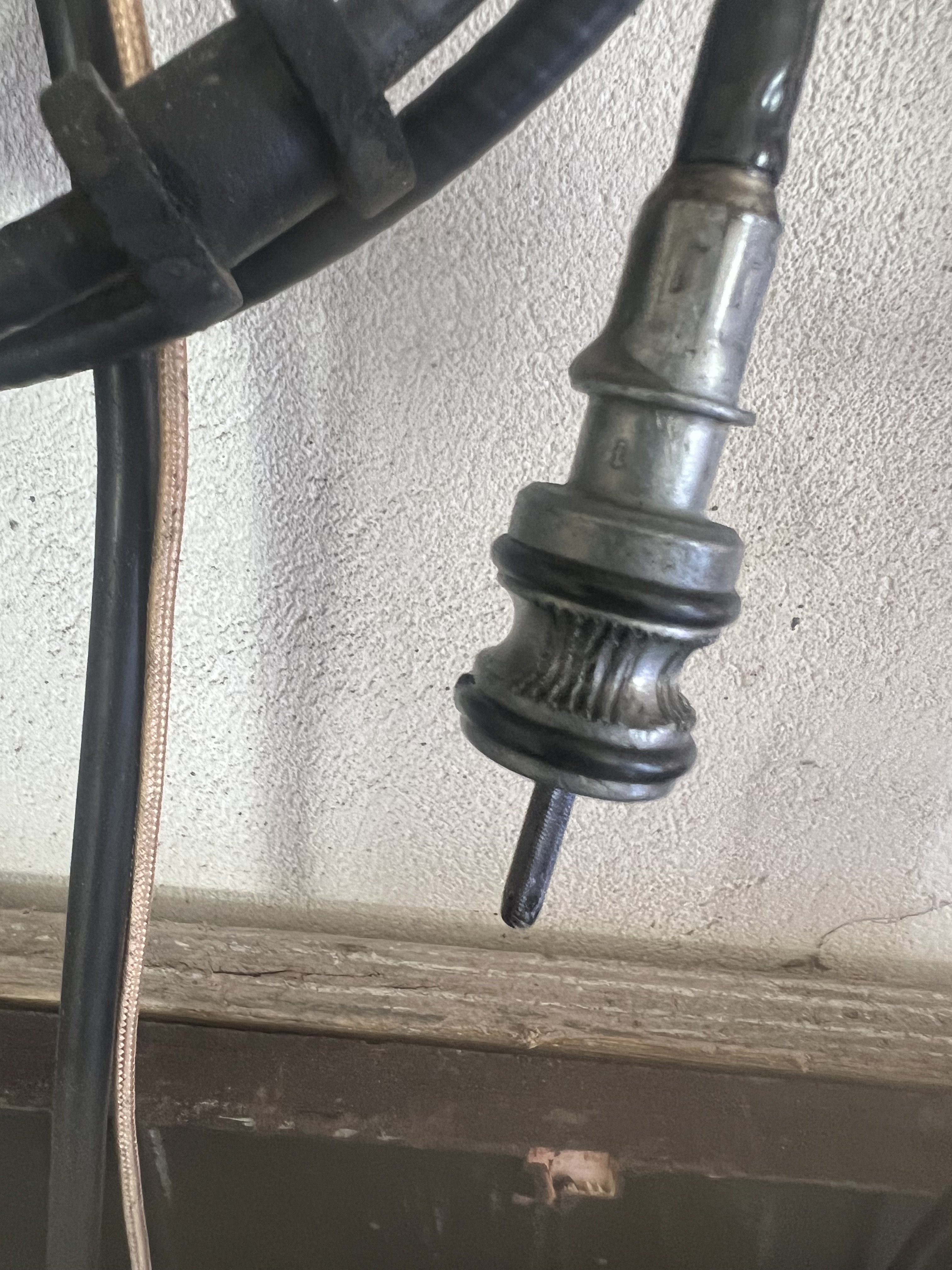

Hi everyone, thanks for the reply, but I think I haven’t made it clear, my fault. The housing that holds the speedo cable is made of plastic and is held in by a small M6 bolt, the speedo slides in to this housing and is held in by a rubber pin. I will post photos of reg, fuel pump, vin plates etc etc. cheers Mervyn . ps turbo diesel

Thanks for the update and photos. Please note that I've not had personal experience of this issue so I'm just suggesting what I would do.....
The oil leak must be either from the joint between the plastic housing and the gearbox or from where the cable enters the housing. It's difficult to see from the photo in the post I linked whether there is a gasket between the housing and the gearbox; you may have to loosen the M6 bolt on yours to check. (if there isn't a gasket it may be that the plastic housing has deformed slightly and the oil is leaking through the gap) The seal between the housing and the speedo cable must be made by the two rubber O-rings shown in your first photo.
In view of the age of your van it may prove to be difficult to obtain specific replacements for the plastic housing or gasket (if there is one!) or the O-rings. You may be lucky and be able to match the O-rings from a box of assorted rings obtainable online or from a motor factors. With regard to the housing you may have some success by using some sort of 'liquid gasket' between housing and gearbox (but be careful it doesn't get inside the gearbox!)

Hi fellow members, all replies are appreciated, the plastic housing holding the speedo cable with the two o rings this is slightly oval and this is where the problem lies. I would like to find a replacement, new if possible but a good second hand one would do. I have tried to seal it with CT1 which is a good strong bond, but it is not in a easy access I don’t have a lift and I still have a leak. What I read about this model and year there seems to be three or four different types of fitments, so I will keep searching the web. Cheers Mervyn.
