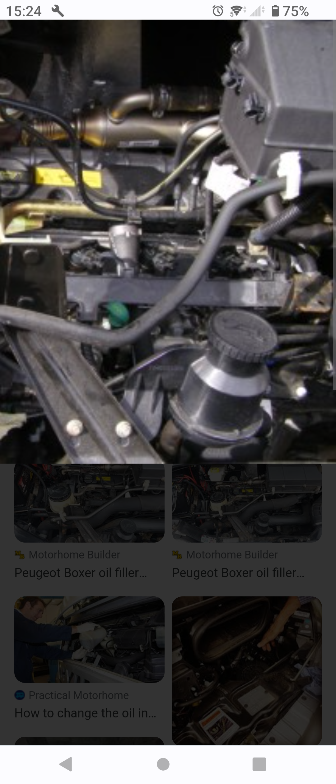

I have a 2005 2.0 Jtd x244 ducato and stupidily didn't put the cap back onto the remote filler that's on the front above the radiator and to the right of the power steering reservoir
Anyone know a part number??
Photo of the internet to show what I'm after
Thanks everyone.

I have no experience of using it, but you could try ePER (electronic Parts Equipment Register) which is linked at top of page.
@Communicator
Thanks for the help. First venture into ePER, bit fiddly on the phone but found what I was looking for
Just in case anyone is searching for the same thing in the future.
Part number 9613546180.

Just to follow this up, the part number above isnt correct for my vehicle. When the replacement turned up it was a nearly but not quite. It was a very coarse square thread whereas I need the finer thread. The part number of the item I received did match what I ordered so it not a problem there.
After much searching I found another part number but cant for the life of me find one. Part number 1345675080
