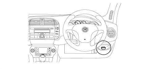

Where's the OBD connector on a UK (RHD) Bravo?
Is this accessible without removing any screws?
Cheers,
Steve.
From eLearn:
The K lines and the B-CAN network flow into the EOBD diagnostic connector centrally located on the Body Computer.
For right-hand drive versions there is a diagnosis connector not connected to the Body Computer. It is located to the right of the steering wheel in an easily accessible position.
In this configuration the Body Computer is on the left side of the vehicle and therefore not very accessible as it is behind the glove compartment.
The built-in Body Computer connector and the external one located to the right are completely identical from a functional point of view and can both be used for diagnosis purposes.
