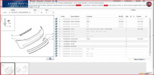

This is weird - ePer recognises your car, but isn't showing any compatible rear bumper trim!
Have a look at the attached screenshot.
I'd have expected yours to be the chrome trim, which is part no 735455395. This ties in with this listing from S4P. It gets more interesting when you look at the price - 735455395 is £172.70 inc VAT on ePer!
Are you certain the bodyshop isn't trying to save a few quid by using pattern parts (they're quite a bit cheaper & readily available).
Have you got a photo anywhere that shows your rear bumper?
