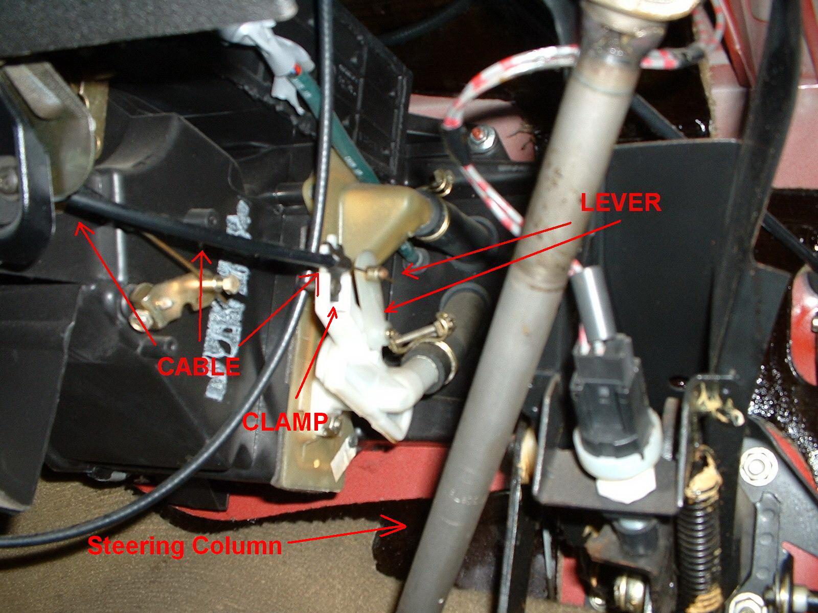

Ok, so from what you described with heater knob going 'click' it sounds as if either the cable has jammed, the knob itself is faulty or the valve is stuck.
You cannot back flush the heater matrix if the valve is closed as it shuts off the coolant supply, and the bypass hose in the engine bay will return coolant sent to the matrix back into the engine cooling system. The valve must be open for coolant to flow.
First thing to do is check to see what the valve is doing. I've attached a picture below of what to look for. Whilst looking at the heater valve arm operate the heater control (hot/ cold knob). You should see the cable pull the lever back and forwards. If the arm doesn't move then your problem lies with the heater control knob and/ or cable.
If the cable/ control knob appears to be faulty then you can still operate the valve. You will need to release the cable at the valve either by removing the screw that clamps the outer cable to the valve (arrowed) or releasing the inner cable from the arm. This will allow the valve to be moved freely by hand and you then will be able to establish whether it is flowing coolant or not.

Fixed cable, valve opens now. The two pipes in the engine bay at the back are hot, but when feeling the pipes inside the car, they are cold. Flushed heater matrix (hosepipe into the bottom pipe, and very filthy water came out.

I would say that even though the lever on the valve is now moving, the valve itself may be jammed shut. This has happened to me before. The flow is restricted enough to ensure there's no flow through the matrix, even though you managed to get enough flow during your flushing to get "very filthy water" out (I know exactly what you mean).
The only solution is to unbolt the valve from the heater matrix (easy to do, but put a bowl in the footwell first, obviously) and inspect it. You may be able to clean it with oven cleaner and boil in a saucepan etc., or you might just replace it.

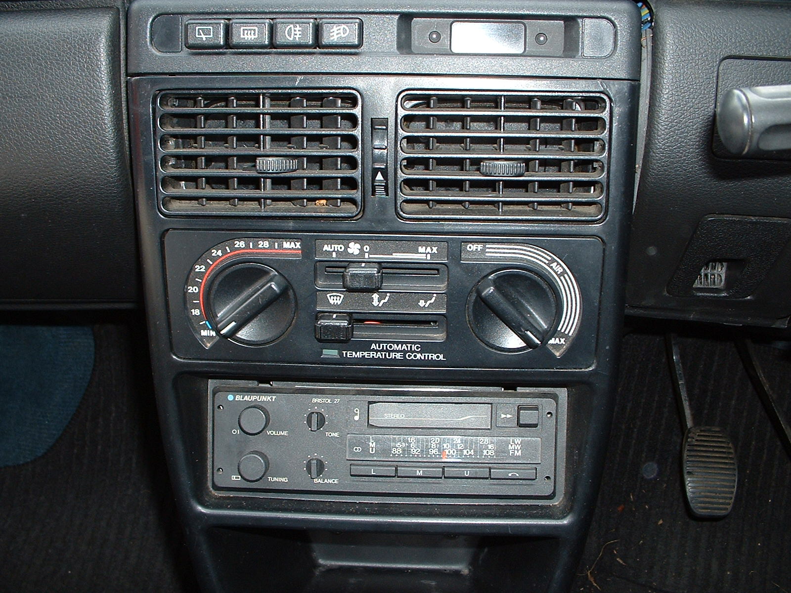

Alex I reckon is spot on with his reply. Most probably a faulty valve.
However, there are a few other things you can check:
With the engine up to operating temperature and the heater set to 'on' (max heat), feel the two pipes in the footwell going to the heater matrix. If one is considerably hotter than the other than it's almost certain that the valve is faulty.
The reason why I suggest checking from inside the car is because in the engine bay there is a bypass hose connecting the inlet and outlet heater matrix hoses. Even with the valve closed the water can still heat up the outlet hose because of the heat transfer across the bypass pipe. This can give the impession that hot coolant is flowing through the matrix when it's not.
Another thing to check is the heater box inside the car. If the matrix is flowing hot water then you will still feel the heat around that area. Also, are you sure that the other heater control ("air control") is set to maximum? It controls the flow of air and I think if it is shut then it won't allow air from the matrix into the car. Also some Unos have an "automatic temperature control" function activated by a switch. Does yours have this and is it switched on or off? See pic below for the controls.
Lastly, what temperature is your car running at? Warmed up the car should indicate 80 - 90 degrees on the temperature gauge. If yours is much lower than 70 degrees then it's possible that the thermostat is faulty and the car isn't warming up enough to heat the matrix.

Thanks guys, you are excellent!!! Heater is perfect now. Getting hot air through the foot vents and the windscreen, but not through the main and side vents. Is this normal?

There is a screw on the inlet valve with a moving plate thing that opens the valve and closes the valve. That screw was loose enough so the plate moves, but not the valve itself. Tightened screw and sprayed some multi lube into the valve and fiddled with it for about a half an hour. Works perfectly now.
Yes, this is normal. The centre vents and large side vents are non heated air only. There are also two smaller side vents (non adjustable) that put out heated air to the side windows for demisting purposes. Otherwise the heated air only goes to the windscreen and the footwells.
