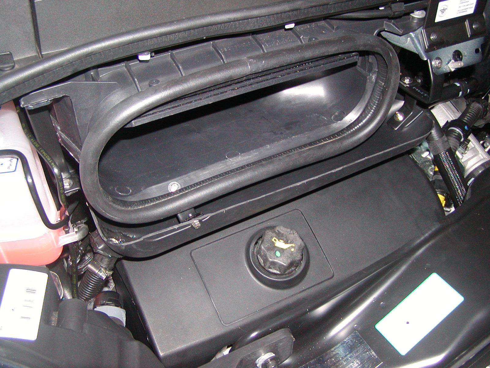

Long (=too long!) winter here while waiting for the nicer driving season...
I paid attention to the above comment, but maybe I'm not patient enough to wait and see if potential leaks have been fixed already at the factory? :chin:
I have had lots of fun with the Ducato in the garage and thought I'd share some photos of the "plumbing" I have done in the engine bay! I'll attach one here and there are seven more in the gallery department in my photos for those who like to look at crazy ideas... :ROFLMAO:
I am optimistic that at least I'm not bringing any more water into the car! :D

As Ordita says ... i've bin "Plumbing" too ................ As luck would have it I was idly mooching about flea bay last week .... & came across a 2010 Citroen Relay being broken (Had bin Rear Ended) .. On the phone quick as a flash to see if it had an "Engine cover" still on it ...................................OH YESSSSS it DOES .... & it can be mine fer 25 quid .. (I couldn't get Paypal to load up fast enough ........) .... Now fitted along with a very nice "Painters kettle" attached under the join in the scuttle panel .. & from that a bit of 3/4 overflow pipe & an Elbow down to outside at the bottom ....
Yer gotta do these things ..it took me 25 minutes to complete it took Fiat 8 YEARS to re-design the bloody Scuttle !!!
