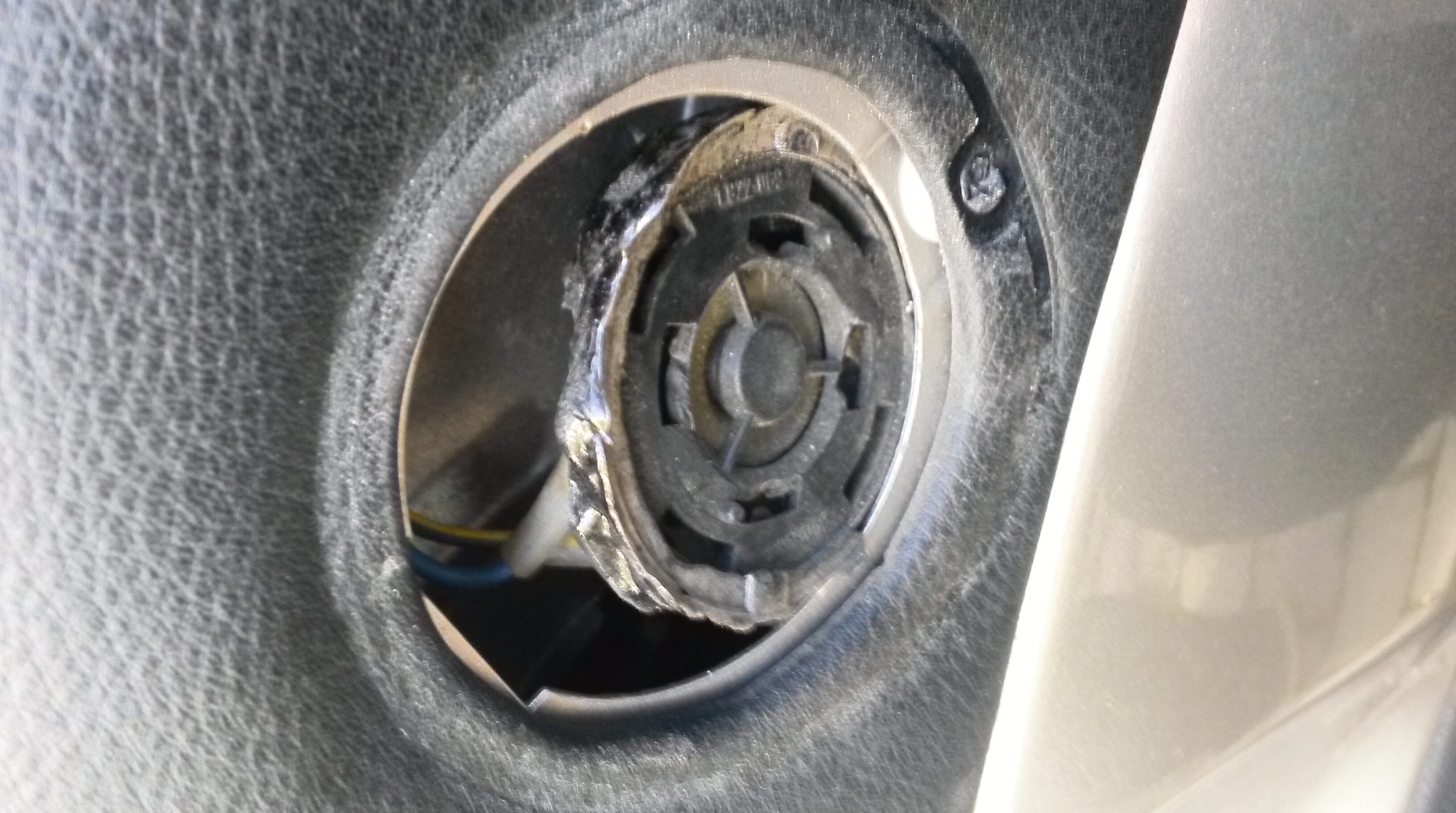

I reckon the tweeters are easy as well, but I have a question regarding them: Is the mesh part from the original tweeters supposed to come out? I didn't get a chance to try as it started raining when I wanted to change them. Moreover, I reckon my tweeters have broken away from the mesh part... which is nice... :eek:

:D Looks like they have come apart. The tweeters just come out as one unit - usually. The plastic cover unclips once the screw is removed and then the tweeter is set behind the cover.
