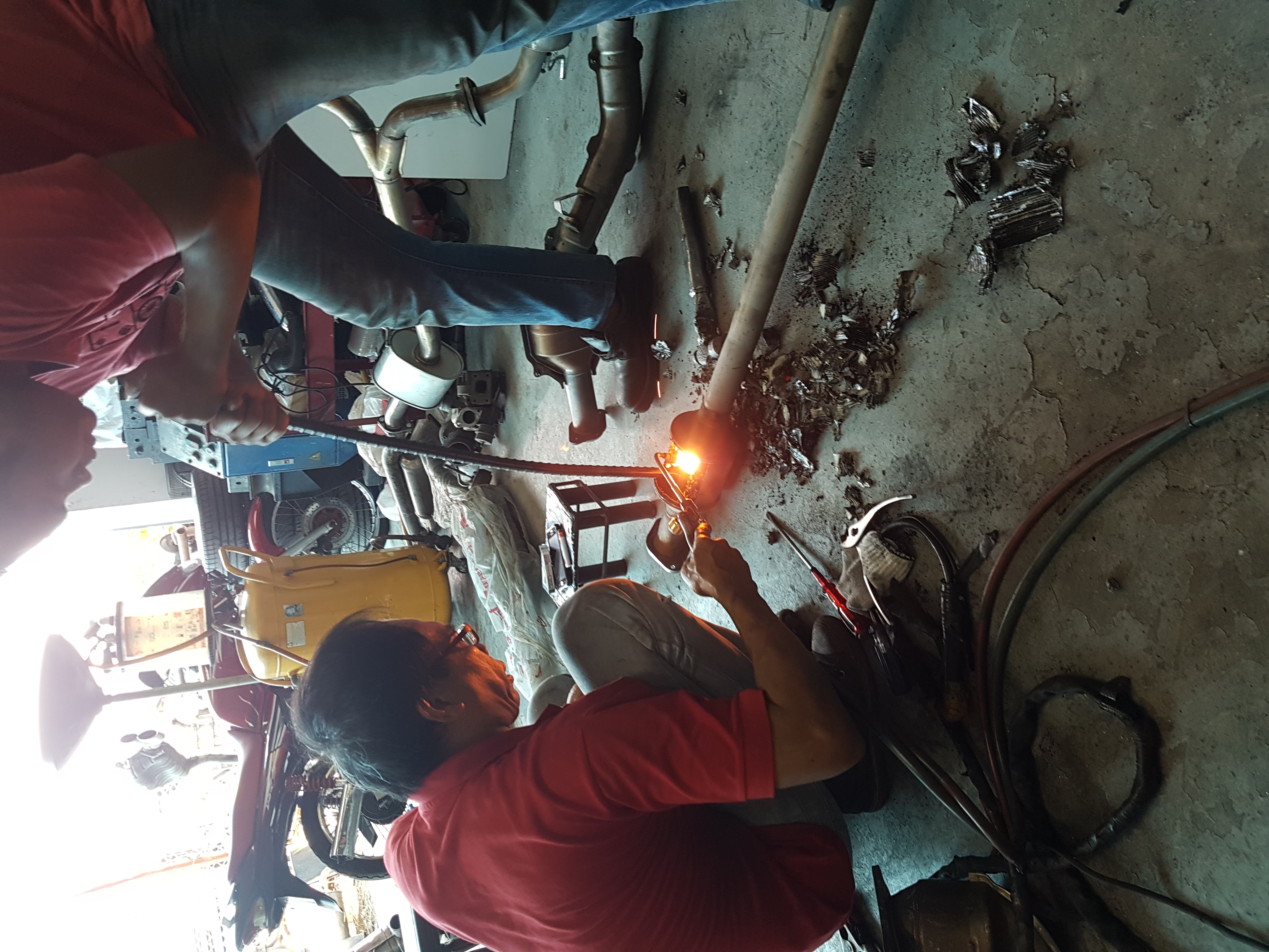

Take a high pressure washer and hose down the dpf....it is metal based not ceramic based like normal petrol engines and is so strong that it requires a prybar and an acetylene torch to be gutted. Simply picking at it with a long screwdriver would barely nick it so it would be pressure washer safe. (I attached a picture of my guys taking out the secondary dpf but it was the same for the dpf that is near the turbine housing outlet). It would get rid of most of the soot and save u a bunch.
