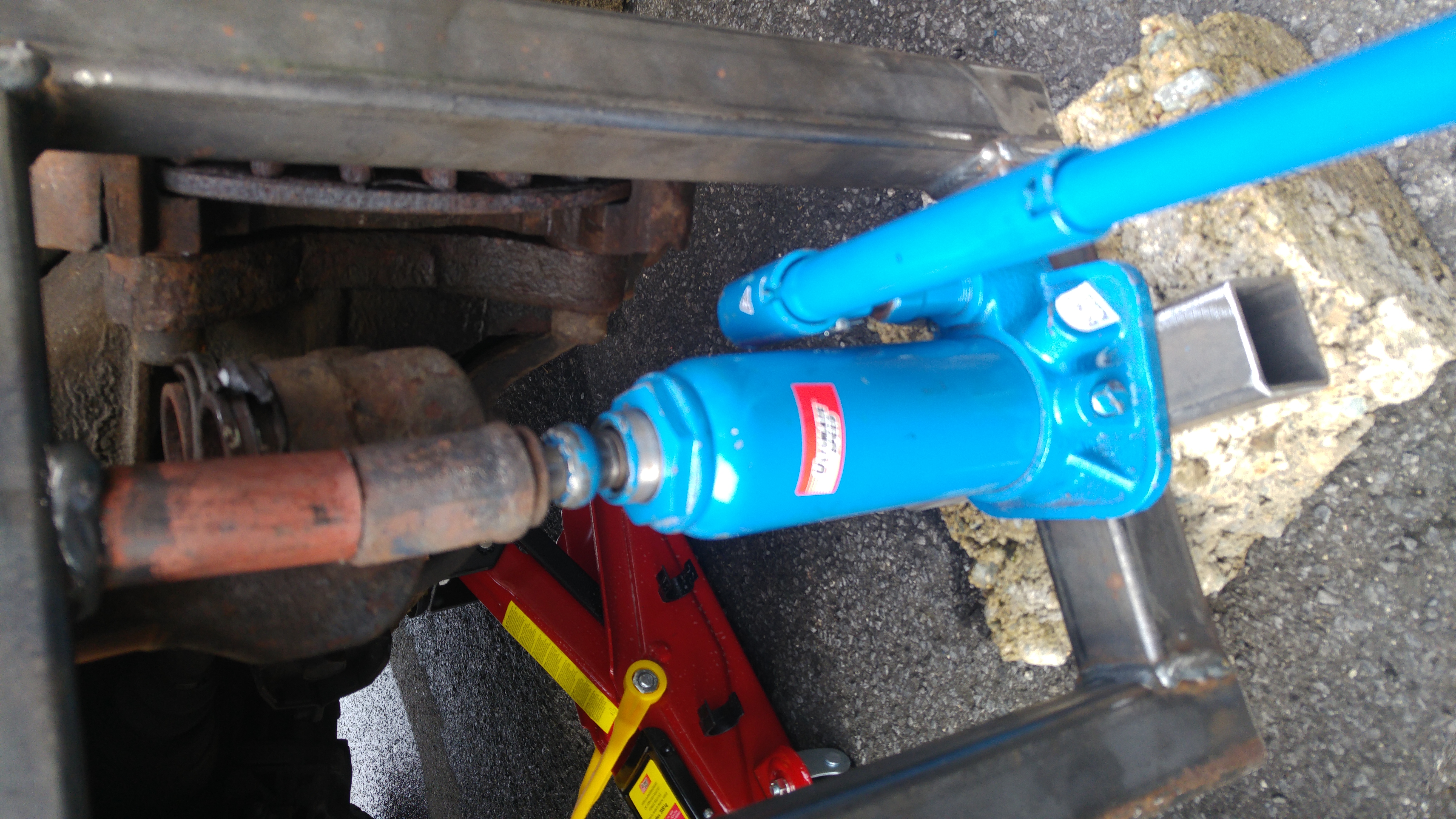

need a bit of advice...cant get the sliders to move on the front calipers...see pic

ps..made a press and used burning gear to heat things and a 3 ton jack but no luck

Didn't think the slider pins were that thick, what part are you trying to press? If the sliders were seized how did you get the caliper apart? Do you mean the pistons are seized?
I had to drift mine out with an old deep socket and lump hammer

thanks in advance...digger58...the sliders are 18mmx63mm so i was useing a bit of 12mm bar to push them up into a 20mm bit of tube welded on to my diy press but aven with a bit of heat+3 ton bottle jack they wont shift
