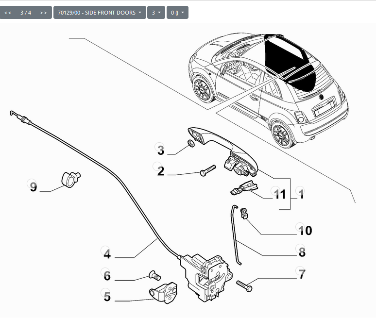

Was replacing the door handle on the passenger side, went to remove the rod that is held in place by two clips one at the top and one at the bottom. Pulled the rod at the bottom and snapped the clip. Cant find the pieces but i believe it was black. Does anyone know where i can get this part from? Picture of the piece below (just need the black clip)

According to ePER (link on the bottom of the forum banner, search window is top left of the screen, you can browse by models and categories or search with VIN number, which will display only the corresponding part numbers) it's number 10 on the diagram:
The part number is: 14578082.
I think it's a part common for several models, but I'd however suggest to check on your own with the correct VIN number.
Then navigate through these categories:
701 DISPLAY UNITS AND WINDOWS
70129 SIDE FRONT DOORS
70129/00 SIDE FRONT DOORS
The clip should be cheap, so probably postage would be more expensive than the part - and the easiest would be to check at the dealership. Or a local automotive shop.

Thankyou, this was the correct part. Much appreciated!
