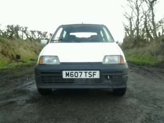

Light at the end of the tunnel at last. Windscreen is back in at bonnet is on.
I took the screen out to do two little bubbling patches. Next thing holes.
Still looks better now.

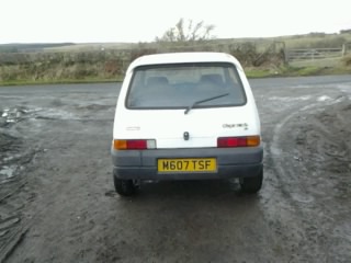

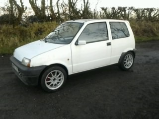

Right, exhaust refitted, bottom of the wing is now in clearcoat.
Thanks to a quick read of rallycinq's post, I now have only one wiper. However I have developed a squeak, or a squeal from the assembly somewhere, d'oh.
I have ordered two m8 rose joints, and I am going to remake the linkage from motor to wiper spindle. The plastic ball joints are looking a bit sorry for themselves after 20 welsh winters.
It lives.
Well sort of, it runs under its own power. Doesn't stop very well yet. I have a problem with my nipples.
Wow, forgot how good it is to drive her again.

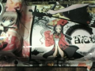

Er, sort of got a bit bored. So I hydro graphic printed my can cover. Oops.
Don't know how it will perform on the car, as the engine bay is a bit of a hostile environment.
Worth a go.

I'll get some better pictures, with her indoors camera when the clear coat has cured overnight. That's if it doesn't bloom, because of course it has started raining again, and she won't let me keep it in the house because it stinks.

It is all done in 2k, but I think 90+ degrees Celsius is pushing it a bit on an engine.
Do you recon baking it would help?
Duncan have a look at hydro monkeys web site.
It is an absolute bugger of a job, everything has to be spot on or it goes horribly wrong.
Quite difficult if you are in a garden shed and a single garage in wales.
Paint what you want to dip with 2k paint aka 2 PAC. Flat it down until it is a matt finish. Fill a suitable container with clean water, mask the edges of the film. Spray with activator, and dip it.
There is obviously more to it than that, but that is essentialy it. You can do wheels or entire panels with it. The sky is the limit really.
Also check out swirling on YouTube, that's pretty cool too, I fancy having a go at that.

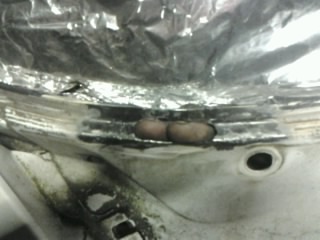

As promised, a bit better photo of my cam cover.
It survived overnight, and is on the car. I have run her up to temp with no issues so far.
So fingers crossed.
No reason the old girl can't go for an mot next week.
Know what you mean RAF. Should be ok as long as you use 2k self etch primer.
Bit of high build and decent quality paint. Main thing is to make sure the surface is totally flat as in mat finish.
I had problems sealing the cam cover, almost as if the surface was porus. I had to wire brush it with thinners first.
You can either mask the back off like I did, or clean it to the n'th degree. Because once dipped you can't touch the surface, just rinse and clear coat. So any oil will cause fish eyes.
