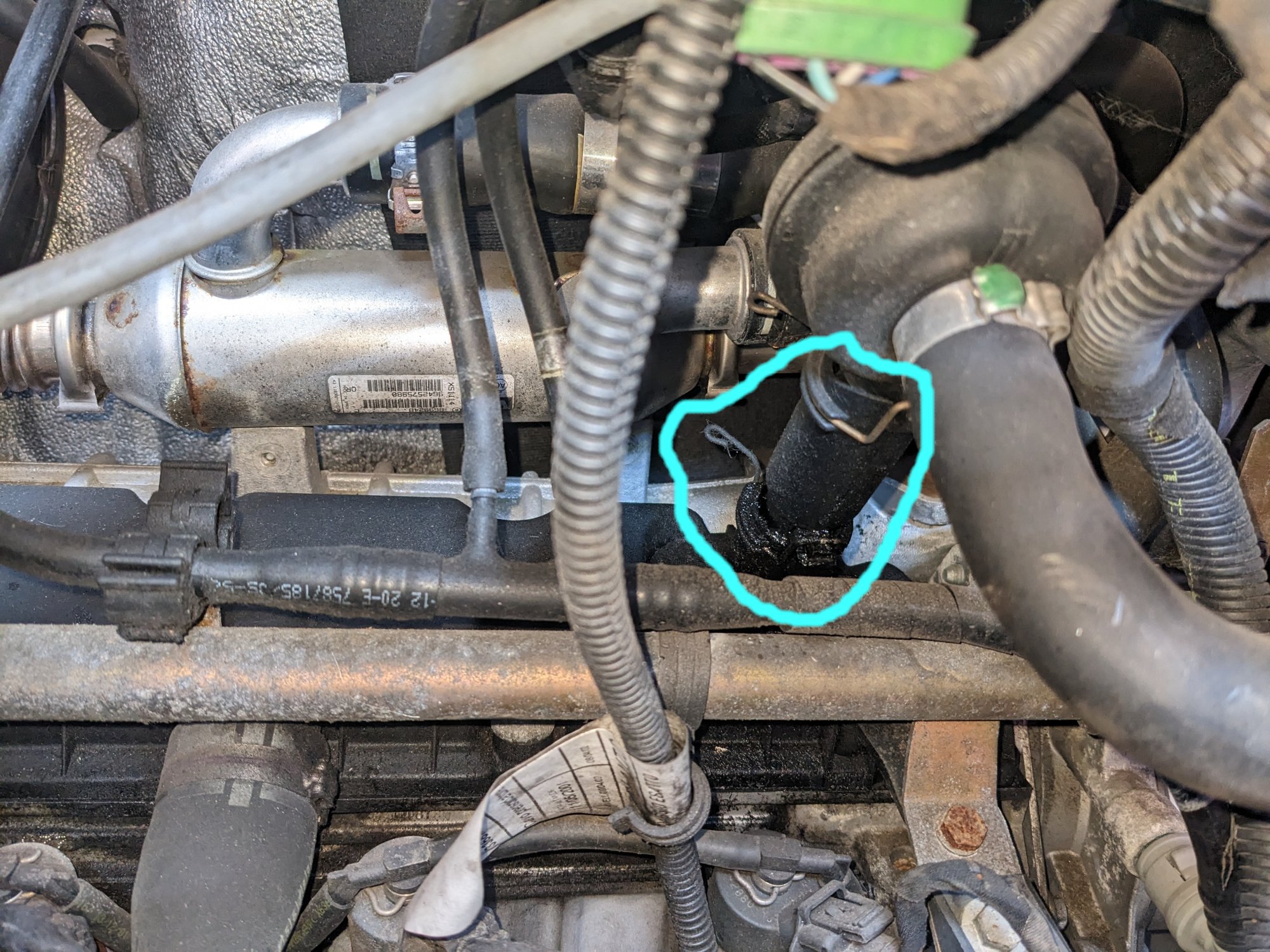

My 2.0 hdi engined motorhome lost power and started black smoke. The recovery guy thought he could hear a boost pipe problem. All I can find is what looks like a broken breather pipe from the engine cover (circled in blue in the photo) but I can't identify it in any parts list I've seen. Can anyone help?
The broken hose and attached NRV do indeed to be part of the blow by circuit. Can't you replace the short broken section, with a short piece of oil resistant hose of similar dimensions?
This does not appear to be the cause of your power loss. Black smoke usually means too much fuel for the available air supply. Perhaps after repairing the broken hose, you may be able to locate an air leak which will probably need the engine running. Is it possible that one of the intercooler hoses is split?
