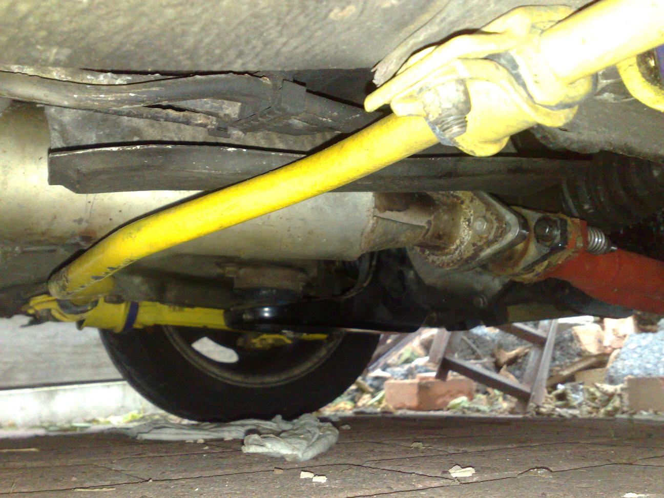

Me and dad where bored today so we desided to grab one of the many bike cans we have and fit it to the cinq. tell me what you guys think! its not loud at all (which is GREAT) its just very deep.

Runs fine! I fitted it after fitting the supersprint manifold (which made a change to the car) but the bike can never made anything I would feel!
The can was JUST shorter the the standard back box so it was just a matter of cutting the olden off and welding the can on and fiddling about with the hangers (pain in the arse)
Ill try get a drive-by video and incar vid the weekend if your intrested? definalty a good mod if you have a welder and not much money! damaged cans are pennys on ebay/salvage and much better built then car stuff (repackable to!)
very true! dunno where about you are but I have cans coming from everywhere cos my dad works as a motorcycle mechanic for an insurance repair place. hes got LOADS of dented/scuffed cans, so could sort you one out.
One I have only has a slight dent (you can see in the pic) that could be pushed out when repacking. not point as im sure it will take a few hits in its new home :p
