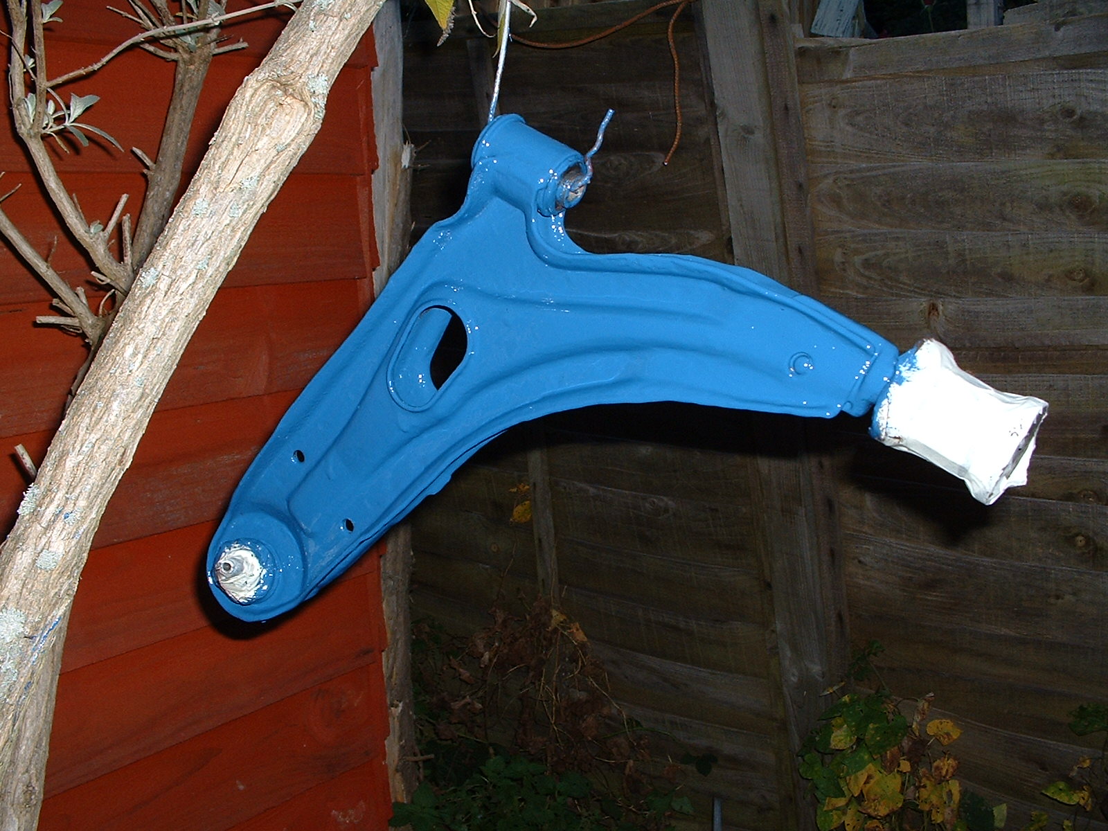

nice work....just a note of caution, that control arm looks a touch rotten, they do all go that way, and most will generally be ok for years, but occasionally, the balljoint will punch through the arm making you wobble all over the road, screaming like a loon as the on coming traffic tries desperately to avoid you.....
not that it's ever happened to me:p
give it a good look over just in car(y)
Yeh I noticed the rust. I've got a brand new pair subframe & wishbones just haven't had chance to swap them over.
Matt
The paint on the front track control arms is wafer thin, comes off and they always go rusty. Often they look worse than they are but it's always a good idea to check them.
When you fit a new one you could always paint it in better paint. I did that for mine using a spare tin of Smoothrite. Looks good and should offer better protection (y)
