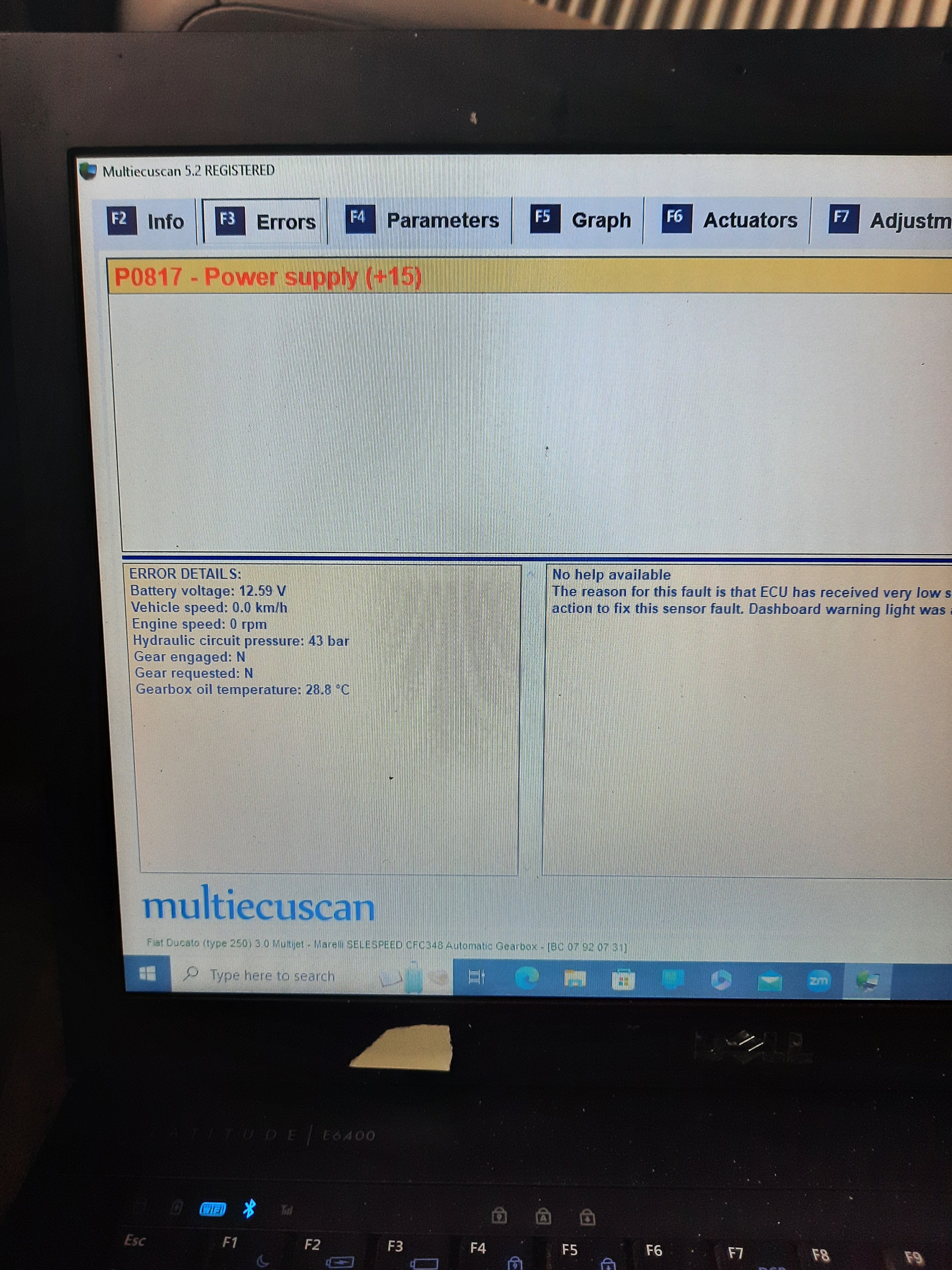

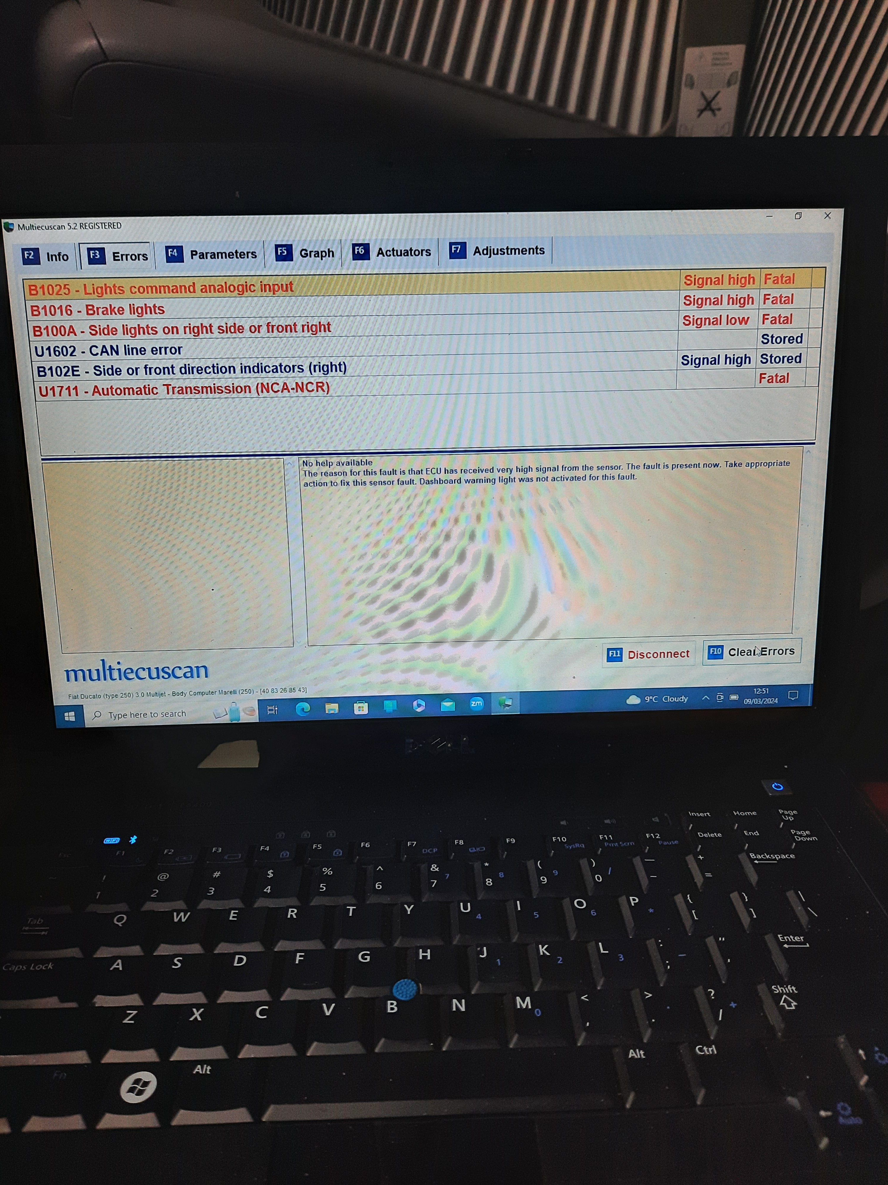

So I've changed the earth lead from the battery and the one behind the air filer the usual suspect. Water and we've had an immense amount of rain for the past 6 months got into fuse box so I've cleaned out the channels and put in hoses where there were just holes. I've changed the fuse box and the brown multiplug underneath that had shorted out.. I did have no Neutral symbol on the dash cluster but I've got this back using ecumultiscan. There's no communication from the gearbox module which I understand is somewhere in the passenger compartment. There are two sensors on the gearbox. One of these is the speed sensor but which is which is hard to tell. I think I will have to remove the air cleaner housing to get to the other but I can't find any info on removing the housing itself either. All lights are present on the dash cluster but when the key is turned to the start position there is nothing. Not even a click. The vehicle was running fine without any problems until last October when I took it for its MOT. All the lights were working before I set off but it failed the test coz the right hand side side lights were suddenly not working. I had to return to the campsite with no test certificate and things went downhill from there. The sidelights are still out but for now I'm concentrating on getting the engine running. At first it turned over without firing but now it won't even do that. The batteries have good charge as I'm permanently on electric hook up and the system is in split charge which keeps the service battery and the 2 auxiliary batteries topped up. So I don't think its a power issue. I suspect that it's one of the modules or one of the sensors but that is 4 options. I can't narrow it down any further

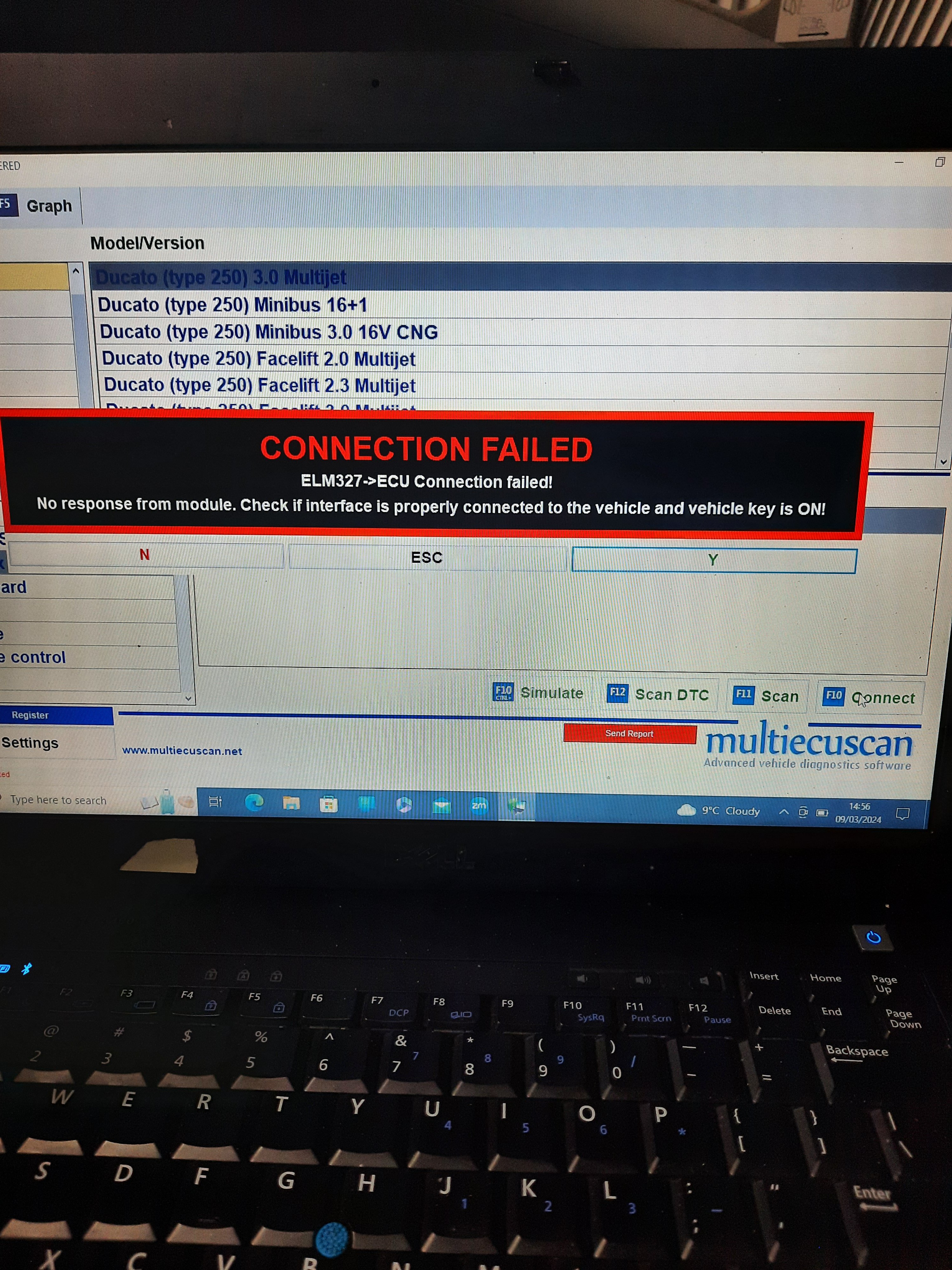

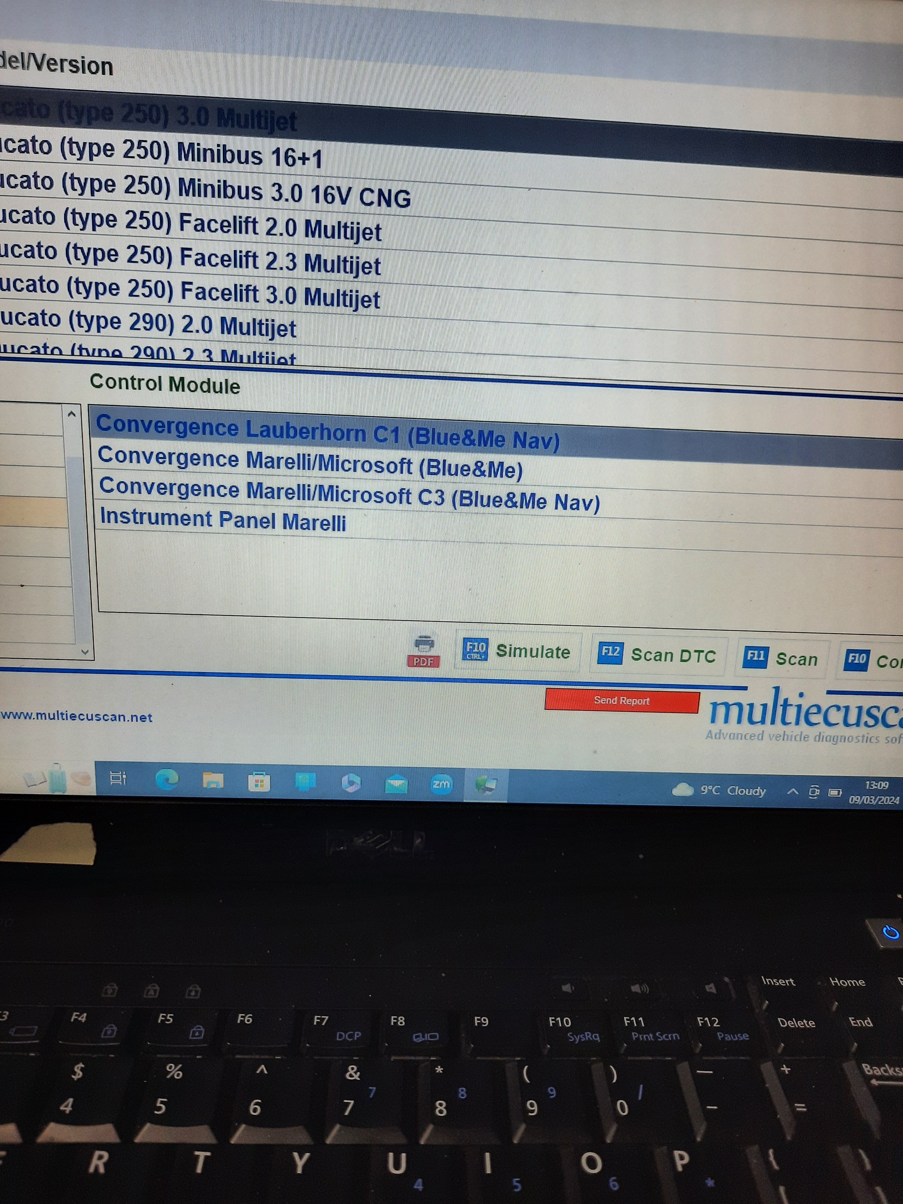

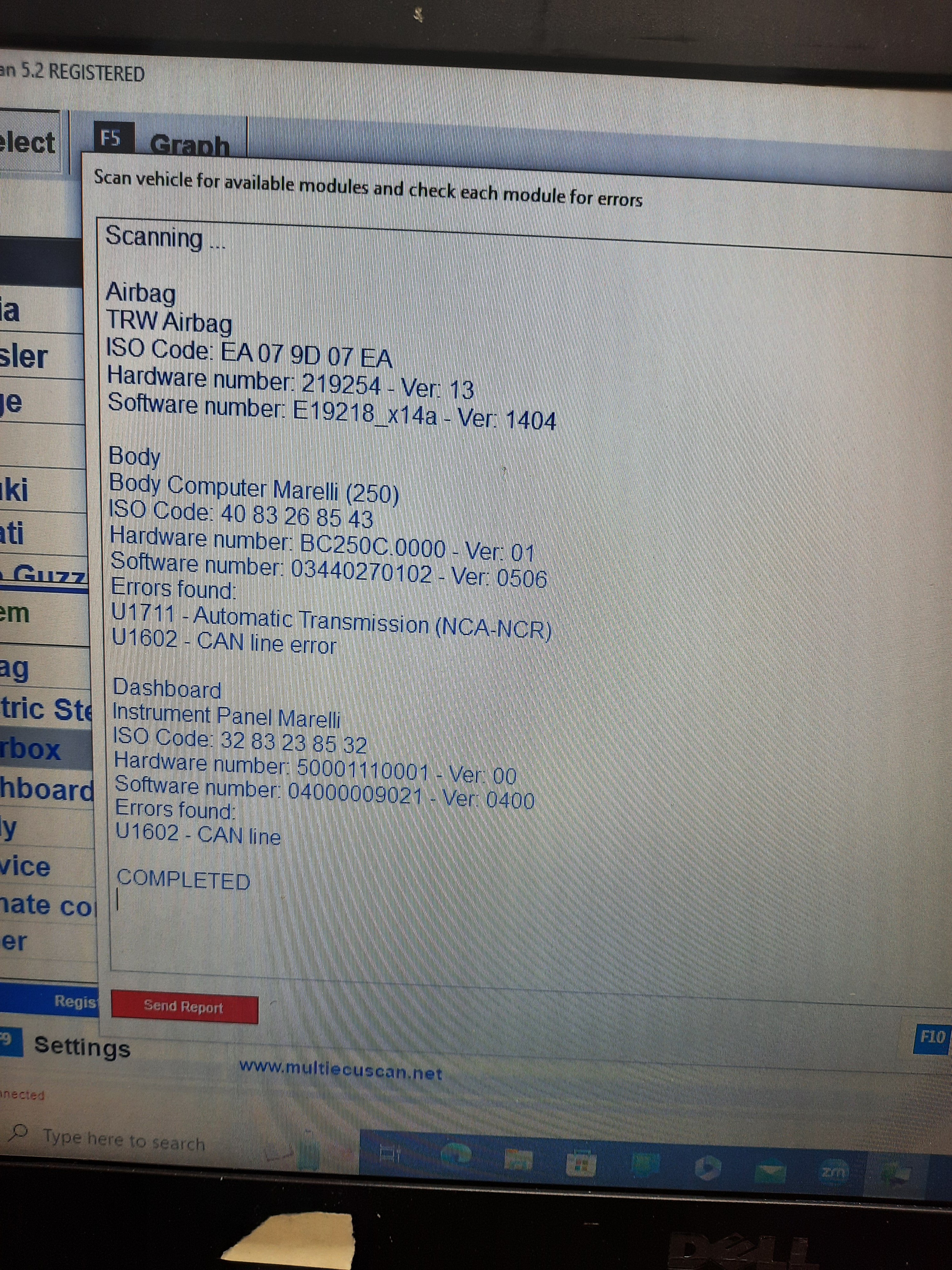

I've not used ecumultiscan before so I'm still learning but I think it should show the gearbox up where other modules are. So there's the airbag, the body and the dashboard but no gearbox. I think that the module listed as body is the one behind the fusebox in the engine compartment
