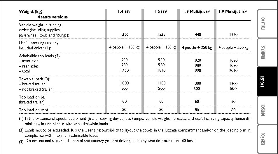

I took a look at my camping gear this morning and decided I can get it all into the boot of our Multiwagon.
But!
All I can find is the volume of the boot space nothing about its weight carring abilities.
"The boot offers a class-leading 510 litres of totally flat floor space, which can be increased to 550 litres if the car is fitted with the optional sliding rear seats"
Our tent is large and heavy. I could probabely park our old Stilo in the center dome of it. Add the rest of our camping gear to it and I guess there's a fair amount of weight to have slung over the back axle.
Any one know or have a good idea of MAX weight that I should be stuffing into our boot?(plus 2 adults, 2 kids under 3 years old and a dog in the main cab) Bit worried about this rear bush problem Multiwagons have. :(

This is from the Stilo Multiwagon & Van Supplement.
Thanks but 860kg is the weight of the car and its load over the rear axle. I was hoping for the MAX weight of just the load that I can phisically get into the boot.

The max payload (including driver) is only 510 Kg so about 20 bags if no one is driving.
:hug:Thanks, just what I needed. (y)
