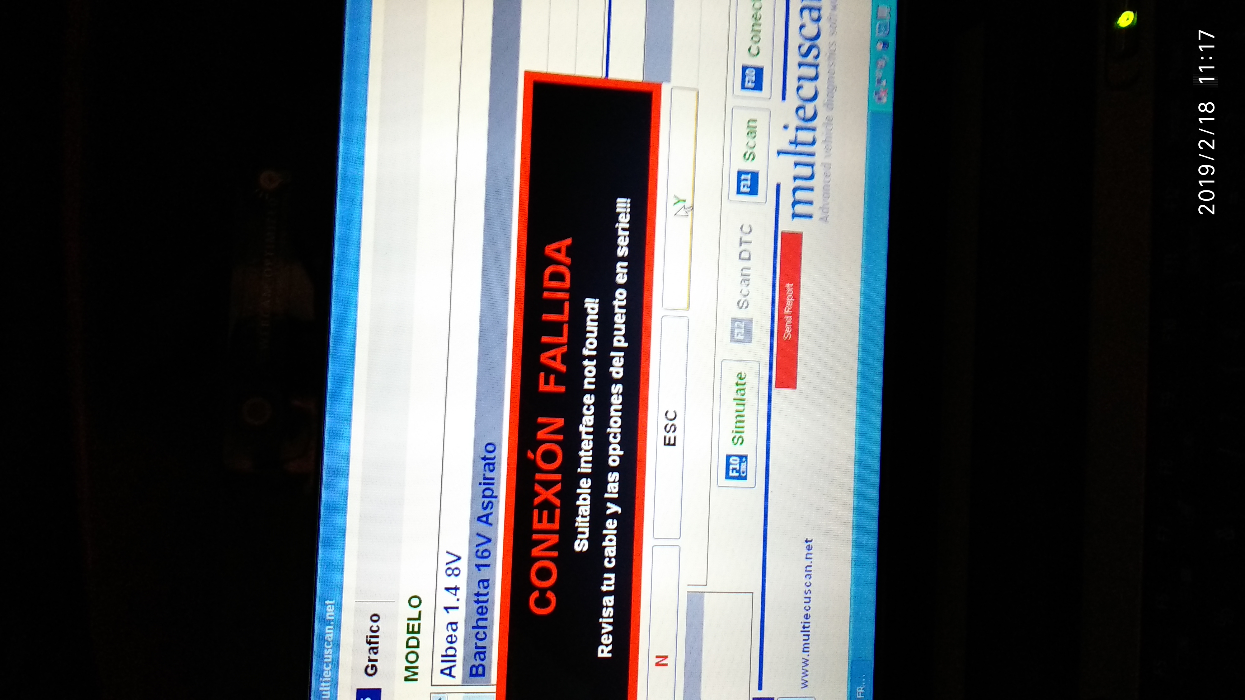

hello I have a barchetta 95, with the free version multiecuscan I can not connect with the ecu injection and airbag of the car, I have kkl cable with 4 positions interuptor and 3 pin adapter. the operating system of my laptop is windows xp, I do not know if the drivers are suitable for the cable, the error message says there are problems with the cable. I would appreciate any help, I have looked in the forum and I can not solve the problem, thanks.

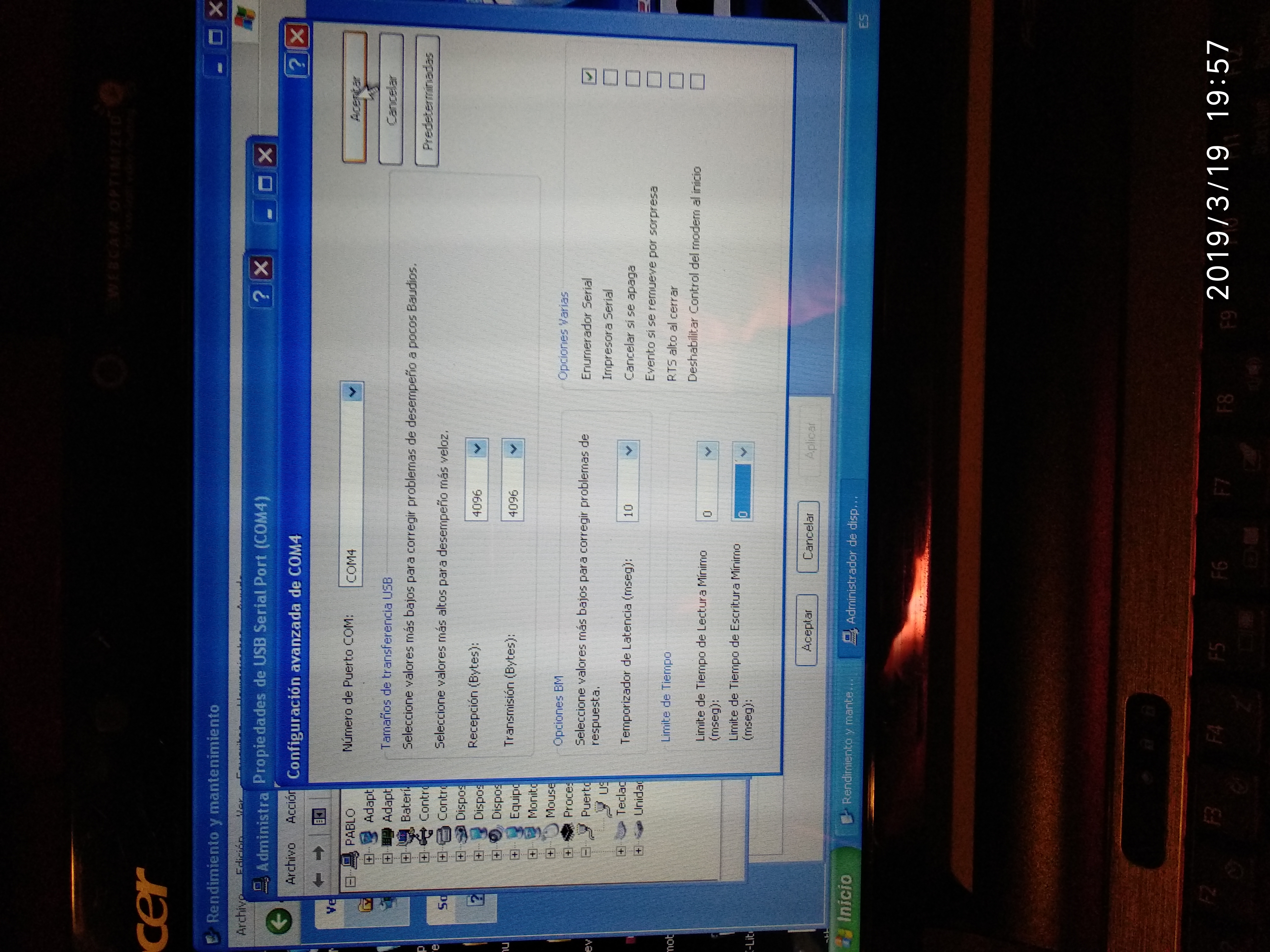

i have both a same kkl cable like that from ebay and i strugle with it for some time . i found out that the comunication port settings where not well configurated ...
go to " control panel" - "device manager" - if you spot a yelow warning sign in the "usb controllers" or in " comports" you probably do not have the software controller installed and you must install/update it ( FTDI controller ) .
next , go to "properties" in the correspondent "usb serial port" , you will find wich one is it by unpluging and plug in the kkl cable ! next , click " port settings" and it must be 4800 bits per second to work ( normaly is set to 9600) alter it !
than you click "advanced" shose " com port number " (com4) and alter the "latency timer" to 10msec (normaly is 16msec) finaly click "ok" to submit the changes , get out and try it , it should work !!
Thanks, i Will try one more time. The kkl red light os on.
Fail!!!

I am working with windows 10 and it works fine ! Seeing the scren pictures it seems to be well configurated you can try to play up and down with the latency value !! With the 4 position selector cable and the 3 pin adaptor the selector position must be allways in the engine position even if you are conecting to airbag or abs ecu only wen you are conecting to a obd2 plug without the 3 pin cable you change the selector for the ecu you want to diagnose !!!
