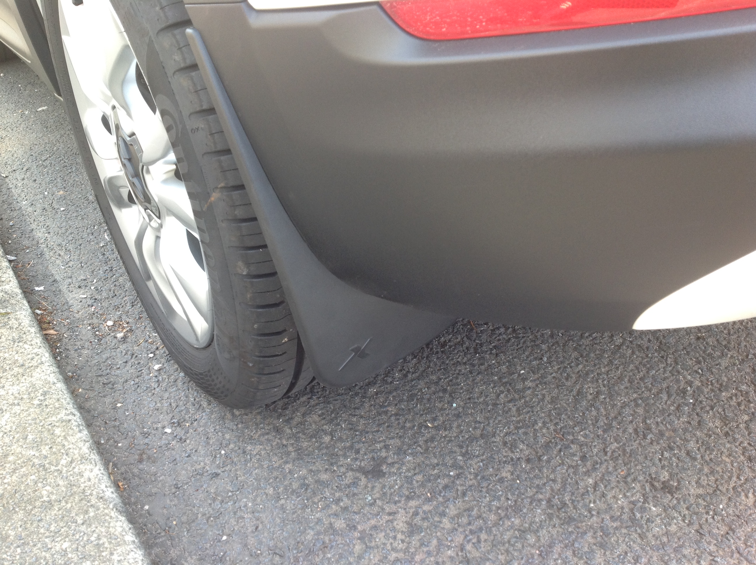

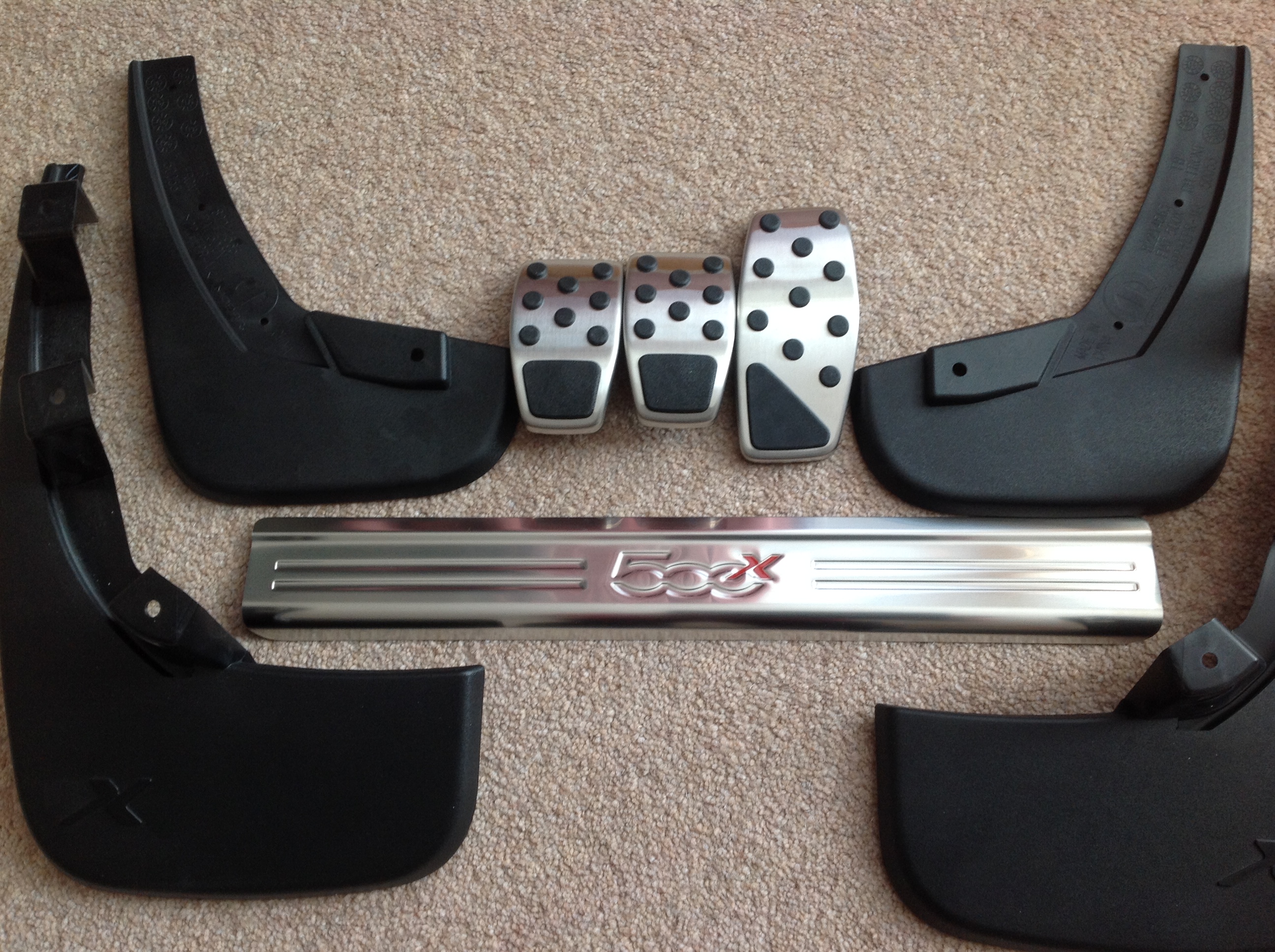

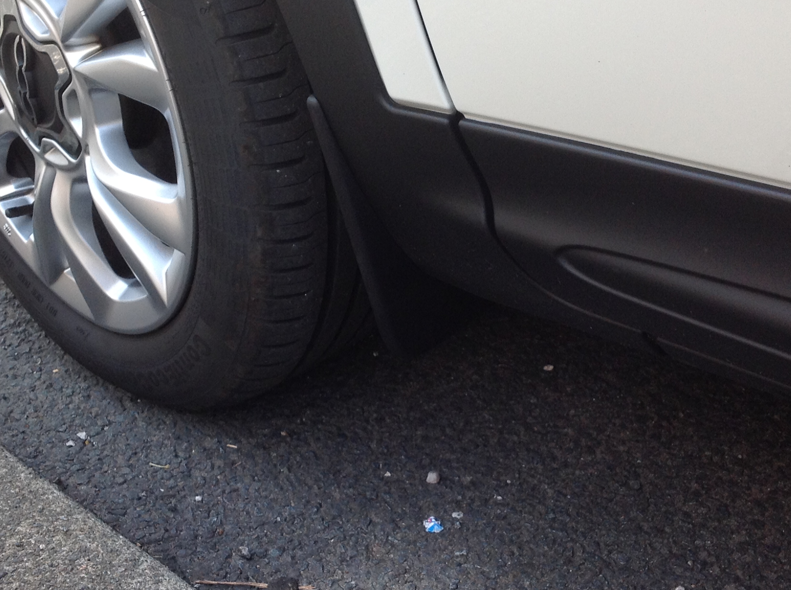

Ok mud flaps have arrived, will get a pic up sometime over next couple days. Back set have 3 locating screws which appear to match the 3 already in the rear arch. Front however need to be drilled and 3 pot rivets inserted.
I also purchased the chrome pedal pack and chrome 500x sill guards, the x is done in red to match the back badge.

Just a quick pic of the items, need to wait until I have more time and patience to fit them.

Those stainless steel pedal covers fit UK cars? How do they attach? I had sport pedals in my '63 plate 500 and I really miss them.
The pedals fit uk cars, if you look at the current rubber pedal covers, at the rear you will see/feel a rubber spike which goes through the metal part of the pedal. The new ones also have this spike. To fit the new ones you must soap up this spike and squeeze it into the hole after removing the current rubber, could be a pain in the rear or simple job!
If you check the MOPAR site, they have both auto box and shifter models.

I believe they fit both cross and city bumpers as pre drilled holes are provided, unlike the stainless steel pedals, they only fit the cross, so any one who wants the steel pedals I'm open to offers?
