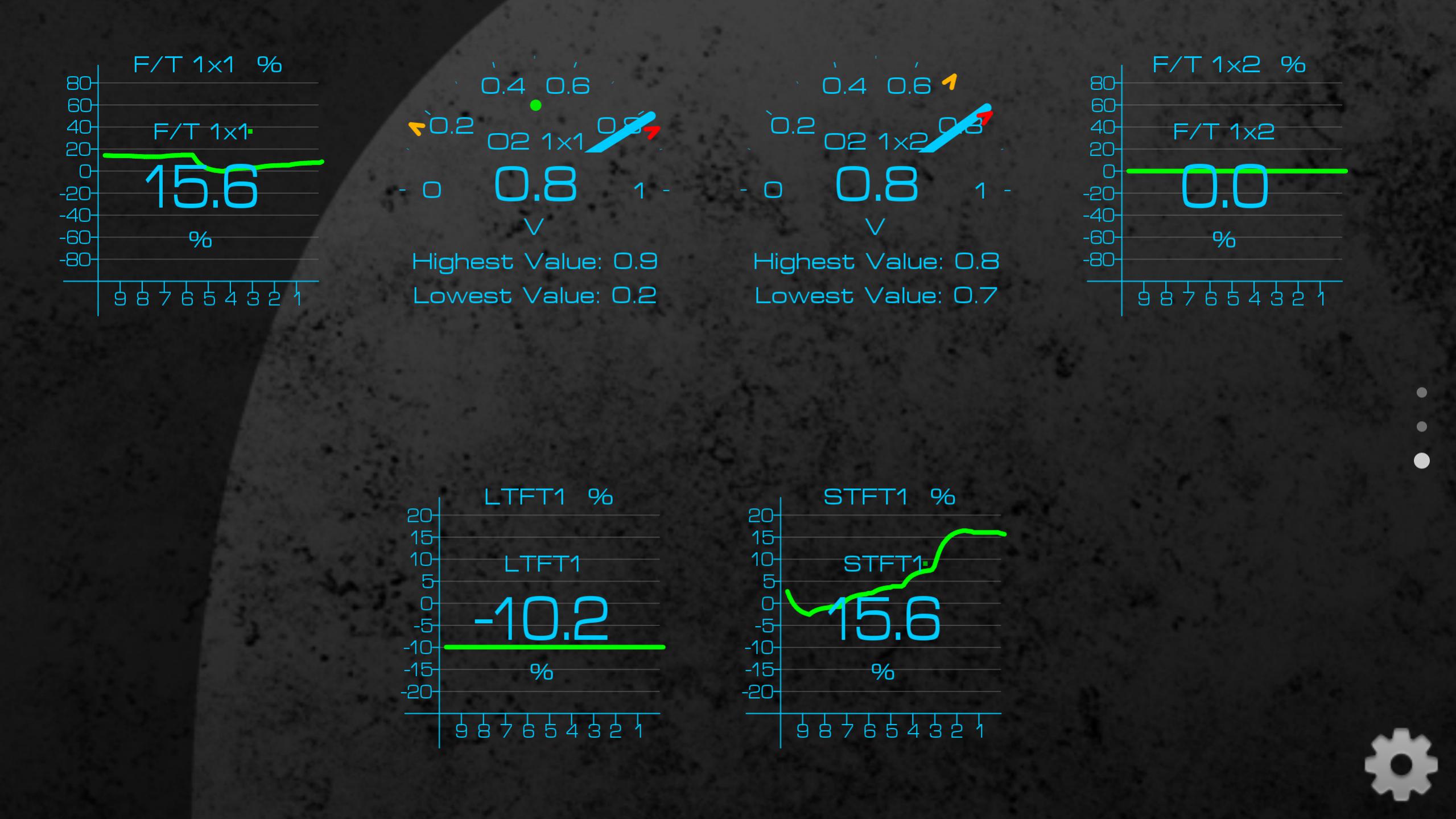

Also screenshot of LTFT I'm pretty sure due to failing precat Lambda and or physical cat damage. Usually peaks at +20-25%... sods law -10 is the lowest I've seen it for a while when hot at idle.
I've reset ecu etc with
Multi ecu scanner 2 weeks ago and now slowly receiving better
