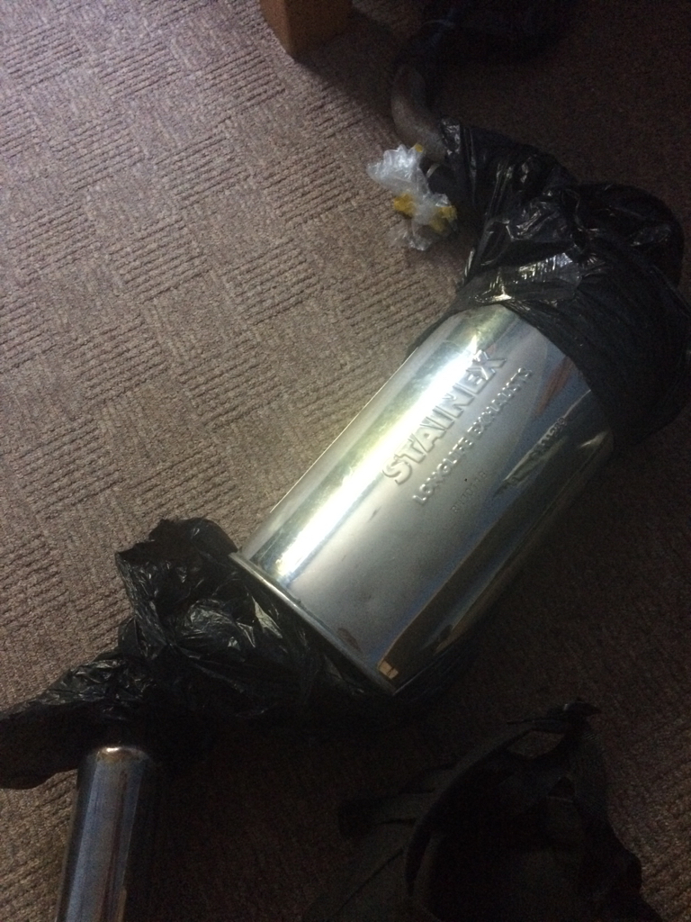

It is mpi engine, I already have K&N Apollo induction which should be decent and also I have stainless exhaust which should give extra bhp. So I ain't sure ImageUploadedByFIAT Forum1432665062.346431.jpgImageUploadedByFIAT Forum1432665072.483016.jpg

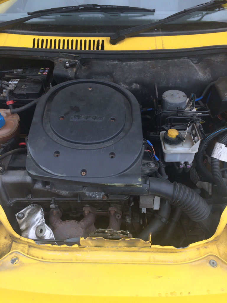

Well some people told me it's mpi so I ain't sure now. Have a look at the engine pal ImageUploadedByFIAT Forum1432665218.999637.jpg
You have a Euro3 type Ecu which are fussy to changes in engine mods due to the stricter emissions. You will hit a wall with regard to the engine management light and power with major mods to the engine.
An 866 Cam is a good mod but the Ecu will not like it and you will have power fluctuations depending on how the Ecu feels.
The Plastic inlet manifold is restrictive and will be a limiting factor for power.
A Supersprint exhaust manifold is a good thing to have and produce more power than a back box, but is linked to the fuel/air supply to the combustion chambers.
I have a Euro5 1242 engine with a 40mm TB and standard Seicento inlet manifold that has 60Hp running on an Omex Ecu.
Best Bhp per pound spent is the 1242 16v engine with It's factory Ecu.
