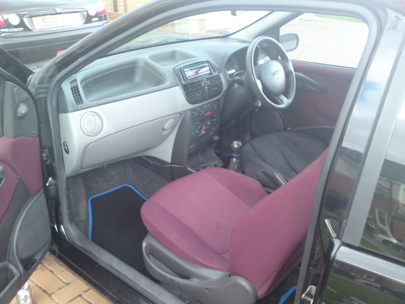

Alright guys, i have a punto mk2. The interior of the car is a red and i dont like it. As the good weather is coming in i am looking at doing a few mods to the car. First l I would ike to change my interior. Is this possible to do and if so how can it be done ?,Can i buy new interior from shops if so could someone leave a few links. I have posted a few pictures of the interior seats and door panels. The oustide of the car is black, and the red inside just doesnt go.

im just looking to get rid of the red seats and the red on the door's. im happy witht the plastics and the dash as it goes with the exterior of the car.

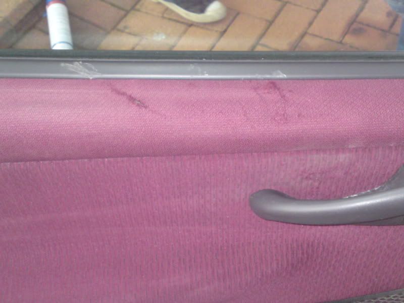

The red door cards would have to be replaced with a model-specific door card. I'd again do a swap from another Punto and fit them on.

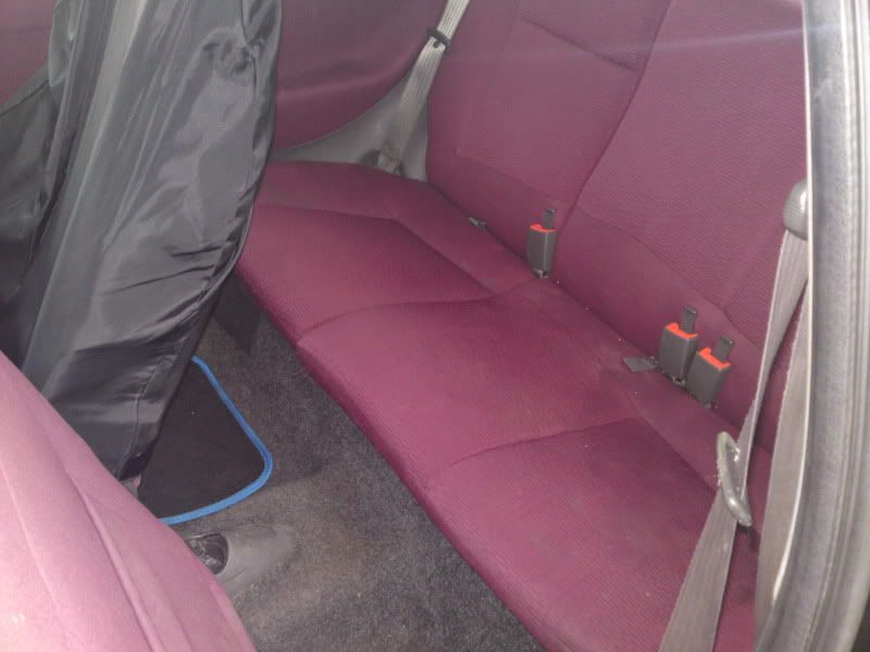

Is it easy enough to take the back seats off ? i was having a look under them today but coud not see any way of geting them off. hopefully im able to do a straight swap its just the colour i dont like thats all.

To remove the rear seats, I'm guessing you have to slide the seats forward (as if you were folding them down) and there's bolts under there.

If your rear bench is a one piece bench and the one you are taking has a split rear seat (so you can fold each side down independently) then you have to take the bracket too. Otherwise the seats won't fold down properly.
So basically take all the fixings aswell as the seats from the rear bench.

thanks for that one mate, checkd the seats today and thats the case. got them stripped out and ready to go.
