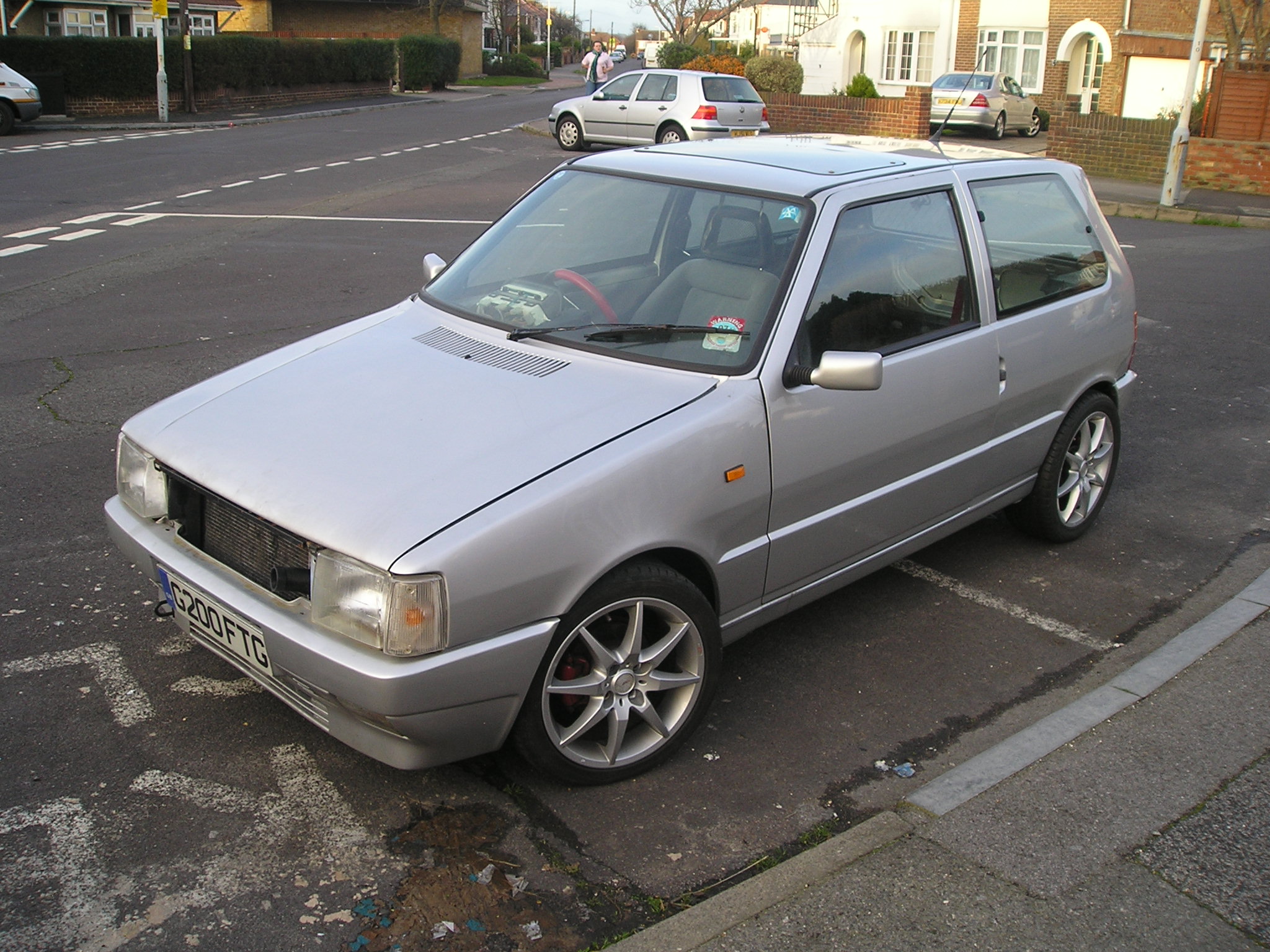

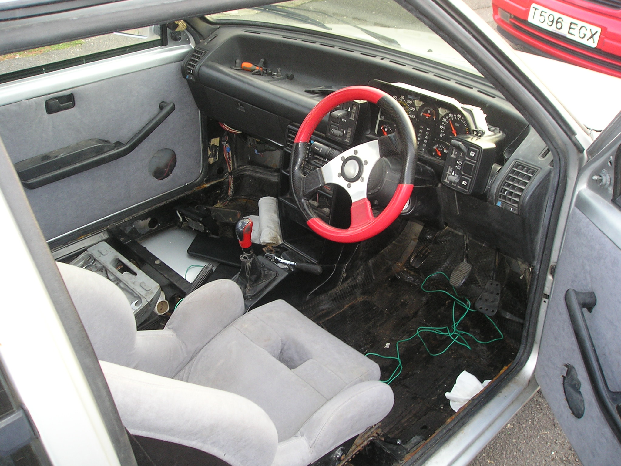

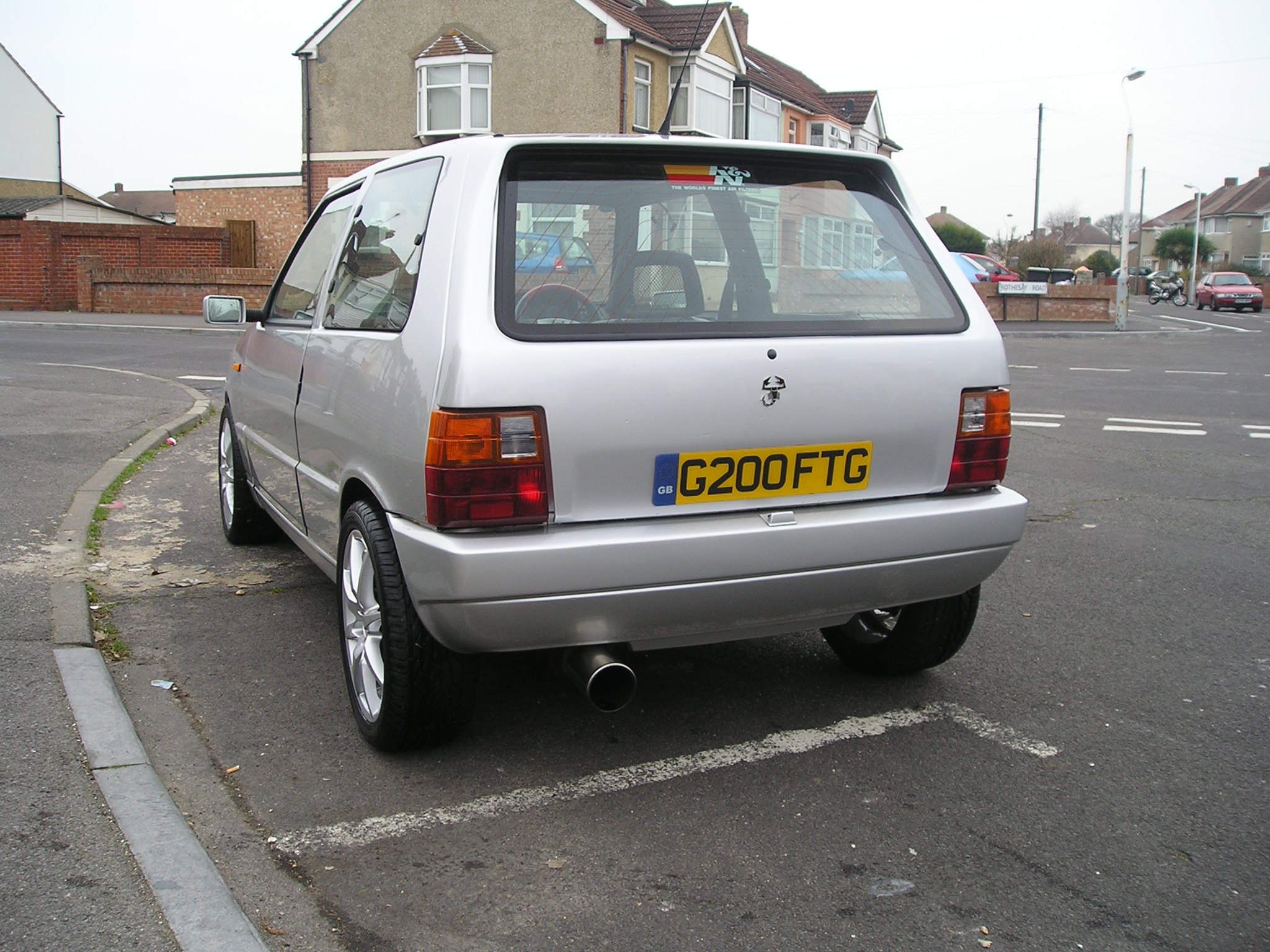

well after months of saving and waiting i managed to get my uno turbo from yeovil to my home in gosport.when i bought it it was full of water and a bit of a mess.but as it only cost me £400 and its quite rust free i couldnt complain.the idea at the moment is to strip it out further as it didnt have much interior when i bought it and quater mile race it this year at shakesper county raceway.the problems list with it though is quite long,
no brakes (well not very good)
only dials that work are fuel and boost
idles high
timings out
gear change rough
only has 1 wiper speed
boot wont stay open
window motors are really weedy
grill needs sorting
and just a general tidy then tax and mot.even in its sorry state i took it for a quick blast down my road and i was amazed at the pace :D ,ive driven some fast cars but for a 1.3 the uno is amazing.after ive set it up properly and got it all running standard the modding begins.ive already got a hybrid turbo for it but really want a performance cam and uprated fuel pressure regulator amongst other things.will try and make regular posts and keep it interesting.many thanks,Dave. :slayer:

Cool, is it a real UT or a reshell? The door trims are not UT look like a base model or something like that and doesn't have the arch or sill covers. The seats a Recaro from a Strada Abarth and they are great so that's good.
Have a good look for rust on the floor definately some appearing there. Looks like a bit more work and it'll be tidy.
Great choice of project! (y)
Someone's retrimmed the door cards for that 'clean' look, which is OK. Lots of potential in that bodyshell (looks better than other Mk1s I've seen in England!)

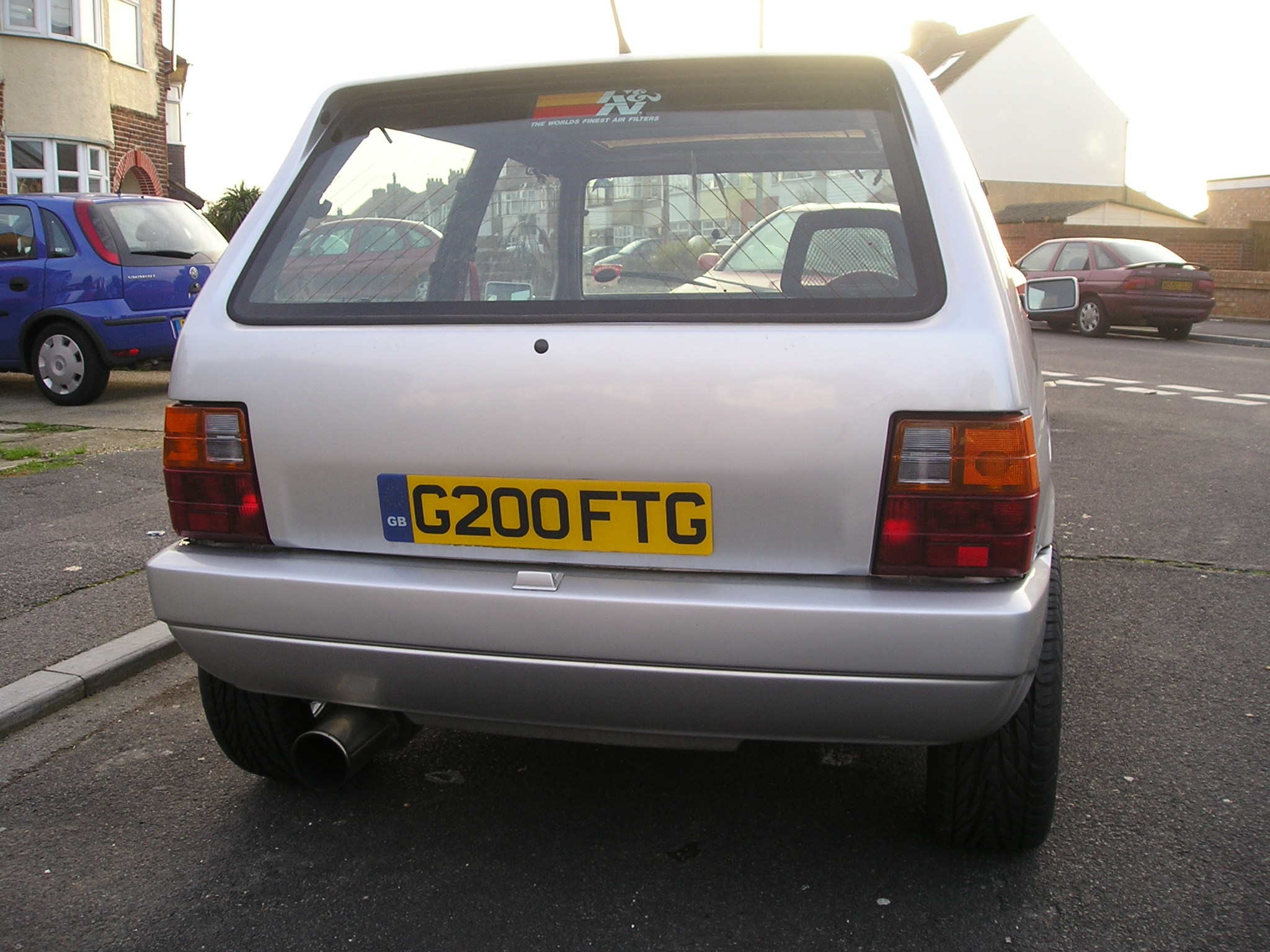

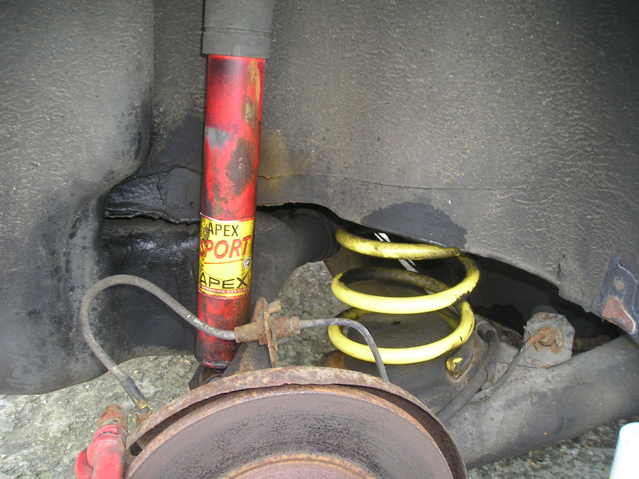

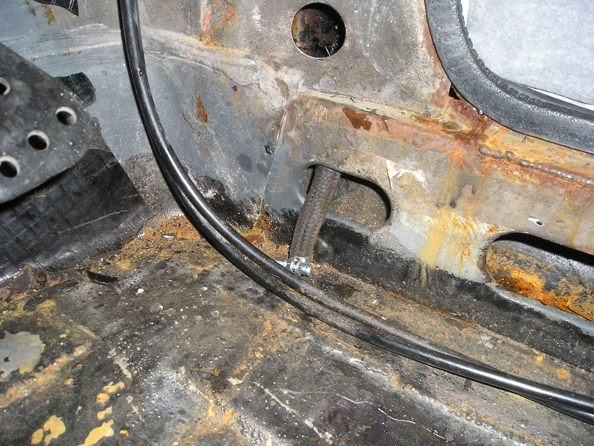

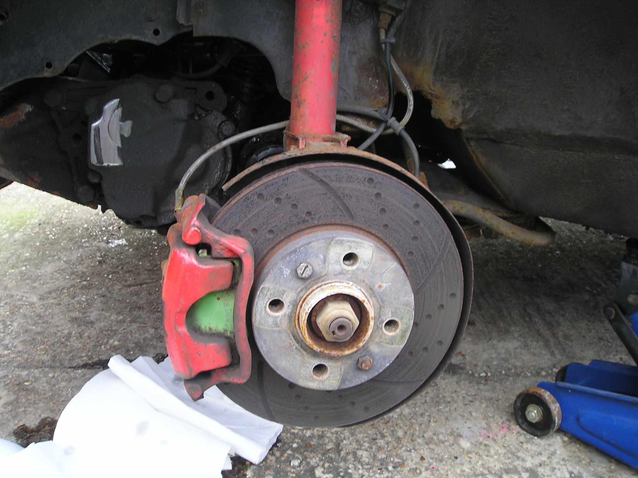

well the project is a bit further on now.managed to sort out the massive leaks in the cabin.re directed the water straight from the sills via some tubing through the floor.works a treat.also when bleeding the brakes today i noticed that the car is fitted with apex sport suspention and lowering springs. it also has braided hoses, grooved and drilled discs and green stuff pads on the front.i know it was in a sorry state when i bought it but it did only cost me £400 and i think its worth every penny.ive included some more pics so feel free to comment or leave more posts.cheers,Dave. :slayer:
