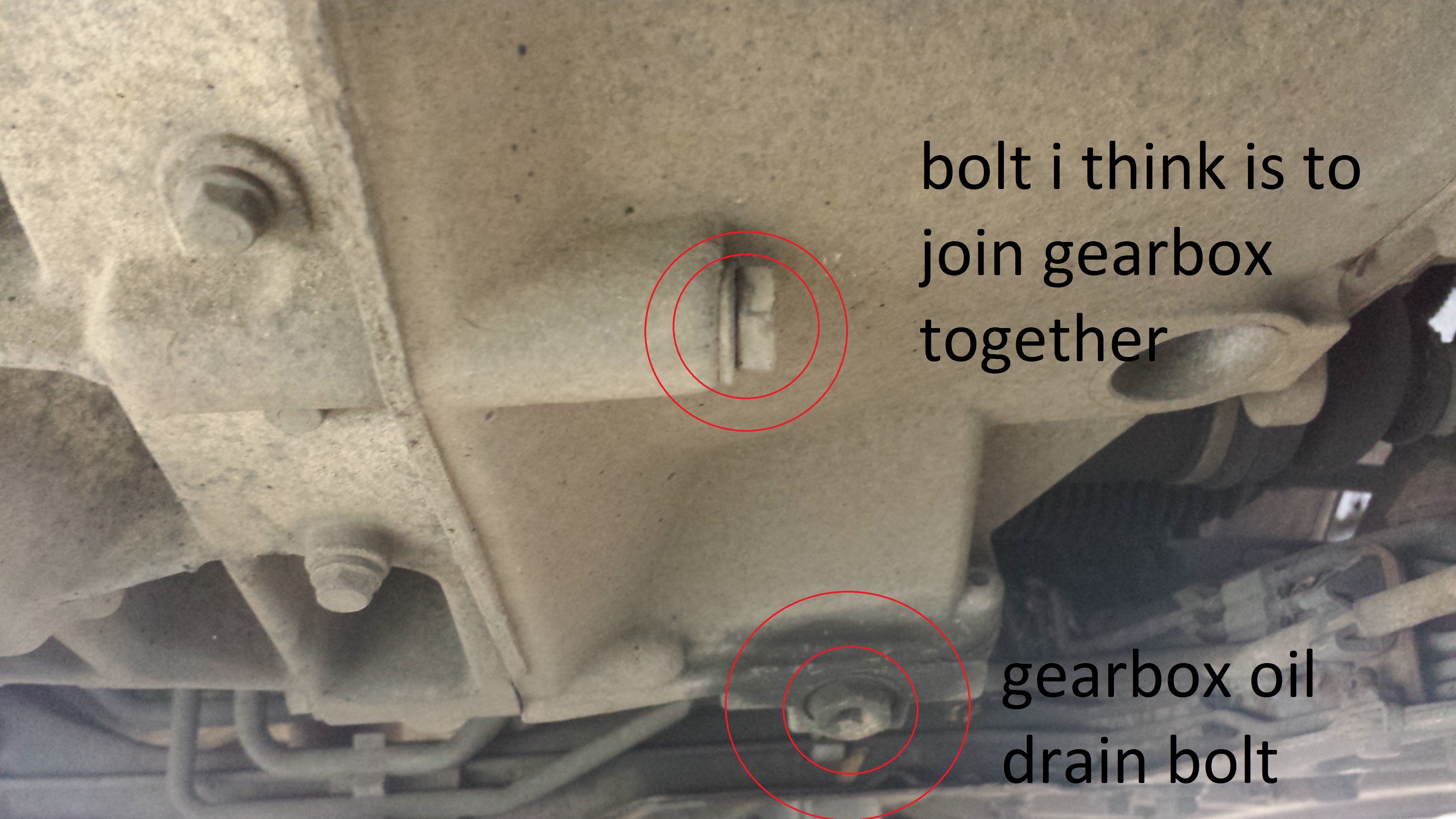

hi, im having trouble locating the Gearbox oil filler bolt to top up the oil(if needed)
has any one got any idea's , ive inc pics
think ive find the oil sump bolt that i dont wanna touch and the GB oil drain bolt, just cant seem to find the filler bolt

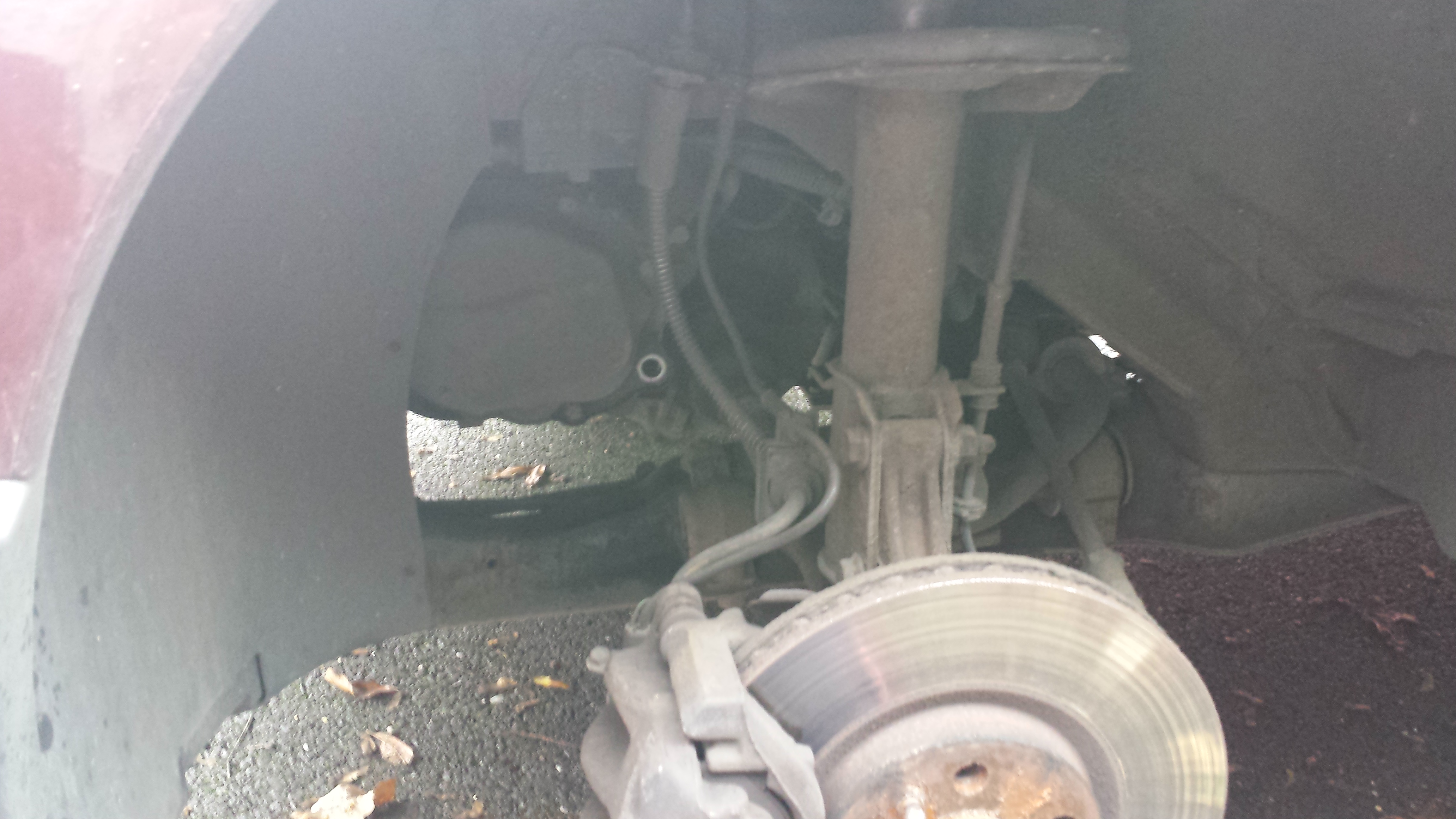

I searched the internet, i asked people, and having no luck, i finally found the answer from a 18 year old kid after he looked under my car for 5 secounds
the filler bolt is located on the right side of the gear box, by removing the wheel you can access the bolt very easily. it holds about 2 litres.
