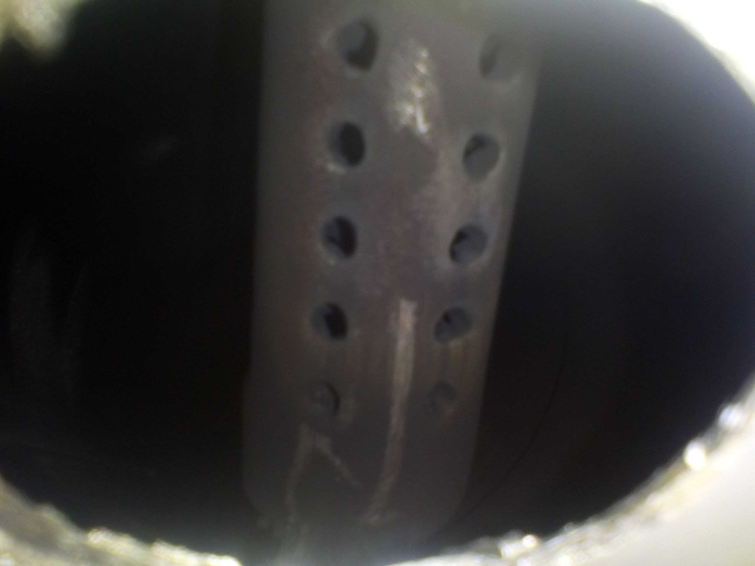

Ok so no dyno test my wife was not happy with the sound so I have been side tracked trying to make it quieter.
The sound level when first installed was ok but within 1 hour of driving it was louder and after 5 hours too loud to hear the radio when going up hills or pulling a few revs.
I tried a baffle on the exit with no real success so next was muffler surgery.
When new a fiber optic camera down the pipes showed the became perforated once inside the muffler and then continuing around a bend the camera could not go round. There was also signs of white fluff (fiberglass packing) coming through the perforations.
Suspecting the fiberglass had already blown out I cut a hole and repacked it with stainless steel wool scrubbing pads. I only had about 10 but tightly packed it best for sound absorption.

The result is good, it is now about the same sound as when first fitted.
Next I will remove the db killer that came in the tail pipe and replace it with a packed straight through insert. And at the same time make sure the packing i have already inserted can not block the internal entrance to the tail pipe.
