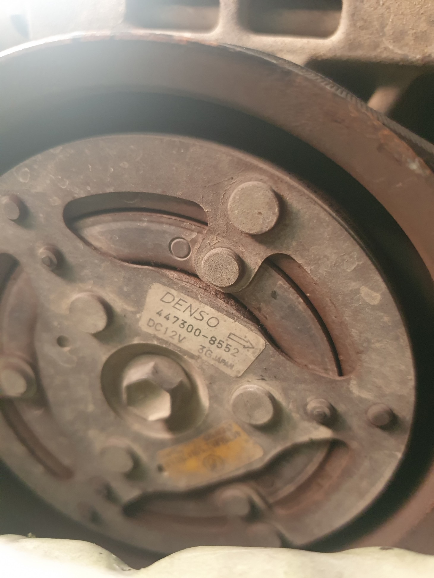

Hello,
Spring is warm here in Toulouse, and I've started using the air conditioning on my 2005 Doblo 1.9 JTD.
The air conditioning works quite well, but a metal-on-metal rubbing noise can be heard when the following conditions are met:
  1. The air conditioning is on
  2. The car is moving
  3. I turn left OR I start moving
No noise if the car is stationary, if I turn right, if I'm driving straight, or if the air conditioning is off.
I looked for signs of rubbing around the air conditioning pump, but found nothing.
The accessory belt and tensioner pulley are new.
Does anyone have any idea what's causing this strange noise?
