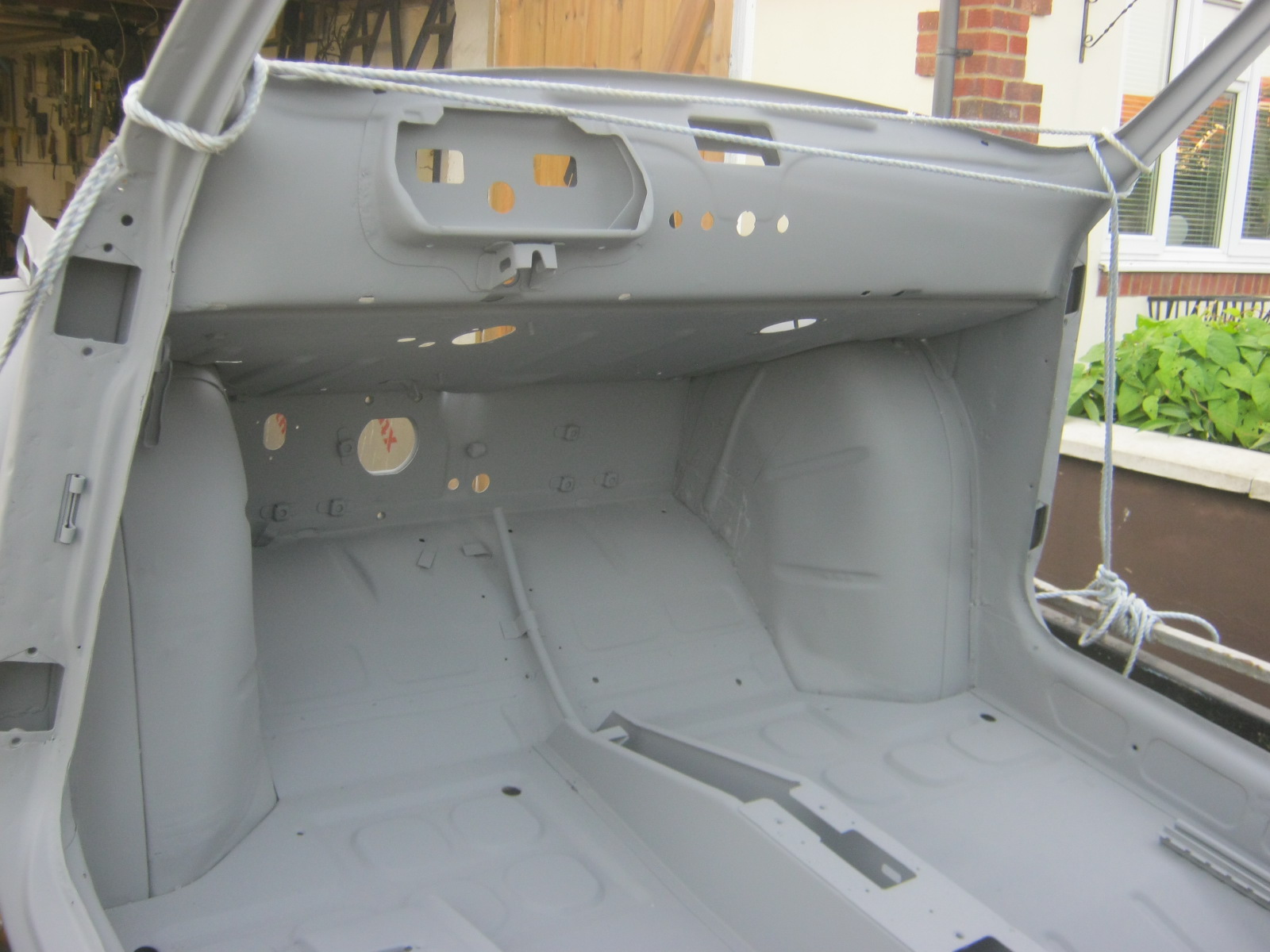

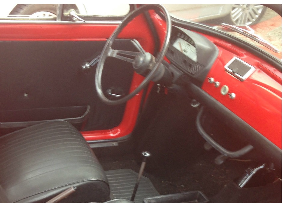

AND..... something a bit more radical which has had me thinking for a while is, 'what is underneath the plastic dash in the L?'
I can't understand why they did away with that lovely metal dash for the 'lusso' version.
I guess if I'm being honest I would actually love to own a Nuova, The metal dash, round speedo and the lovely metal badge on the rear.
But I own an L, so that's that. I do love the chrome on the L and I suppose there's more to life than a round speedo ;) ......(is there???)
But whilst researching what else I could add to my little motor whilst it's away,
(Don't worry, I'm sure it'll stop as soon as I get it back, and I probably won't even manage to bring myself to drill in the cradle for the radio)
I spotted this motor!
Do you reckon the same is under my ugly plastic dash?
Is it fairly easy to remove to check?

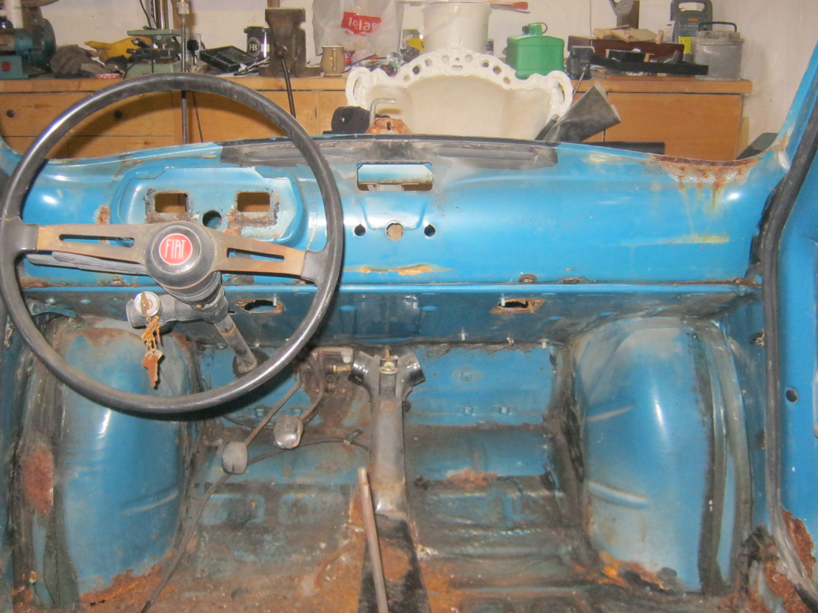

Yes yours will be the same underneath however the black section has been painted as it is usually all the same colour underneath. I too am undecided as to use the black plastic dash or leave it exposed if you know what I mean!
It has the old look but with a more modern dash.
What do you mean by the black section Franko? The bit with the air vents and ash tray in?
Does that mean all of that is metal underneath too? Would probably need to keep plastic round those air vents, but could get rid of the rest of it?

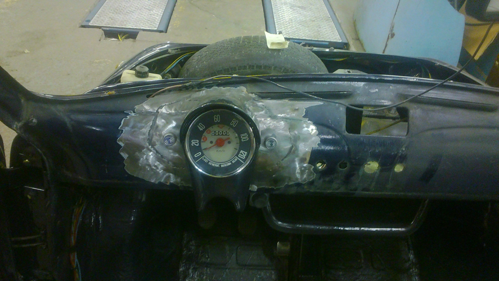

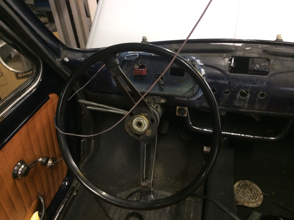

I decided to go both feet in with this removal of the L dashboard thing.
Got the plastic off and lo and behold (like you all informed me!) was that lovely metal dash, with the stepped profile too. What a lovely detail to cover up with some horrible black plastic.
Once that was removed I had planned to put the original speedo back on, I couldn't possibly stick a round one on.......could I?!?!
After much internal turmoil I came to the conclusion THAT:
I had always wanted a round speedo,
I was never going to own 2 500s so may as well own the one I want
I never bought this to sell on, so I should please myself
(AND....Should have probably bought an F ;)
So, I spoke with the lads down at Motobambino who could do the spot welding for me and 'voilà'.
It's not finished yet, and will need to go in the paint shop.
I must admit that it posed an almost 'test tube baby' moral dilemma and I've decided to remove the L badges on the front and back.
I hope the Fiat gods will turn a blind eye and appreciate that they themselves went a bit off piste with the L dash, noticed the error in their ways and returned the metal dash with the R ;)

Mark at MB has the tell-tale and (is it) full beam ? light for me, then it'll just be a question of stripping the plug that is there and wiring in to the back of the speedo for the oil lights etc...
