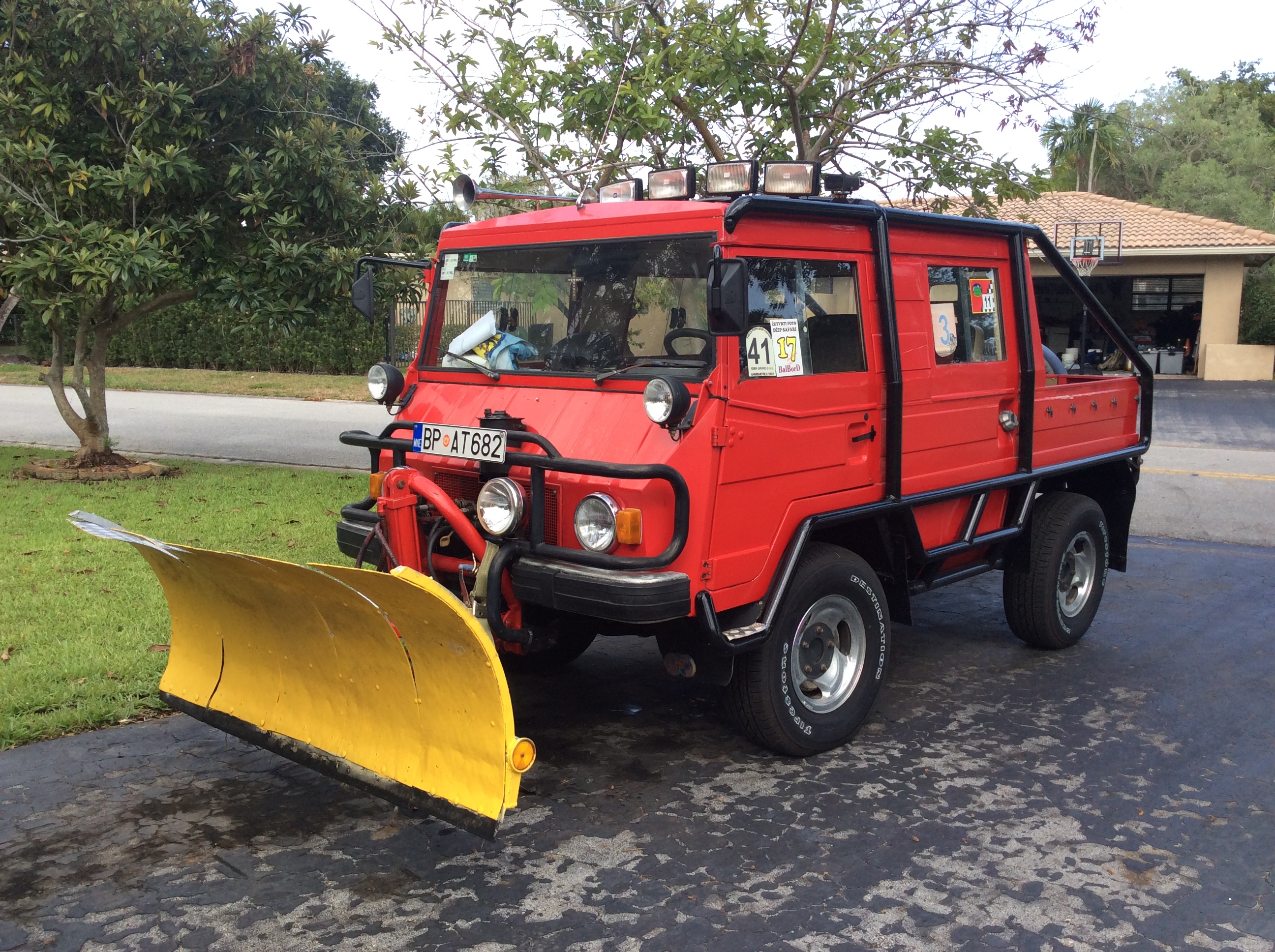

I will start working on 'Mad Iris', the Pinzgauer with an early Fiat Croma engine.
Brief:
The truck was imported from Montenegro to the USA. No records and no maintenance done in the recent past. AFAIK, Pinzgauers did not come with Fiat engines. I am guessing a passionate person did this combo. The reasons I bought - a joy to look at the engineering that went into Pinzgauer. I also believe old soul sometimes needs a renewed spirit.
Challenge:
Fiat Croma 154 was never sold in the States, so no support whatsoever. Pinzgauers have good enough support but with the weird combo, there are many unknowns.
Current State:
Vehicle: 1983 Pinzgauer - highly modified

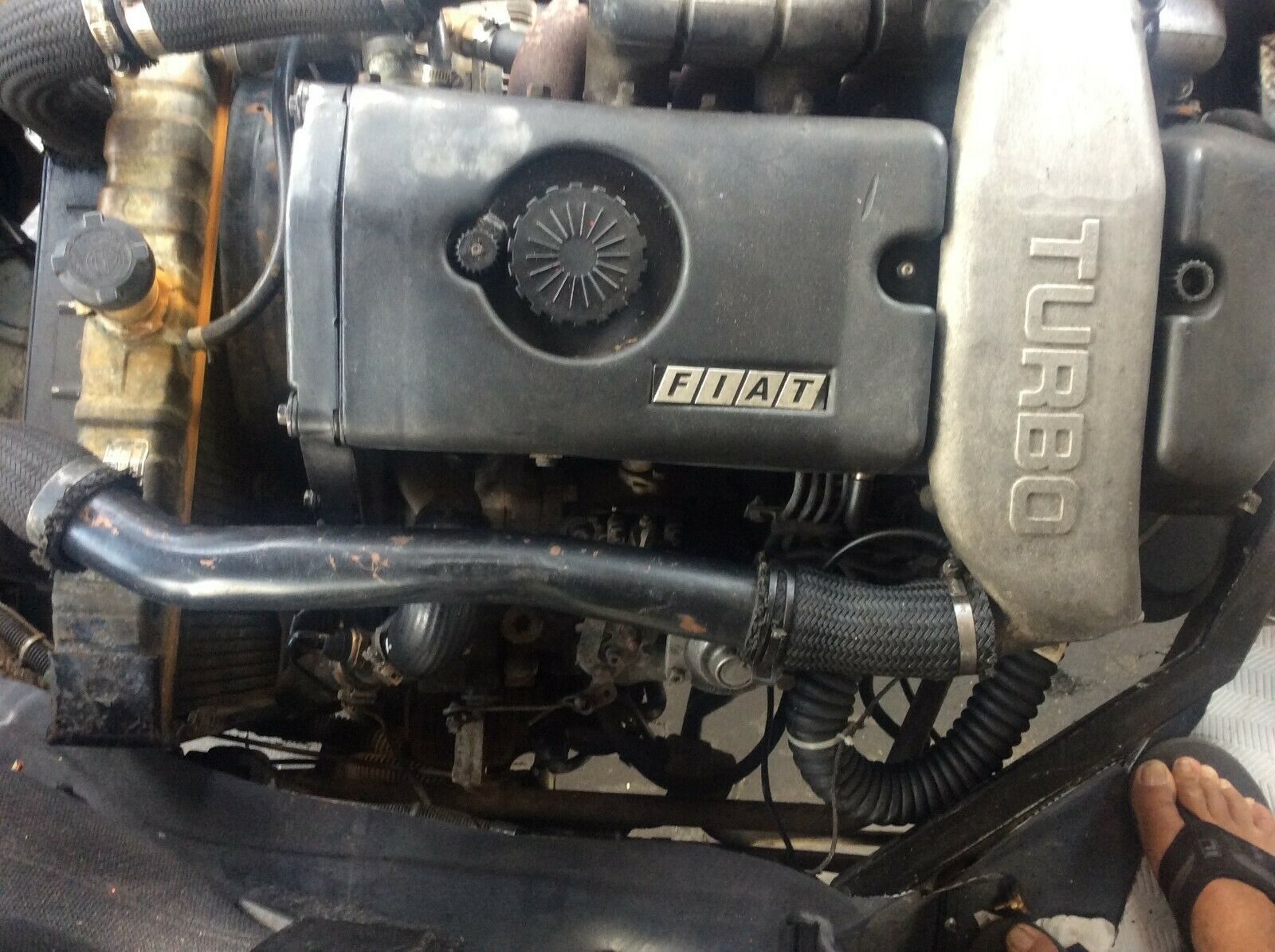

Engine: Good folks on this forum helped to do initial identification. Guess is Early Croma 2500cc turbo diesel engine (Type 8144.91 | Version 154 AF 55 A)
Transmission: Standard Pinzgauer (again a guess)
Immediate list:
Current Pictures:
