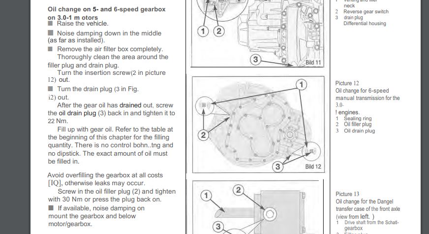

If it's definitely the M40 then drain point is lowest point on the gearbox diff housing, hex socket, it has a magnet attached inside. The fill point uses the same hex bolt/socket but without a magnet. It is located at the front of the gearbox about two thirds of the way up and is best undone from below, it is located just above the reverse gear sensor and I found it easier to unplug the connector from this sensor first to improve access. Filling, I use a long tube and funnel from above. 2.9L of GL4 75W85 or nearest equivalent. Hope this helps

Given that pictures are often worth a lot of words, the following (specific to the M40 as originally implemented in the earlier 3-litre versions, but unlikely to have changed much) may help:
The first (though with fairly indistinct pictures) is from the translated maintenance manual available in the download section,
The second is from the Ducato Training Manual (Second Phase) which is an addendum for the 3-litre engine, and that particular second one I can't find in the downloads (I'll do a re-check, and if necessary get it uploaded).

Edited to add: The "Fiat Ducato Training Manual" entry on downloads has two downloads, this is in the second of those.

Pretty sure not, I think the fill hole is well above the oil level. Just get gearbox warm before draining and then refill a measured 2.9L
