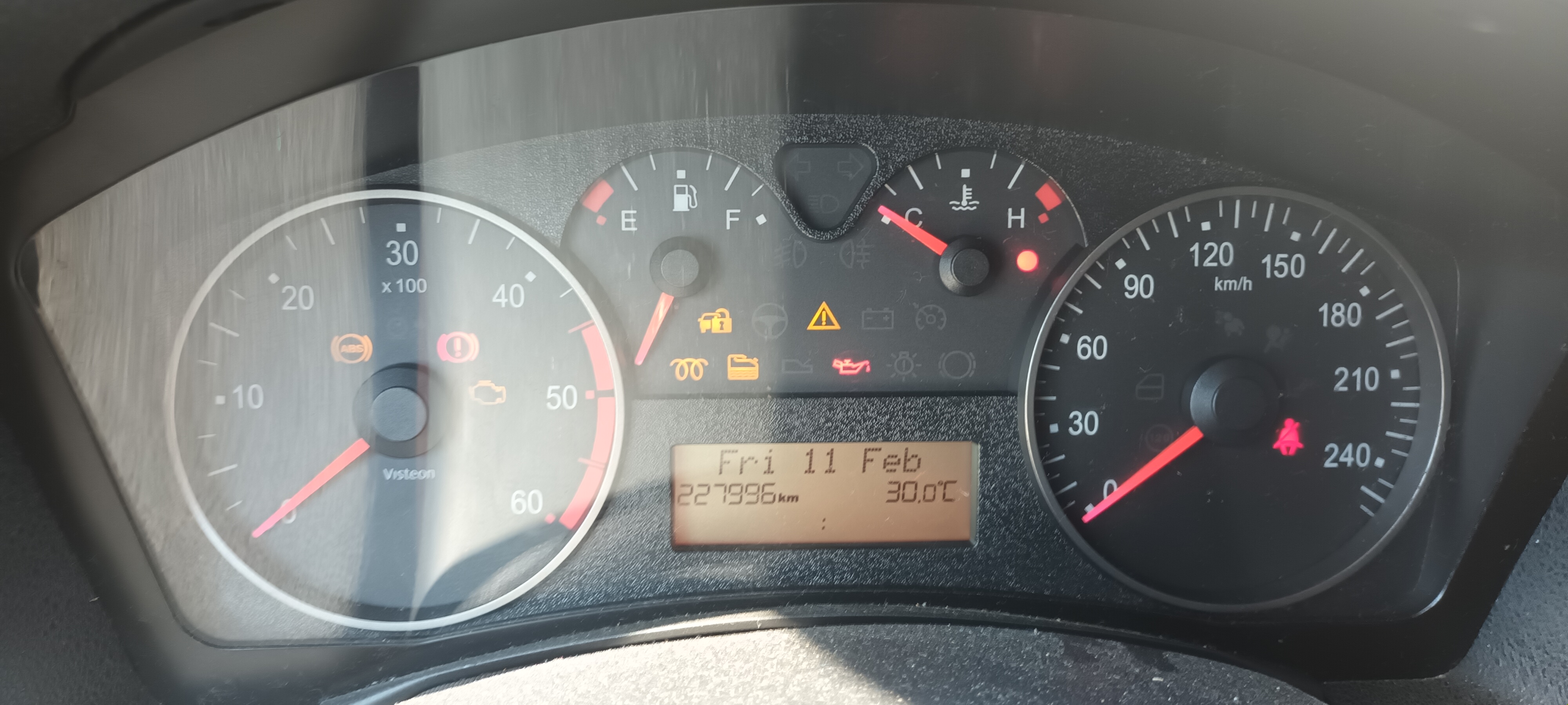

hi, my stilo 1.9 jtd was at the electrician's because it didn't want to start and it showed a message - lost connection - when he returned the car to me, I don't know what exactly he was doing, but the car now starts and I have the same message and situation as in the attached picture, that's when the car is running... what should I do, I don't trust the mechanic anymore, it cost me a lot and he didn't fix it...

Did your fuel gauge always look like that, or did it start when this problem started?
You *could* just check the earth from the battery.... (attach a big strap from negative pole to the gearbox).... but "Lost Connection" and all those warning lights looks like a console problem. Mine lasted about 125,000 miles.
Usually it's a burnt track in the PCB behind it... which a normal ECU repair place would be able to fix. It's not a mechanical problem, if the Earth is okay.

Bok,
brojilo je prije tako pokazivalo, očitao sam sve polove, plus minus, inače je auto bio odveden na električara jer nije htio upaliti, sad pali ali sve svijetli, probao sam i drugu instrument tablu, sve je krenulo ovako
