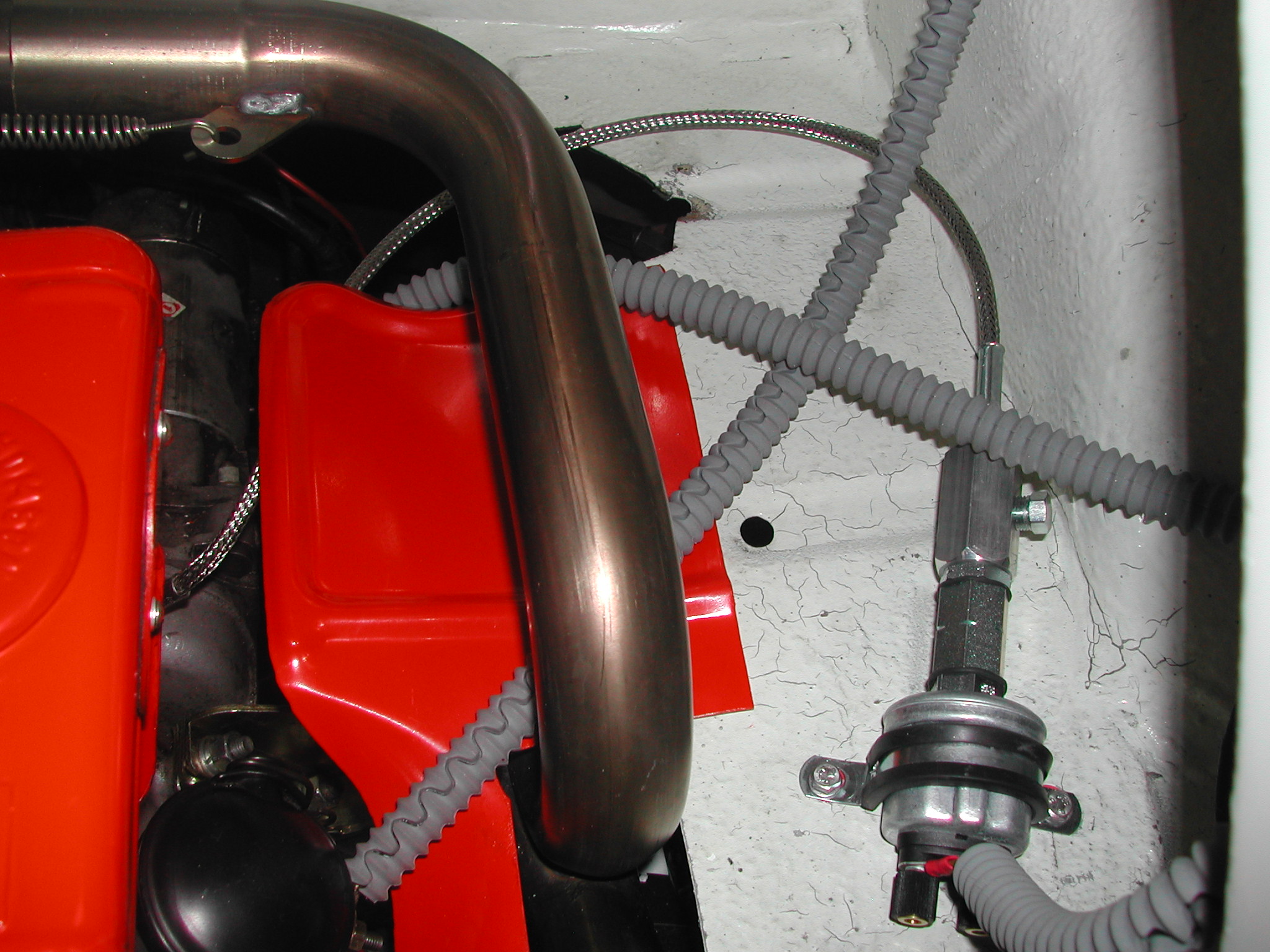

IIRC I get a constant ~4 bar, with no noticeable drop when hot. I used existing outlet, with switch and sender mounted on the rear bulkhead. Here's a pic of when I first installed engine...
Looks like a neat set-up Steve. I might relocate the switch and sender away from the heat of the exhaust and see if that makes a difference.

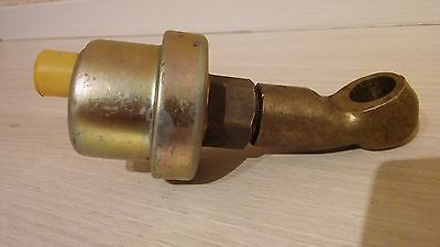

Oil pressure assembly is really clumsy and i recently found out its a 128 rally - Veglia sensor in combination with a oil pressure sensor that has extra long thread to fit.
Silly i thought and removed it and replaced it all with a single original oil press sensor resulting in no press indications at all !
Ok so put it all back together.
My oil press gauge is graded in ATM ( Not sure if this is original or 124, Lancia or even Alfa )
Cold engine 40 ATM, but when warm ( 110 - 115 celcius ) i get barely 10 ATM.
On idle low press light and my heart both flickers....
Any suggestions ?

According to 'the book of words', the oil pressure light can flicker (safely) when engine idling--hot, as long as the light goes out as soon as you rev the engine. If in doubt as to what the gauge is actually showing, my advice would be to get a correct, matching oil pressure gauge and sender.
