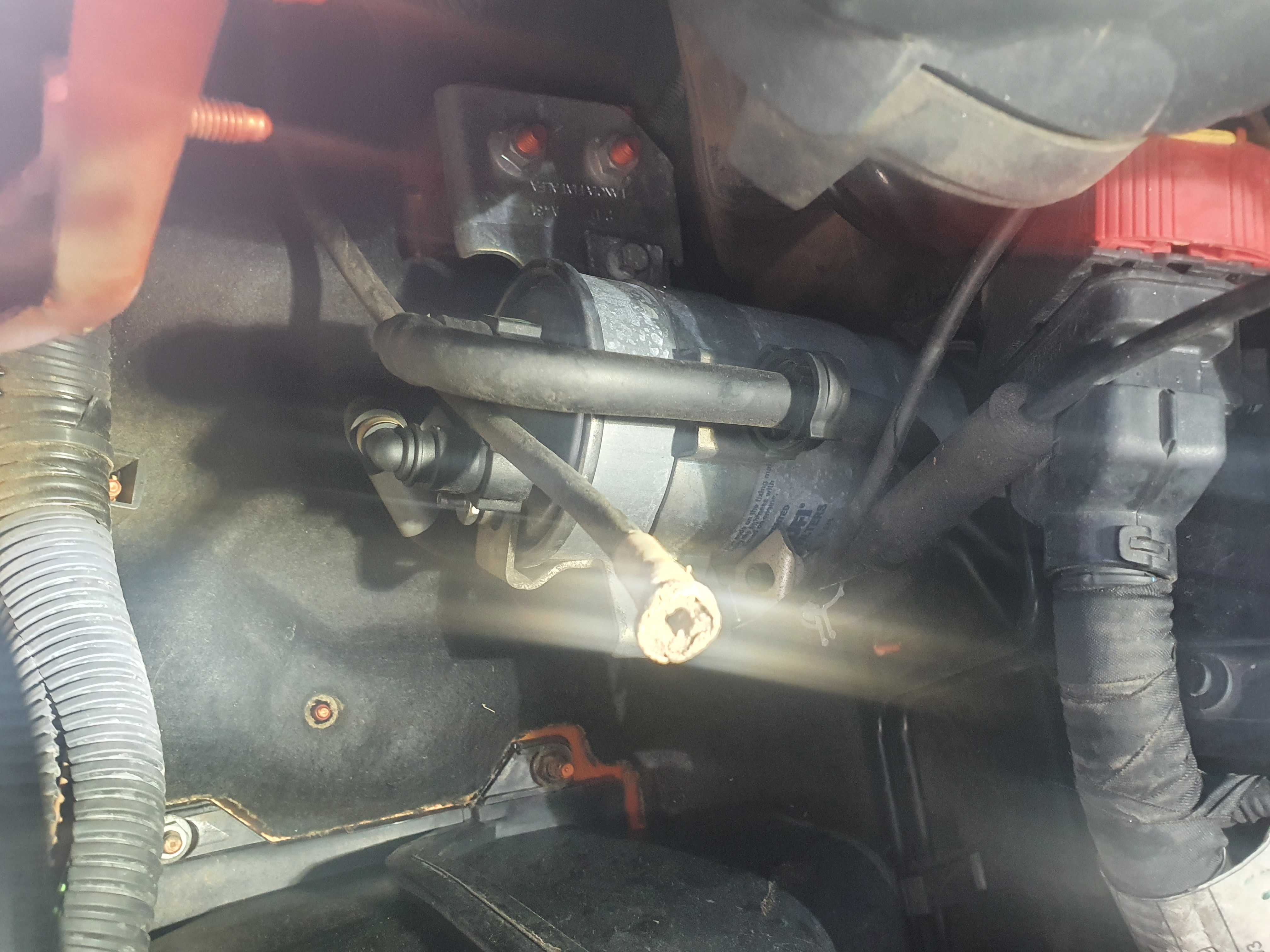

Hi, can anyone tell me what this loose rubber tube is for and where it should go? It's location is on the passenger side of the engine bay and it seems to head downwards towards the front wheel housing somewhere. Thanks, Allan

If its a thin one , could be out of the wiper spindle surround [ the one that always leaks ] this is probably one of the 2 drain tubes , should snap into the plastic moulding , until they age and fall out or to pieces .
Hi, yes you are right, it turned out to be a drain tube from below the windscreen that had come lose due to perished rubber. Thanks for the feedback, much appreciated.
