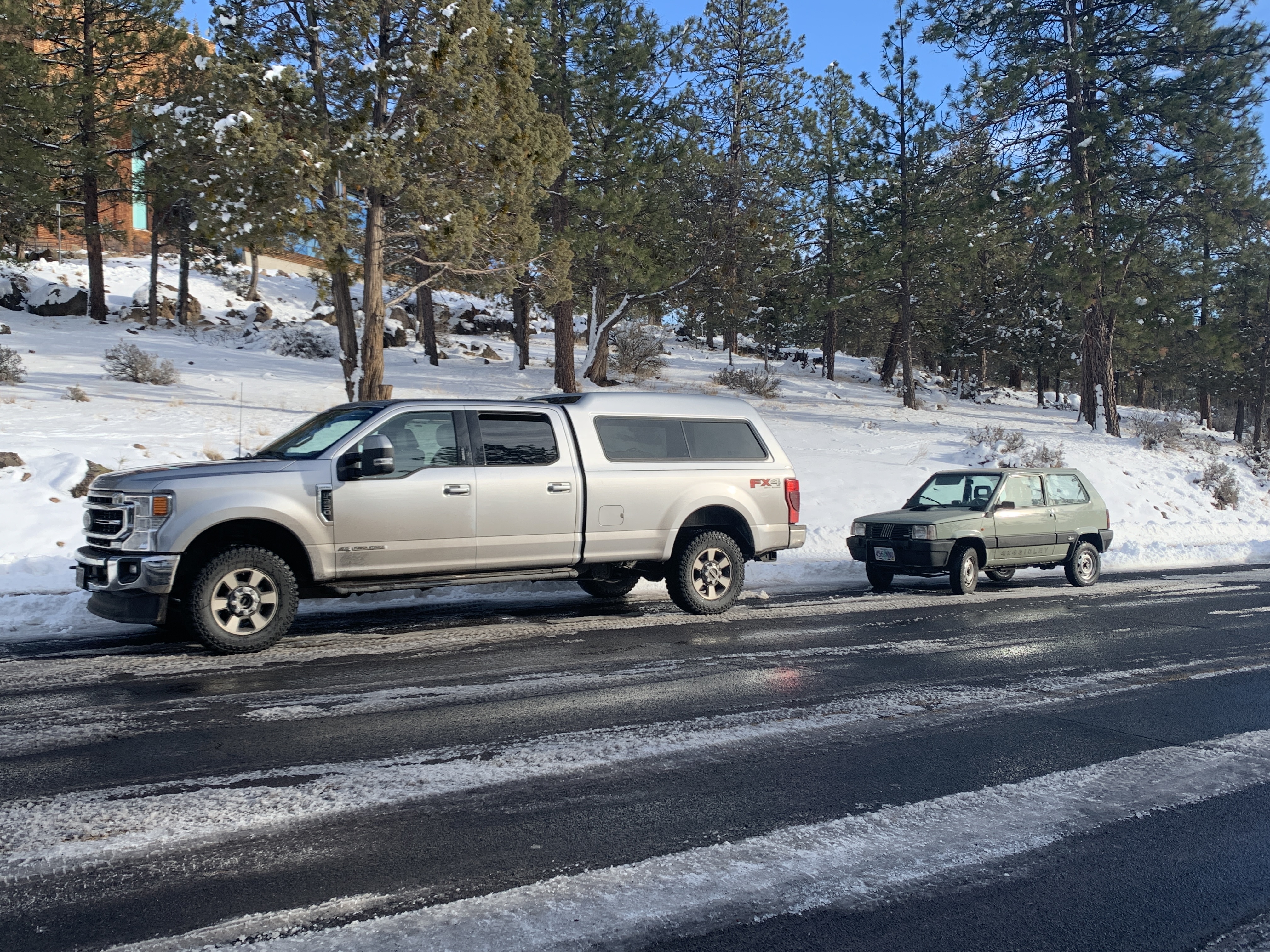

Hi all. I have a restored 1988 Fiat Panda Sisley. I'm going to have to put the car in long term storage - perhaps as long as a year or more. I was thinking of putting the car on some jack stands. Just wondering if anyone has a diagram of the best locations for those stands? Also, anything else I should know about long term storage? The car will likely be outside, but under a roof. I've read a bit about long term storage online generally - sounds like it's recommended to top up the fuel and put in a fuel stabilizer, wrap the wipers with cloth, etc. Anything else, particularly with these older Pandas? Thanks! (Pic for attention - that's our Panda next to a typical 4x4 here in Oregon. Crazy.)
