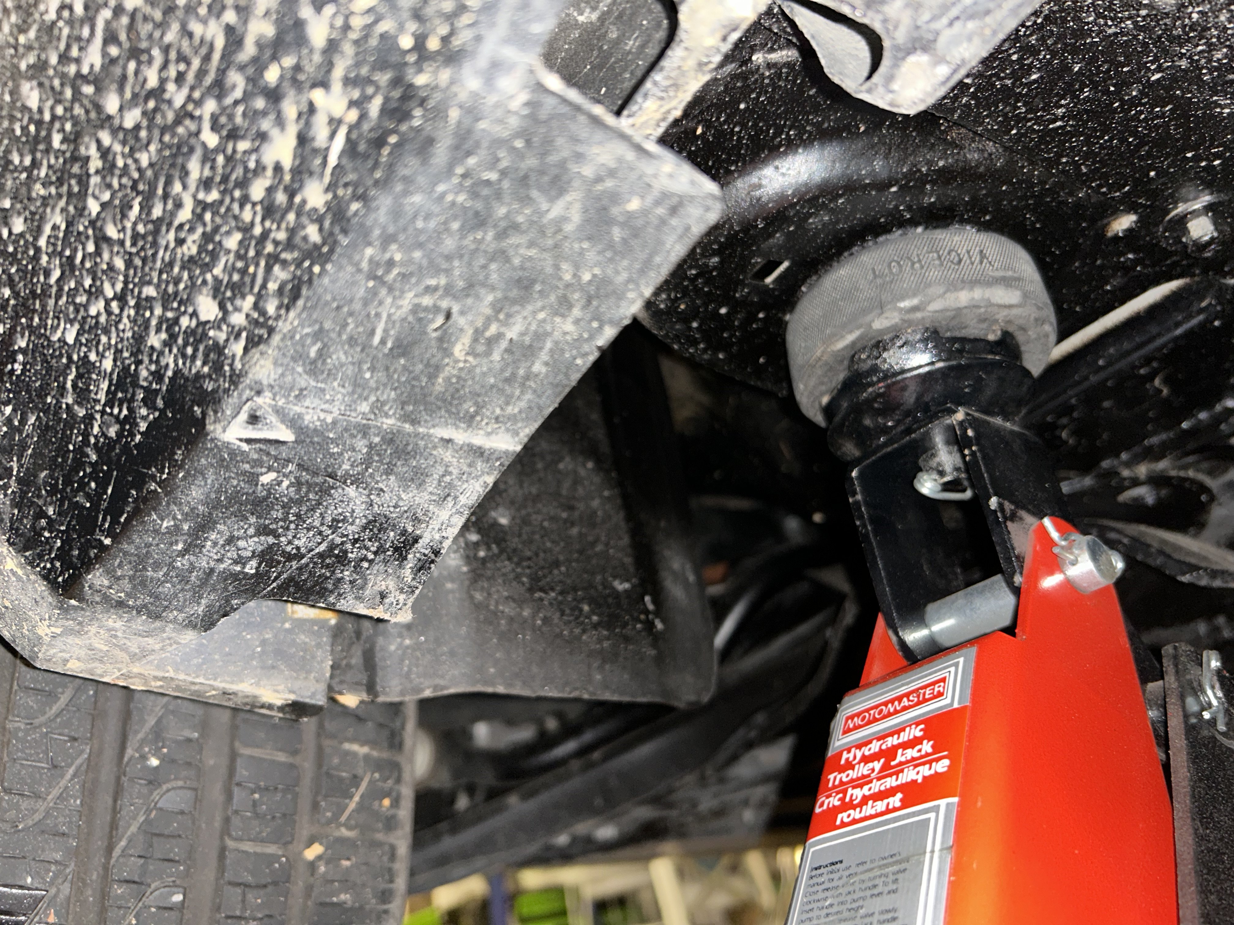

With the help of IgptsxI’s post, I was able to change my tires on my Fiat 500e using the lift points in his picture. While I was doing this, I noticed that the underside of the car’s body does have jacking point indicators (little triangular arrows) pointing to the lifting spots. The first two pictures below show the lift point indicator and lifting point for the rear driver-side tire of the Fiat. The last three pictures show the lift point indicators and lifting points for the front driver-side tire. You can also see the type of trolley jack that I used, which was able to easily access the recessed lift points. In the front tire pictures, I also cushioned the top of the jack with a hockey puck to easily reach the recessed lift points.
