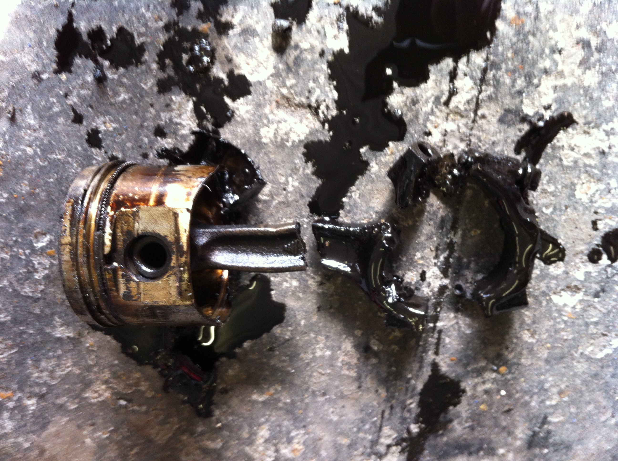

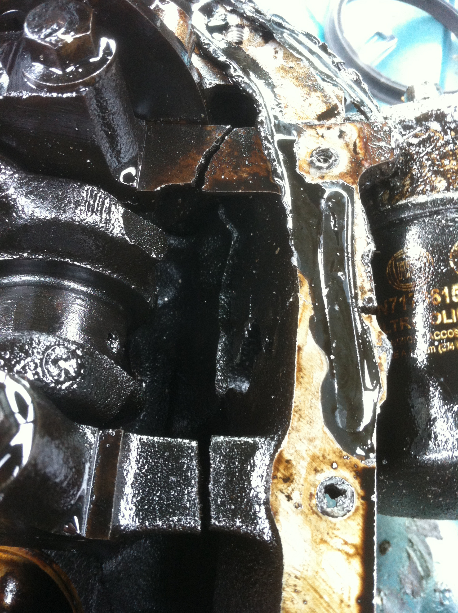

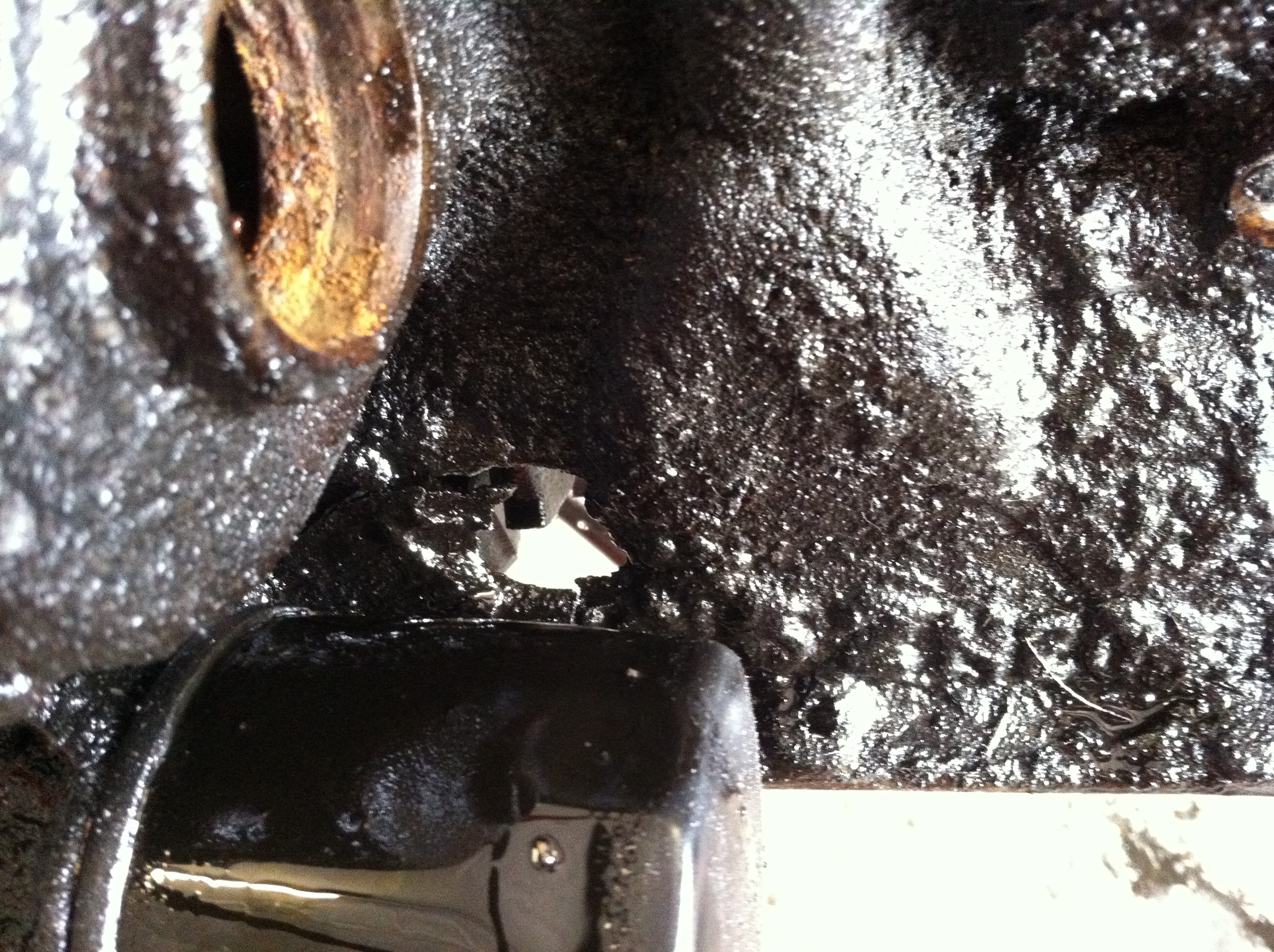

Replaced an engine in a Mk2 4x4 a couple of months ago and thought you all may be interested to see why..........
I have no idea why the conrod failed and punched a hole through the block, at first I thought the owner may have ran the engine dry of oil but there was still some in the sump.
FIRE engines are supposed to be good for 250k + and until this my experience of them certainly supports that claim.
Would you believe this engine still started and ran!!! Not enough power to actually move the car though.
I think that what probably happened was that the big end gave up first, either the bolts snapped or came undone, the engine may have been rebuilt by a previous owner as I can't believe the robots would have done anything wrong. :p. The loose conrod then wedged between the crank and block causing the conrod to snap and the block to - well you can see what happened.
