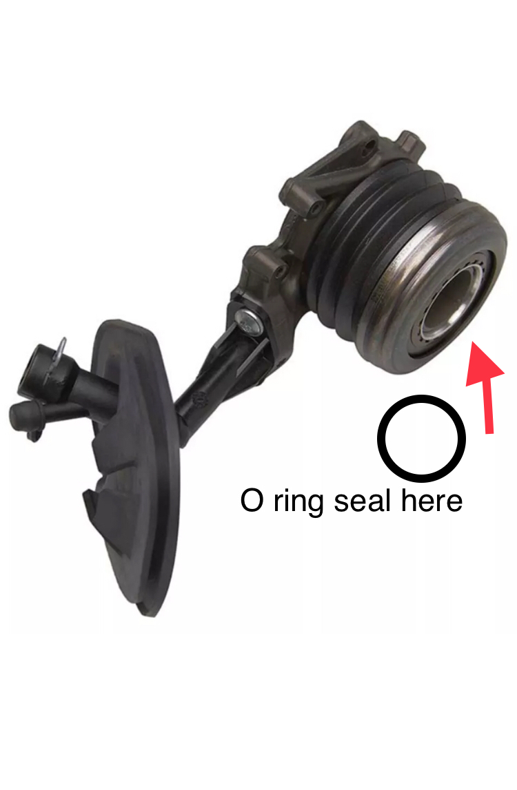

can anyone confirm the o ring rubber seal is needed when replacing the csc, my original one snapped so the mechanic said because of this its leaking.

What oring are you talking about? where does this oring go?
Post some pictures with the CSC and circle the location of the oring.
Yo're not making much sense.
I have attached a pic , the seal was broken so mechanic used silicone paste instead and that’s what’s causing the gear oil leak.

The slave cylinder will not leak gearbox oil.
It can only leak brake fluid.
Behind the CSC there is another seal on the gearbox main shaft.. maibe that is to blame.

Finally found out what was the cause! This is what I needed! the csc lip seal and rubber o ring seal! Contacted Shop4partss by email They found it have know ordered this and a new slave cylinder wil be getting them replaced soon, hope this fixes the leak!
