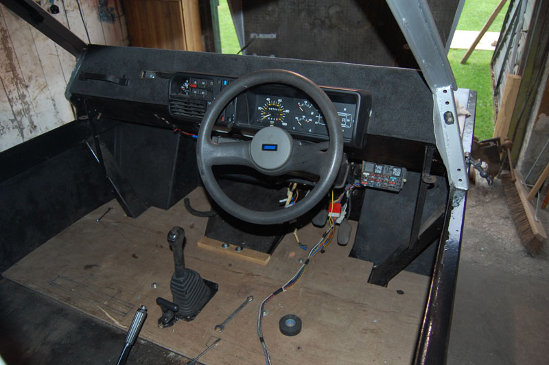

Over the last couple of days I've been working on the wiring, interior and dashboard.
All of the wiring is now connected up and most things seem to work, however, there are some things that are driving me crazy.

As for the interior, I've now trimmed the panel I made for the dashboard with dark grey carpet and fitted it, along with the instrument binnacle and air ducting for the windscreen. I've also fitted the steering column cowl and associated switchgear and steering wheel. The steering wheel is from an old Cinquecento. Just a standard one but I like it much better than the Panda item.
Lastly, the floor is now permanently fitted and sealed and the mounting bar for the lower harness mounts is bolted in. Oh, and I've fitted an aerial in readiness for when I install a head unit.
Only a couple of pictures to show for all the work of the last couple of days and they're both of the dashboard from either side.
